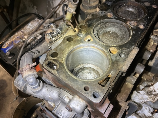

I got tired of cranking and nothing happening, so I tore into it. The bores look real good. The head does, too. A valve job and new rings (and a hone, of course), and I'm thinking I'll run like new. Good news is, I can get a ring set from Summit Racing for under 100 bucks. I think I'm in pretty good shape! Next week I'll drop the pan and pull the pistons, and measure the bores before I order rings.

what has me wondering is the compression is low yet it turns over slowly, maybe it will just be a weak or draging starter motor. make sure that the ring gear is in good shape.
