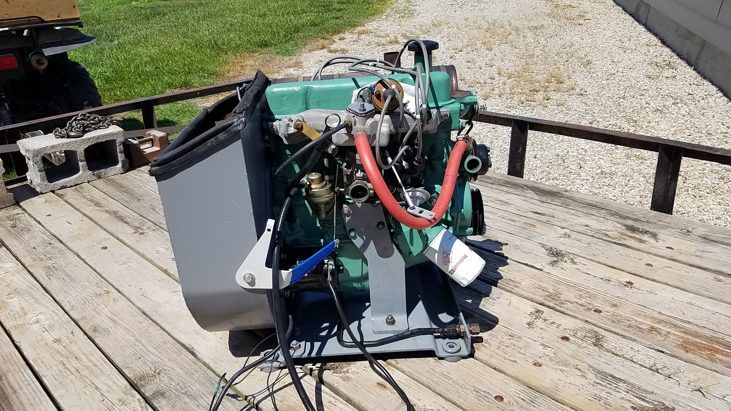

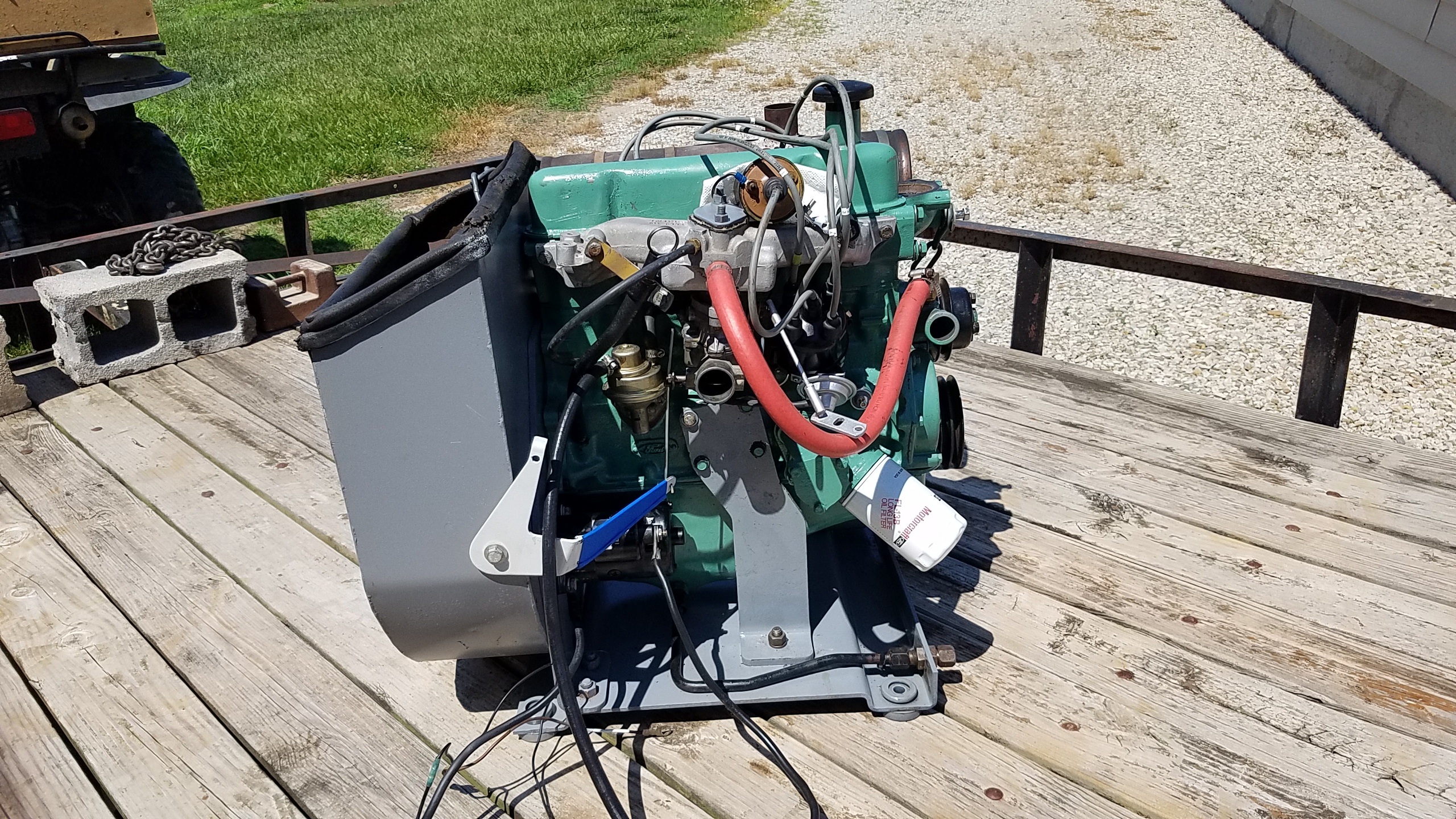

At least I have a runner now. It's not running as smoothly as I had hoped, it has a miss in it. I'm installing it anyway, and going to run it hot and see if it smooths out a little.

Nice start and run.. I struggled with my 632 engine but finally overcame all the gremlins.
That doesn't sound too terrible to me, are you still running points and a condenser? If so that could be the cause of the slight roughness… I switched mine over to a Pertronix solid state ignition and it runs so much smoother. Glad you got it running! Oh and by the way not trying to be difficult but that is a KSG416, the 411 is a 1.1L engine found in the 532…
I'm running points. It smoothed out quite a bit once installed and let run a while. Maybe those rings needed a little time to seat, or maybe it likes being under load. It runs that skiddy just fine - plenty of power. Thanks for the tip on the name! I've made the proper corrections to my little youtube deal.

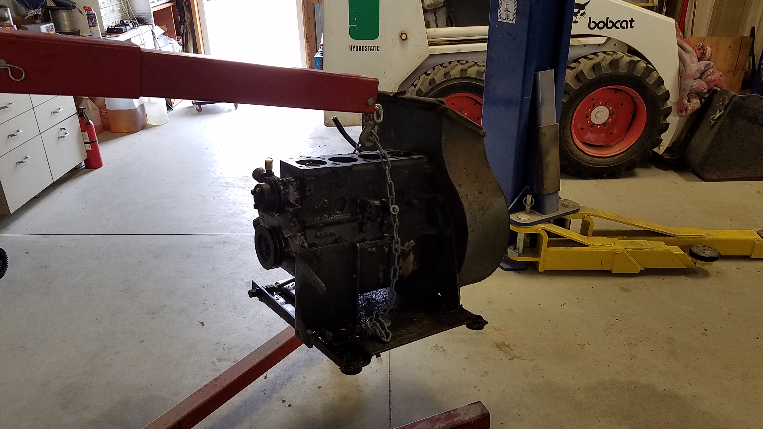

It would no longer run, no compression. I found so much wrong, and worn, I'm surprised it had ran this long. I worked on the engine off and on for a year and it runs nice and smooth now.

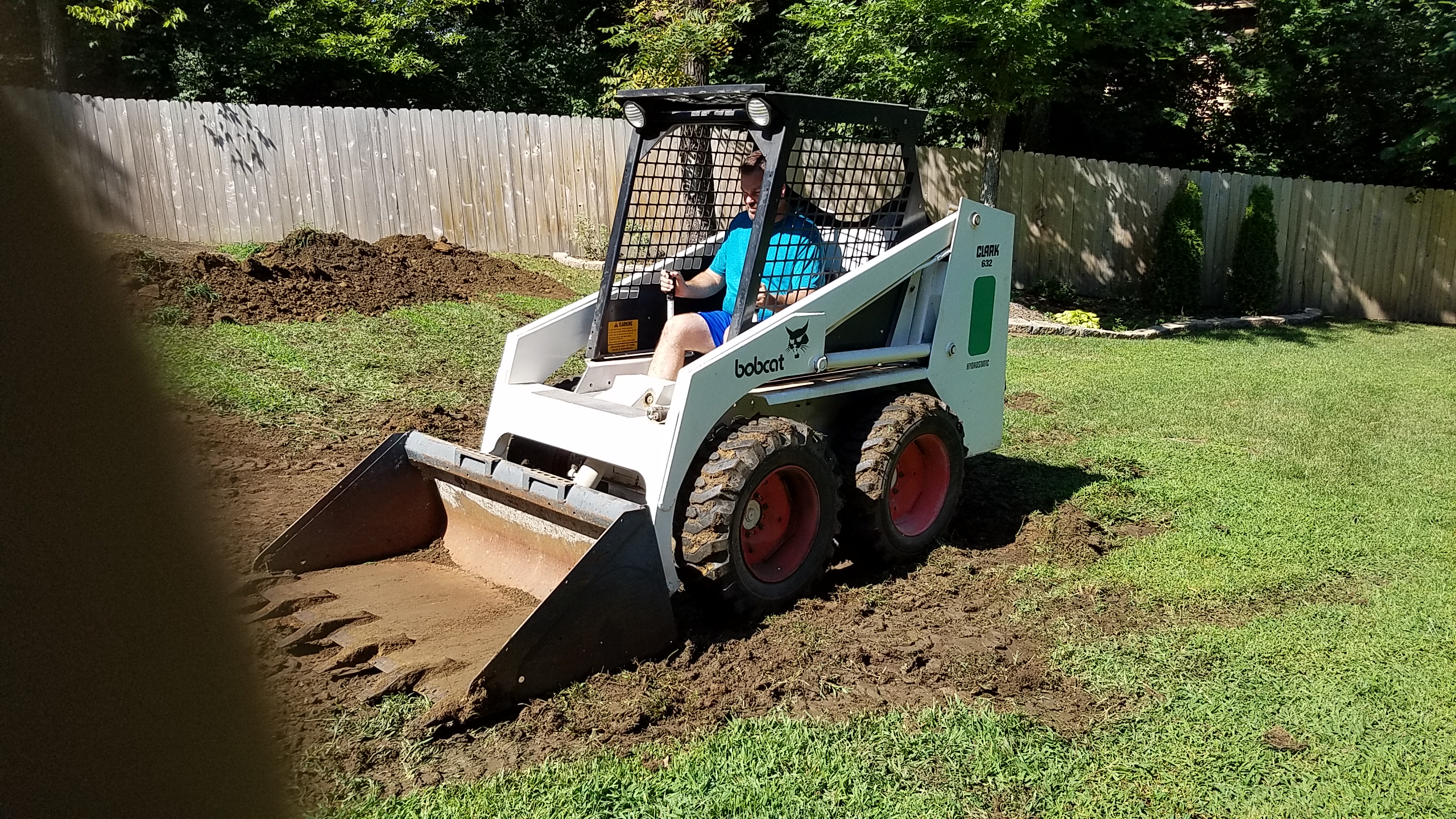

Son started a retaining wall project at his house this week.
Nice work Randy!

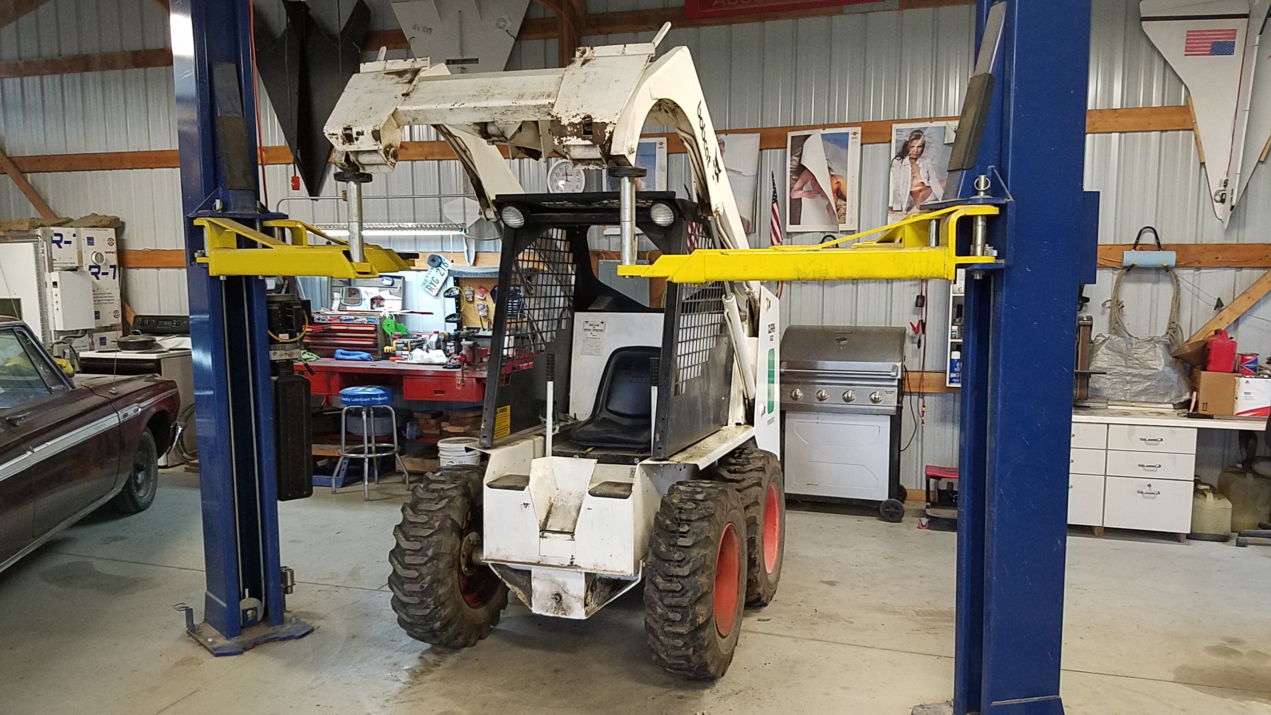

Yes, they are aluminum.. I have already resealed my right cyl. I did that during that time that the engine was out. I did not do the left side right then as the machine was somewhat up against a wall where I had it setting. I had no corrosion on the right side, but it was very tight to break loose.
I started doing the left side yesterday as I got the machine back from my son. I have not got it loose yet, but more ideas today. Must run right now, more on it later today.

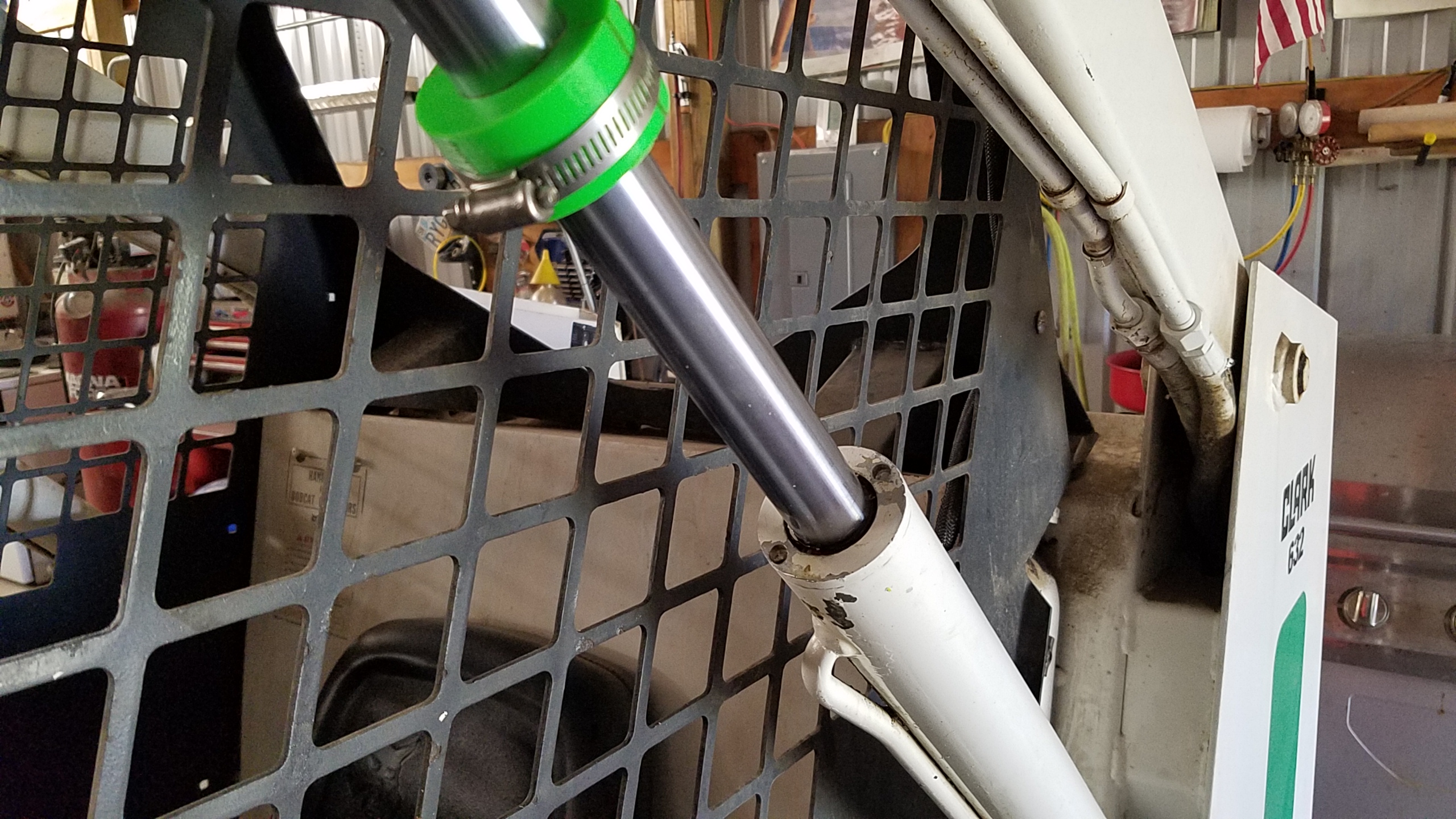

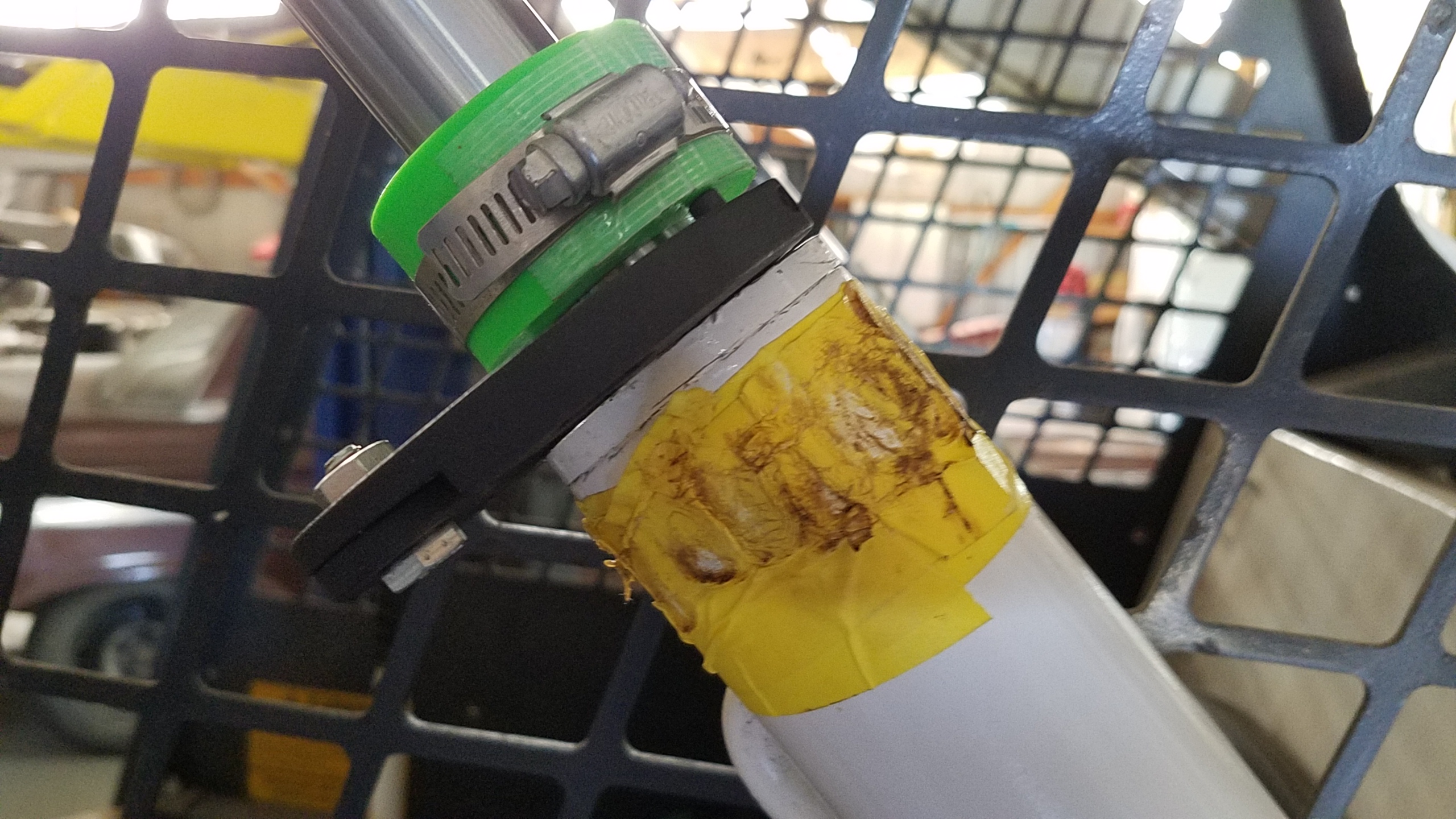

I am working on the cyl while still on machine, to keep it stationary. Not getting the gland nut off with some pretty large equipment, I stopped and 3D printed a sleeve to clamp to the shaft. The idea is to keep a spanner wrench level and engaged as much as I can. A friend stopped by and said he had access to much better wrenches in his shop at work that he can barrow. I am on hold until he is back this week. The bugger is tight.
As a last resort, a large pipe wrench will get it loose. It will however leave teeth marks and looks very unprofessional. But sometimes drastic measures are necessary.
I agree... I'm kind of saving that for the last resort. It has to come off, but not right away. I have time if need be. My pal has a plan of attack. He used to do them at his job as a commercial plant mechanic.

Cool idea about the 3d printed sleeve. I used a big azz pipe wrench on it today and boogered it all to hell. Didn't budge either. I think maybe a fixed pin spanner would be needed to get that nut off. My pin spanner is a pretty big one, and I've used it with lots of other cylinders, but it's adjustable, so there's a little flex in it, and that's probably the problem here. The holes in the nut are now trashed, so really my only option left is to weld some chunks of aluminum on there and either use the pipe wrench on that or slot a piece of steel bar to fit and try that way.
Yes, A fixed pin wrench is what he is after. We measured it to have 1/4 inch pins on 2 inch centers. He says we will put a lot of pressure on the wrench ( cheater pipe )and then use an air chisel ( hammer bit ) to vibrate the wrench in an unwinding direction. I guess that is an often used method they use on their machinery at his work. I do have a heavy duty Snap On air chisel, hope it comes loose. Sorry to hear yours is still stuck.
