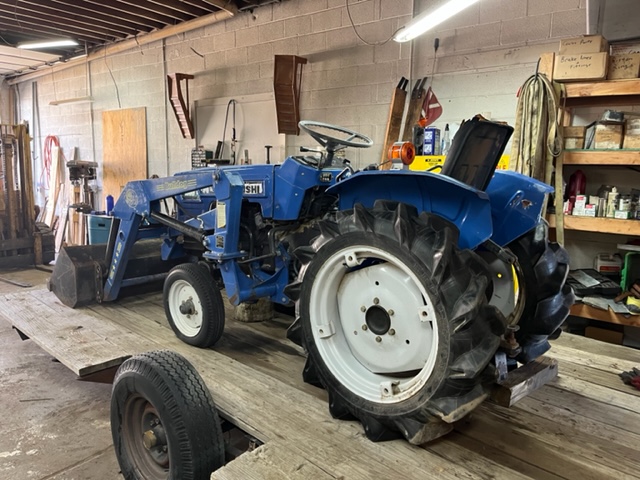

I'm going to second what Wayne said. I bought an Allis Chalmers D15 with a loader to help me with my backyard a year or so ago. Once the job was done, I sold the tractor. I live in the suburbs, so that thing was way too big to keep, but since I had a loader for awhile, I found lots of uses for it. It's like a pickup truck, you don't think you want one until you get one, and you find out you can't live without it. Just today though, I picked up a Mitsubishi mini tractor with a loader on it. 2 cylinder diesel, but the head is cracked. I'm going to either fix or replace the head, and that little guy is going home with me :)
