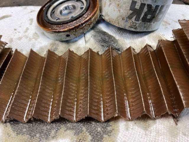

I'm going to try to attach a pic... let me see how it goes.
It worked :) This is my hydraulic filter, I just cut it open. That's the filter housing at the top of the pic, looking like it's original. This is the element opened up. No noticeable metal at all, steel or otherwise.
