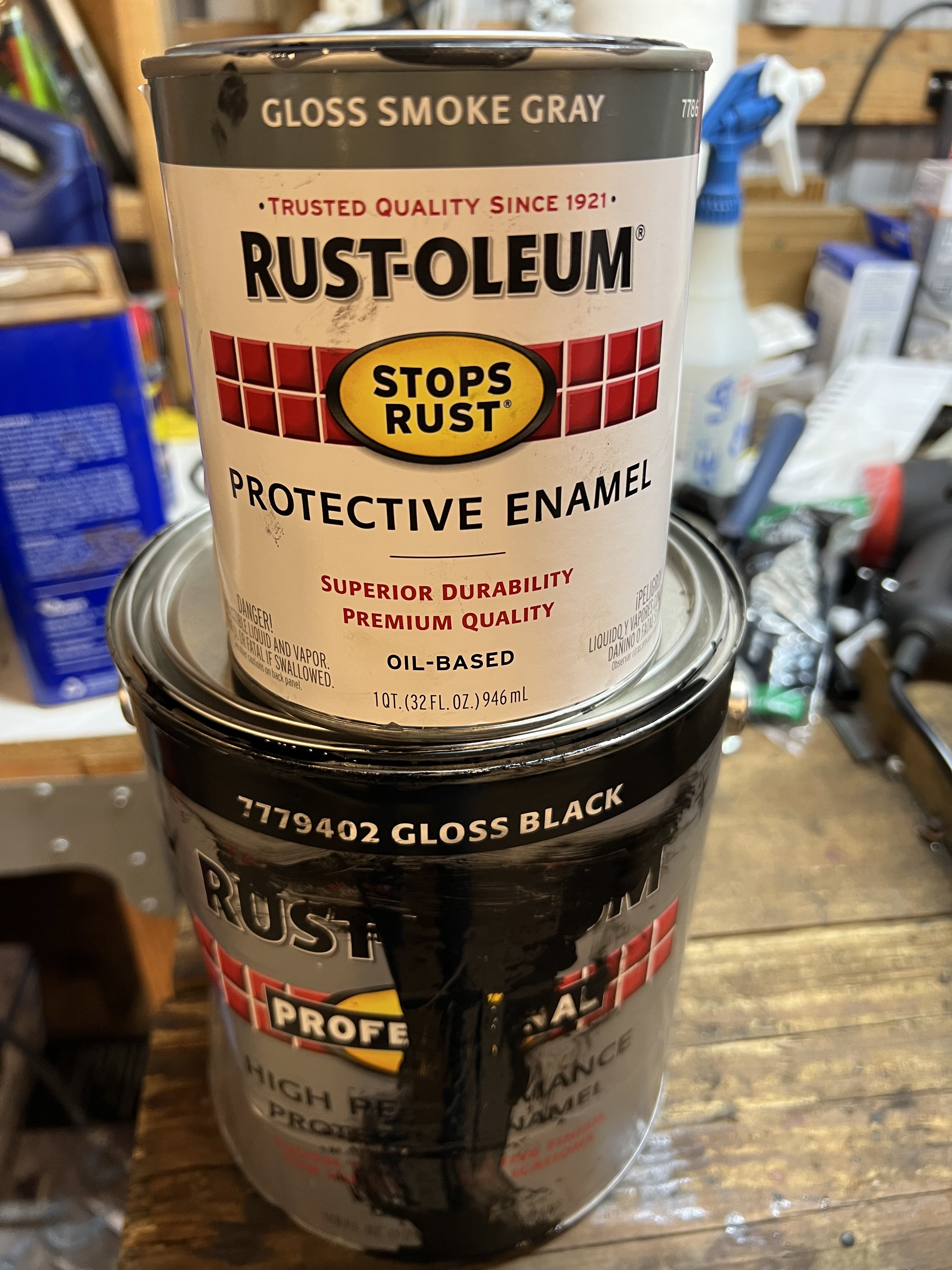

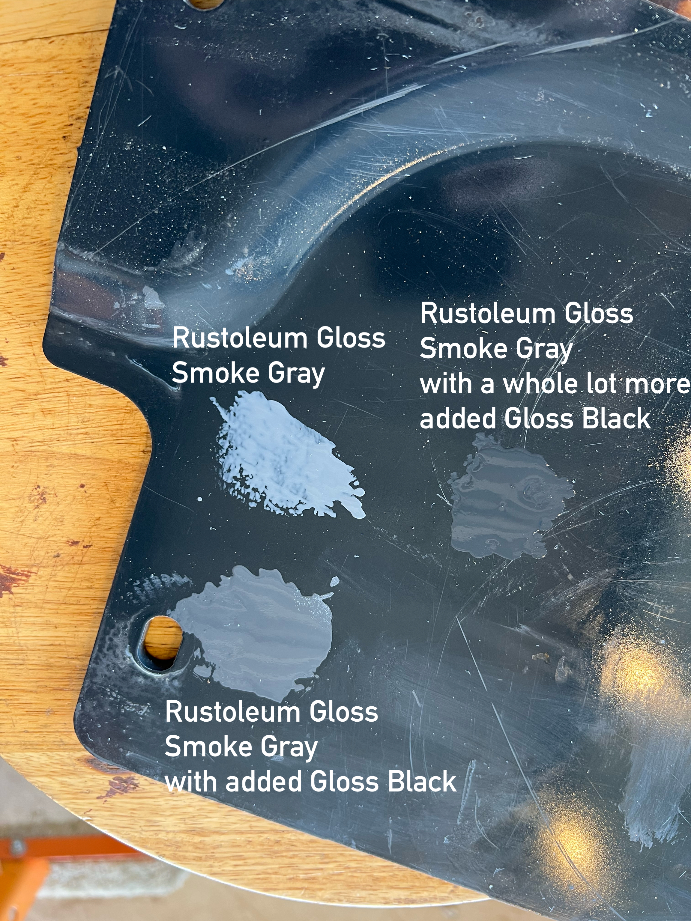

My head was spinning with all the helpful gray color suggestions and no store near me had any of the suggestions/base paints in stock, so I punted. I’m looking for protection, not beauty so I found Rustoleum Smoke Gray at TSC and said to heck with it. Well, at least until I put a sample on a cover plate. Protection? Yes. Anywhere close to Bobcat Gray? Nope. Luckily I had extra Rustoleum gloss black hanging around, so I just started adding black to the gray, while mixing, until it got close. It took about 1/2 quart of black to add to the 2 quarts of gray I had. Make enough to have leftover for touch up’s.
I had to make more gray so this is more of a note to myself to have the formula somewhere accessible and in case someone want to replicate it. I also had to use a different Rustoleum Gloss Black so not sure if that made a difference but it took a whole lot more black this time.The last art class I took was in middle school and I’m going for protection, not perfection, so this is by no means 100% accurate, but it’ll get you in the ballpark.

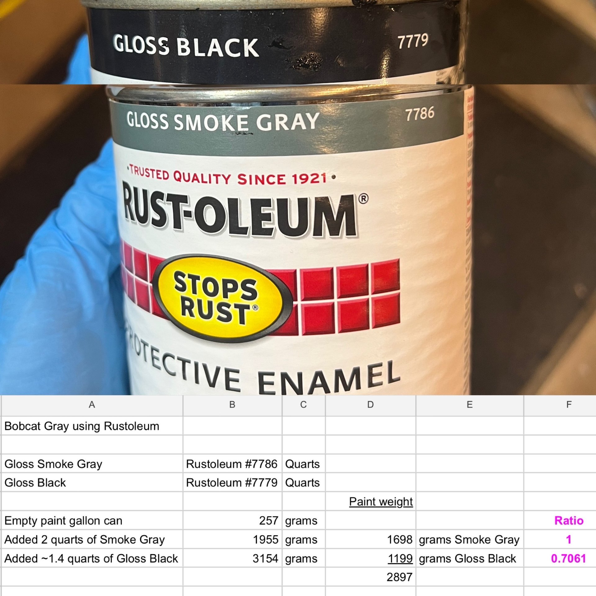

The Smoke Gray to Gloss Black ratio I used is 1 to 0.7061
If you’re using a measuring cup, dump a quart (32 oz) of Smoke Gray in a mixing bucket and add 22.6 oz of Gloss Black.
If you’re using a kitchen scale, see the picture below - there is approximately 849 grams of paint in a quart of Rustoleum oil based enamel.
