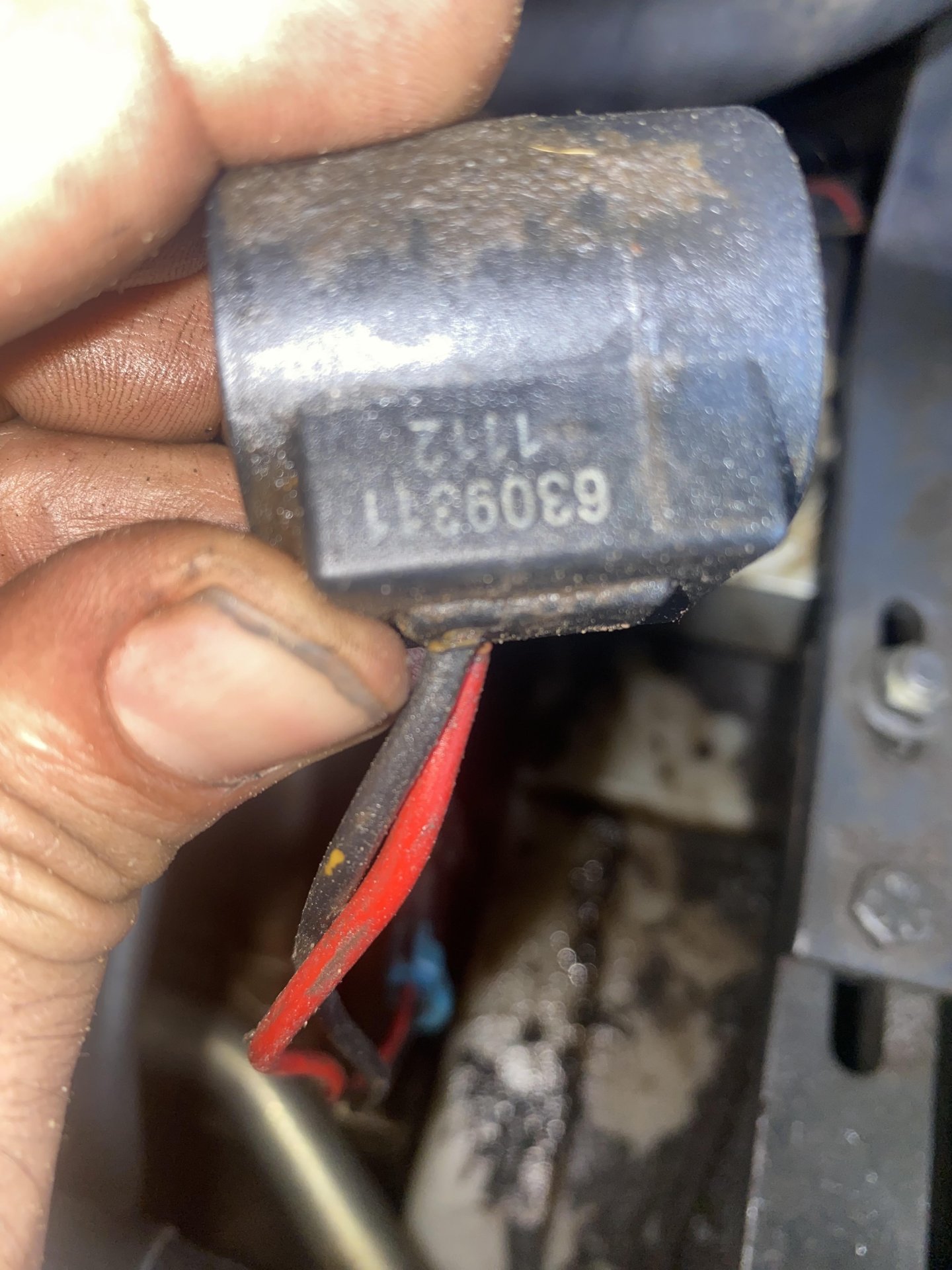

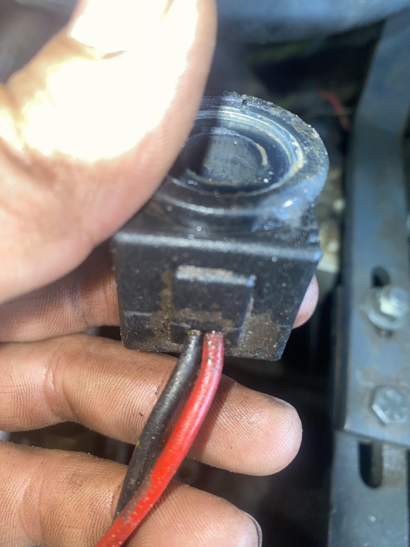

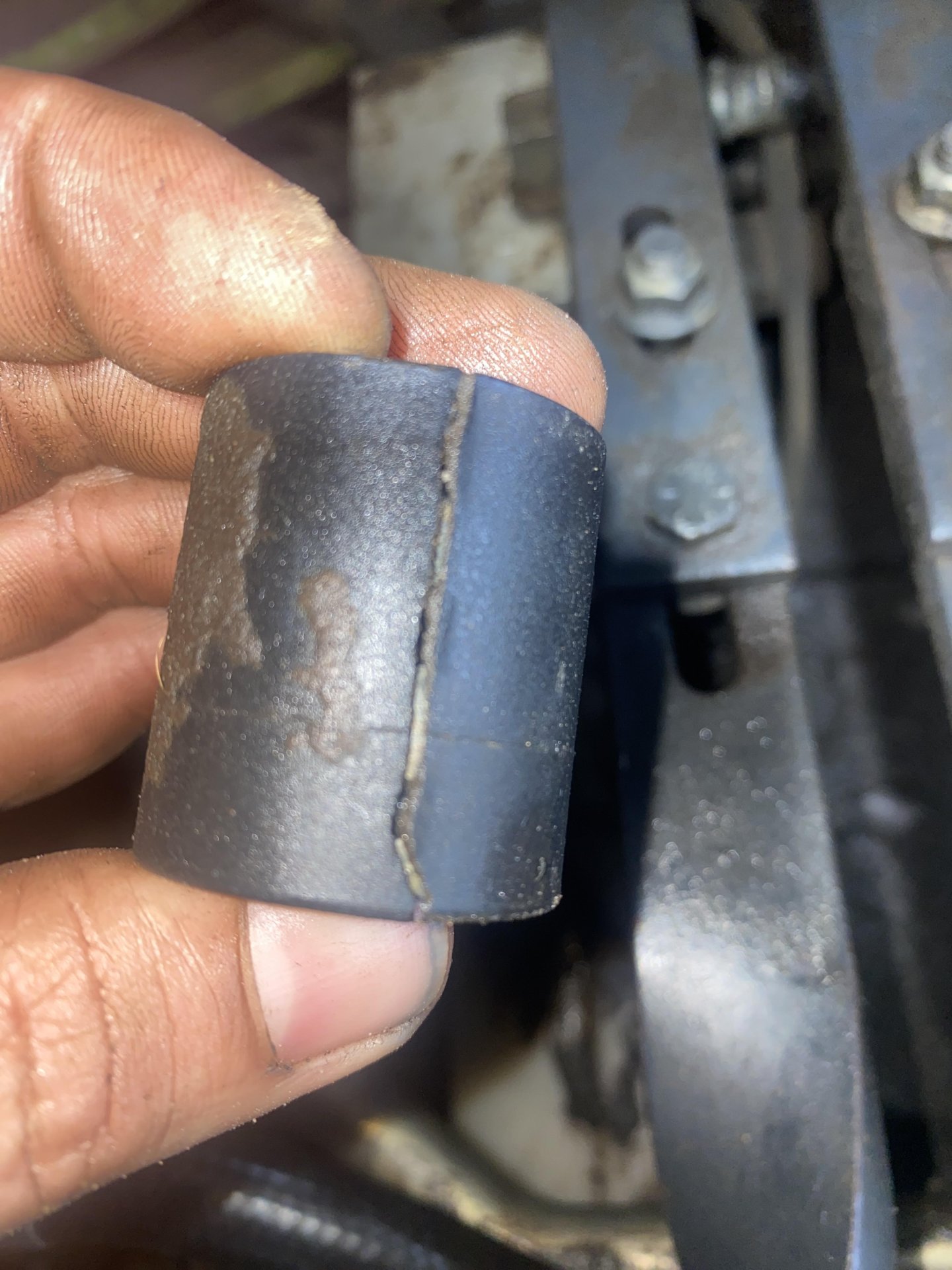

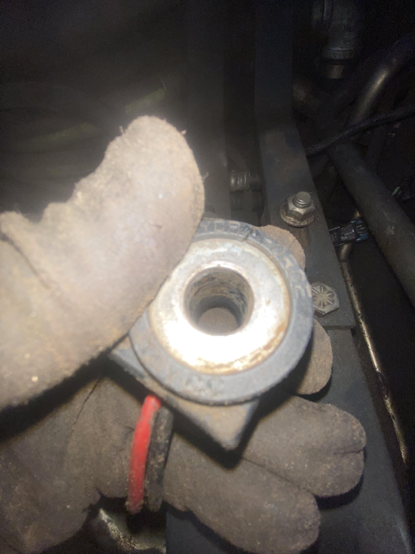

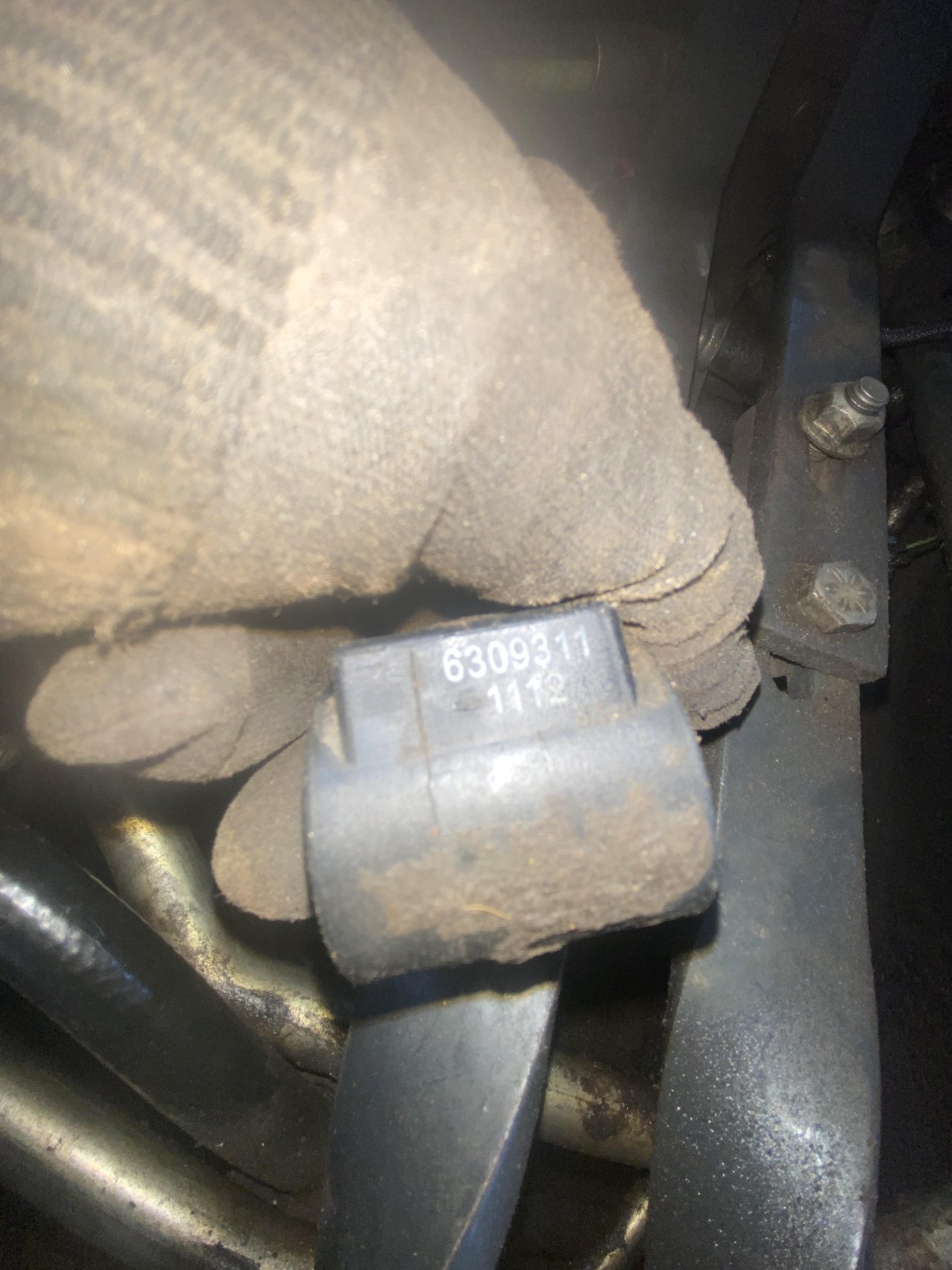

I have been reading and going through what others have done, look at what I found, it could have been the problem
This is the solenoid that controls the BICS for lift and tilt
It looks cracked in half, and the wires under it were barely connected
It could be the solution, tomorrow part should arrive and we will find out

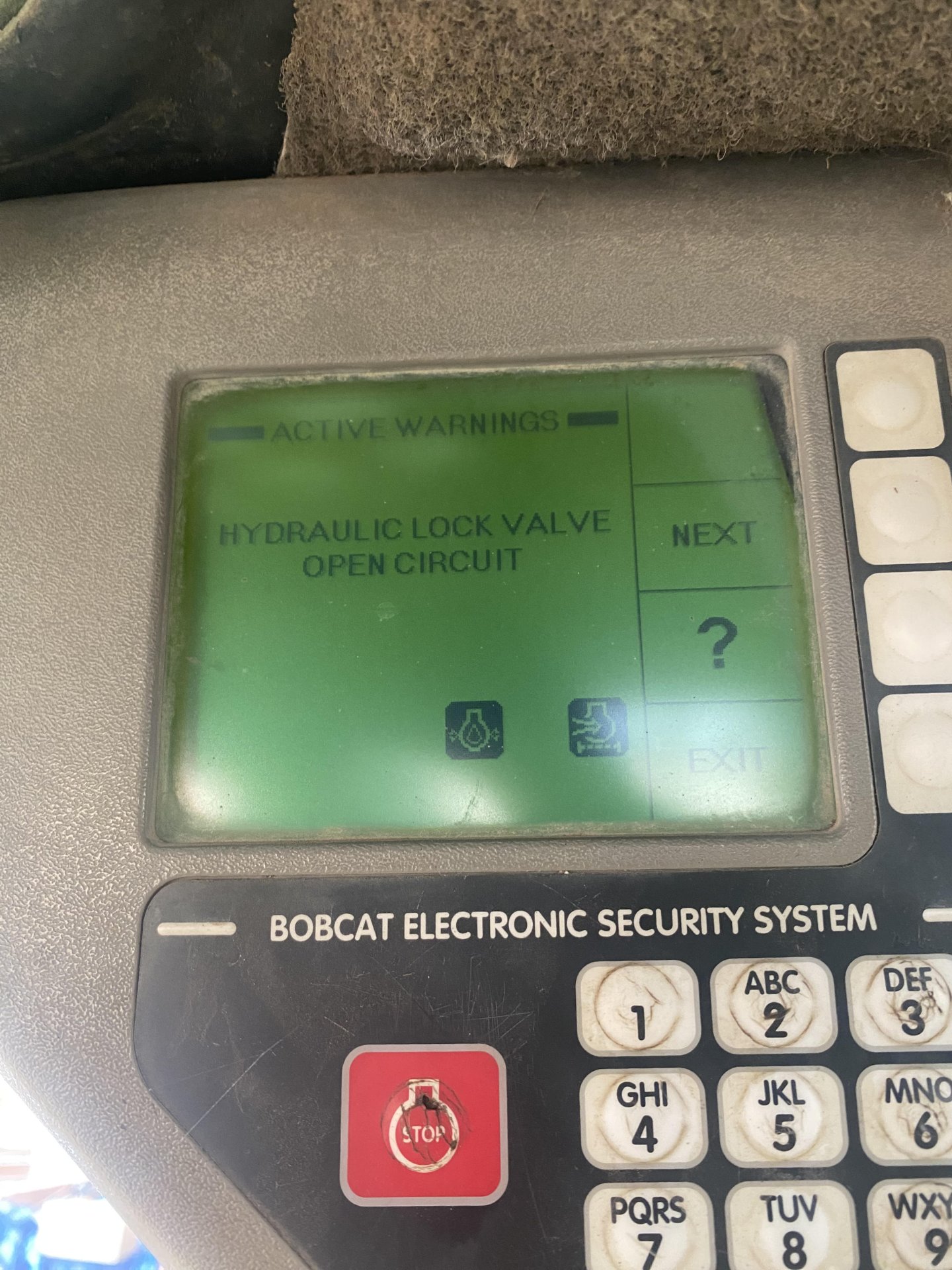

I was wondering how people were getting codes but all I know is to get to the screen that says "hydraulic lock valve open circuit"
I will try, "pressing and holding the lights button"

That solenoid barely had wires connected, and it looked swollen to the point of rupture
It could be the problem, but I'll believe it when I see it

When you press and hold the "Lights" button the codes will come up where the hour meter is. When you let go of the button the codes will come on one after another. There will probably be more than one code, so be ready to write them down.
solved
I installed a new BICS solenoid to replace to swollen one pictured previously
prayed before turning machine on that it would solve it,
turned machine on, problem was solved
