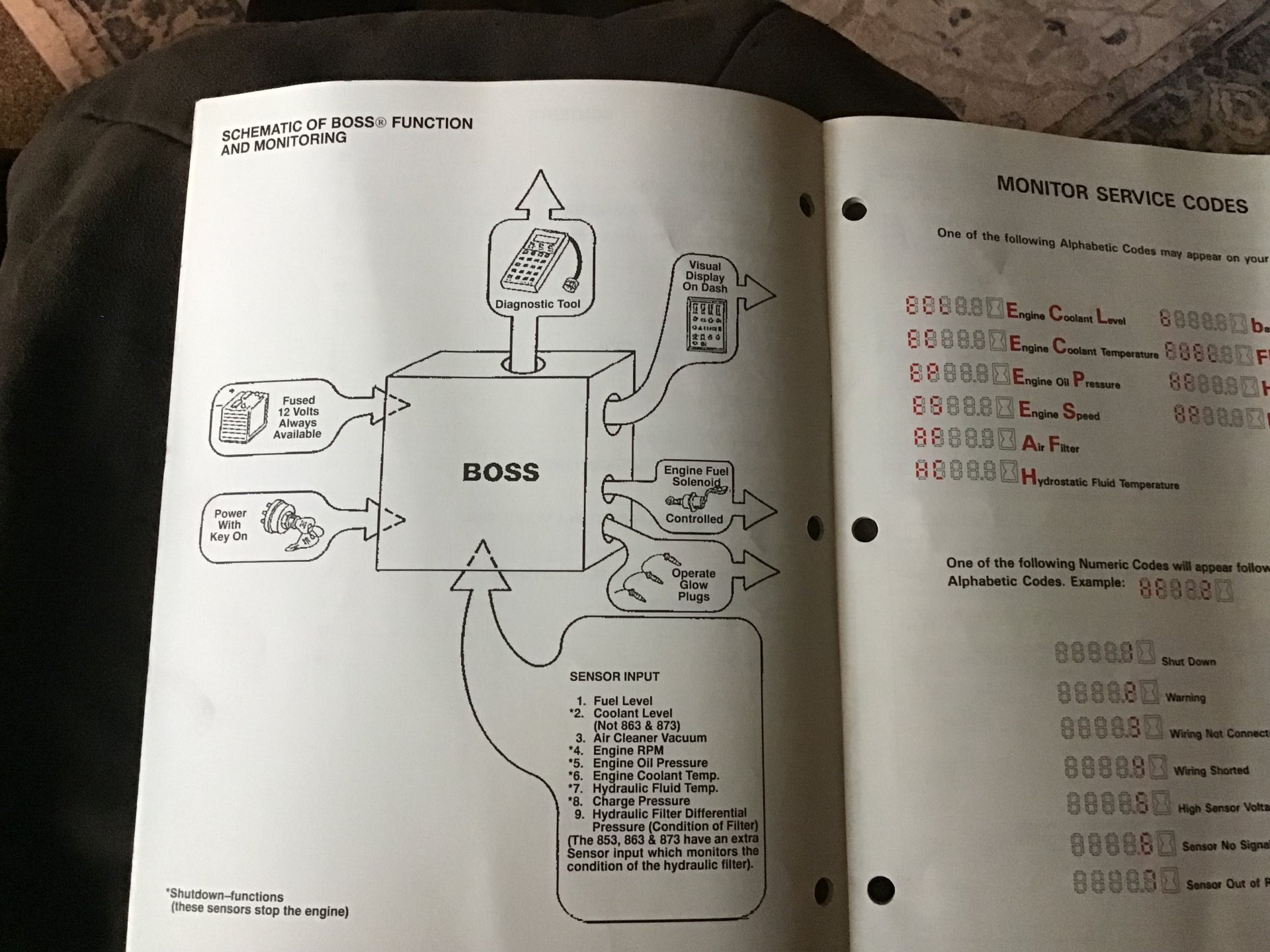

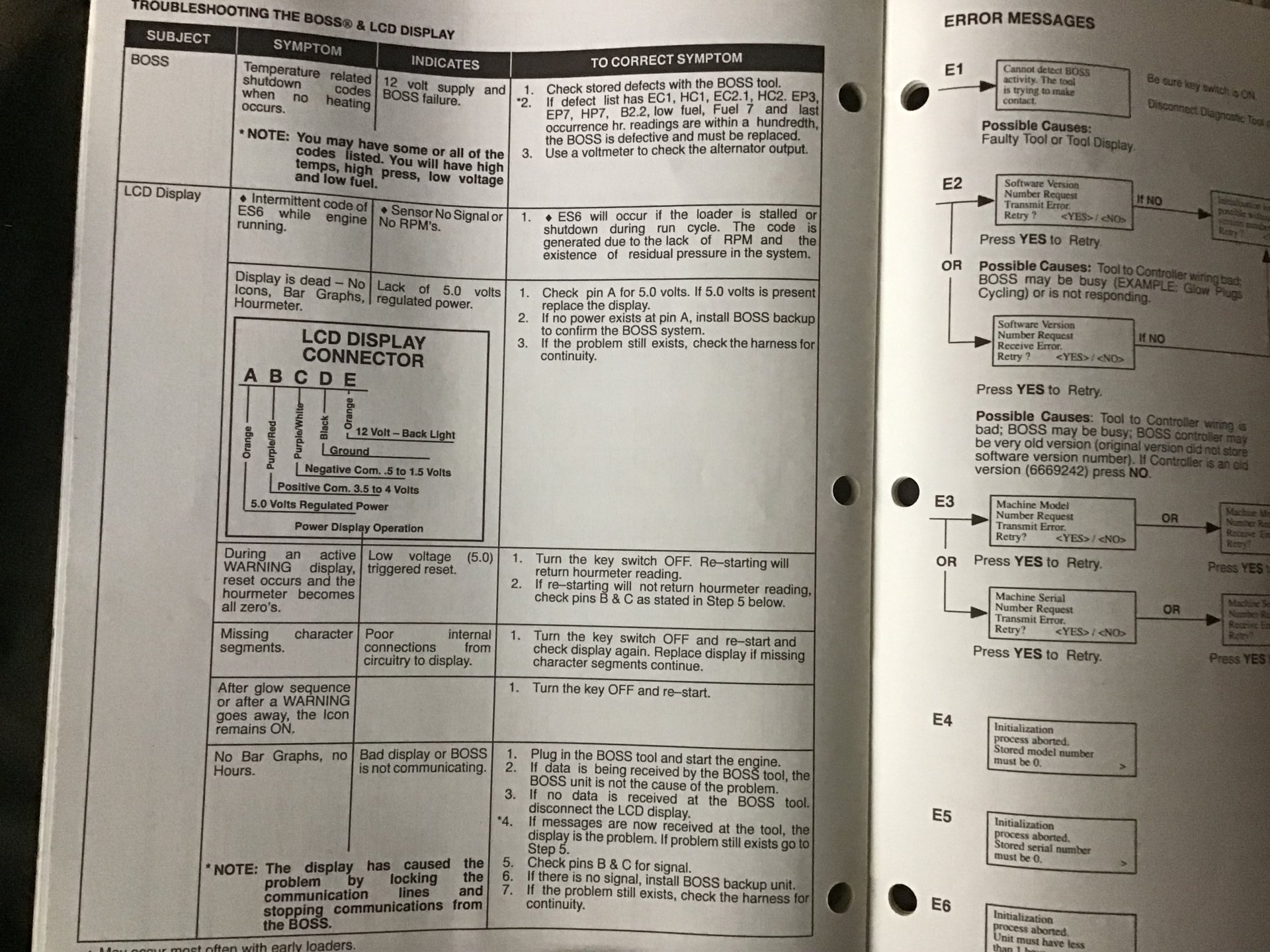

There is one bulb in back of BOSS and it's still available at Bobcat, how do I know? Just changed one.
See pic from BOSS diagnostic manual. And troubleshoot chart attached. Sensors whose signals can shut down machine are coolant level, engine rpm,engine oil pressure,coolant temp, hyd fluid temp, and charge pressure. I'm thinking your machine is trying to save itself , since you mention shutdown occurs in 20-30 sec, which is about right for BOSS shutdown delay.
