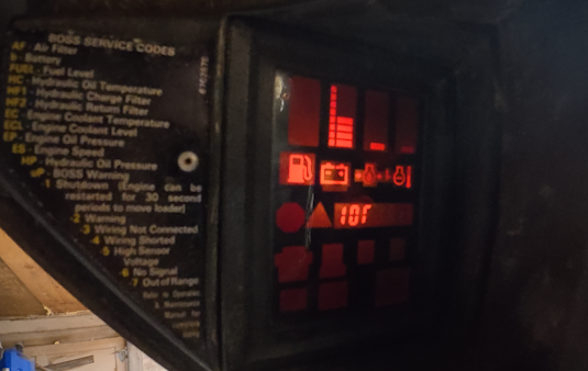

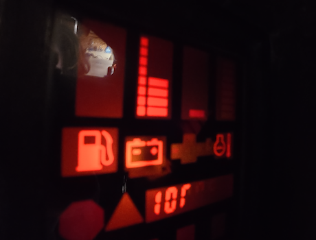

Attached is a picture of what is shown when the machine is running.

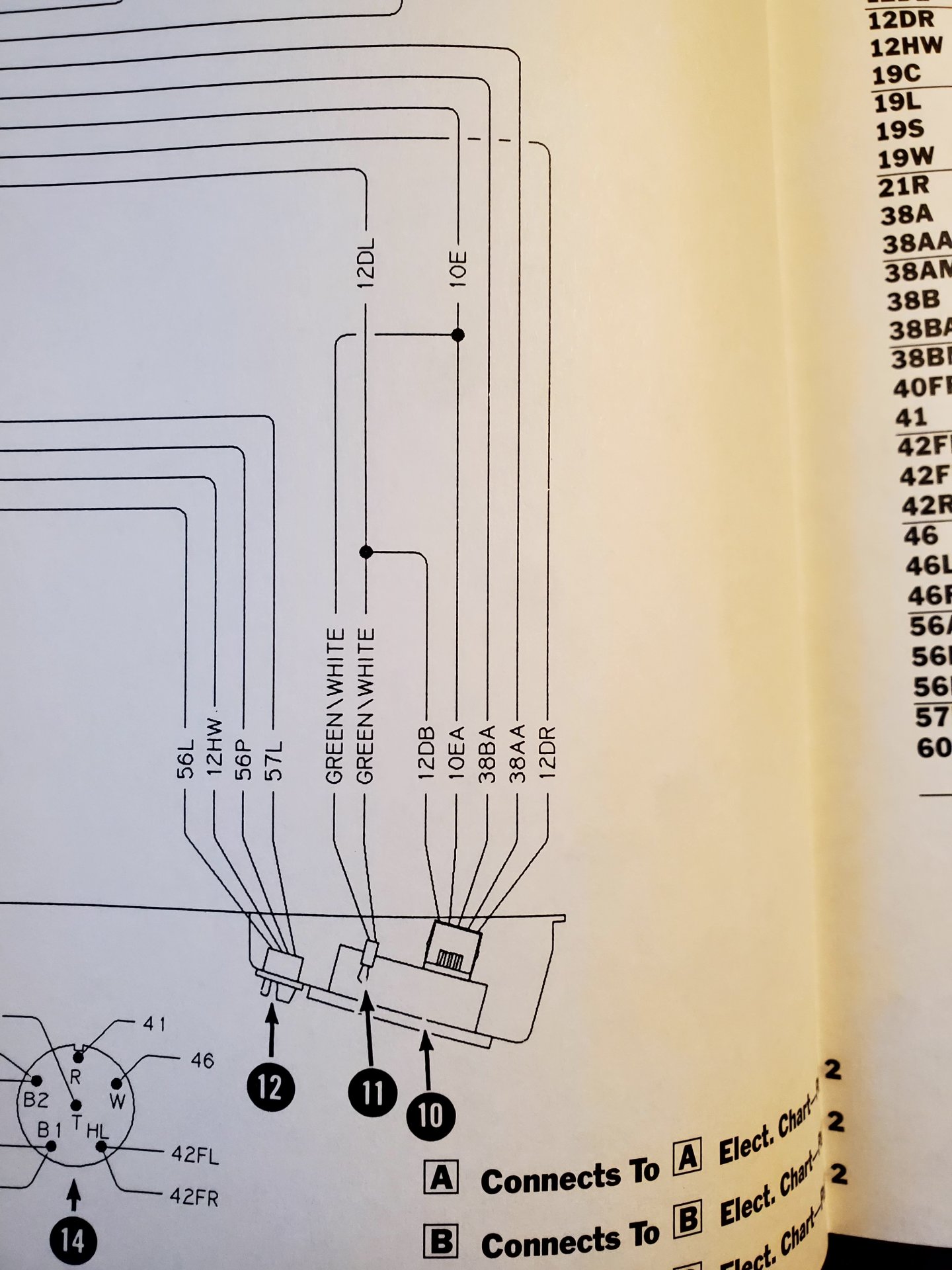

I traced the 2 wires in back of the LCD display numbered with 12xx and they both go to the control operating black box. From there, they cannot be traced to origin. Fuel, oil, engine temp sensors all go to this box. That box is behind the seat under the cab, very close to your welding area.
