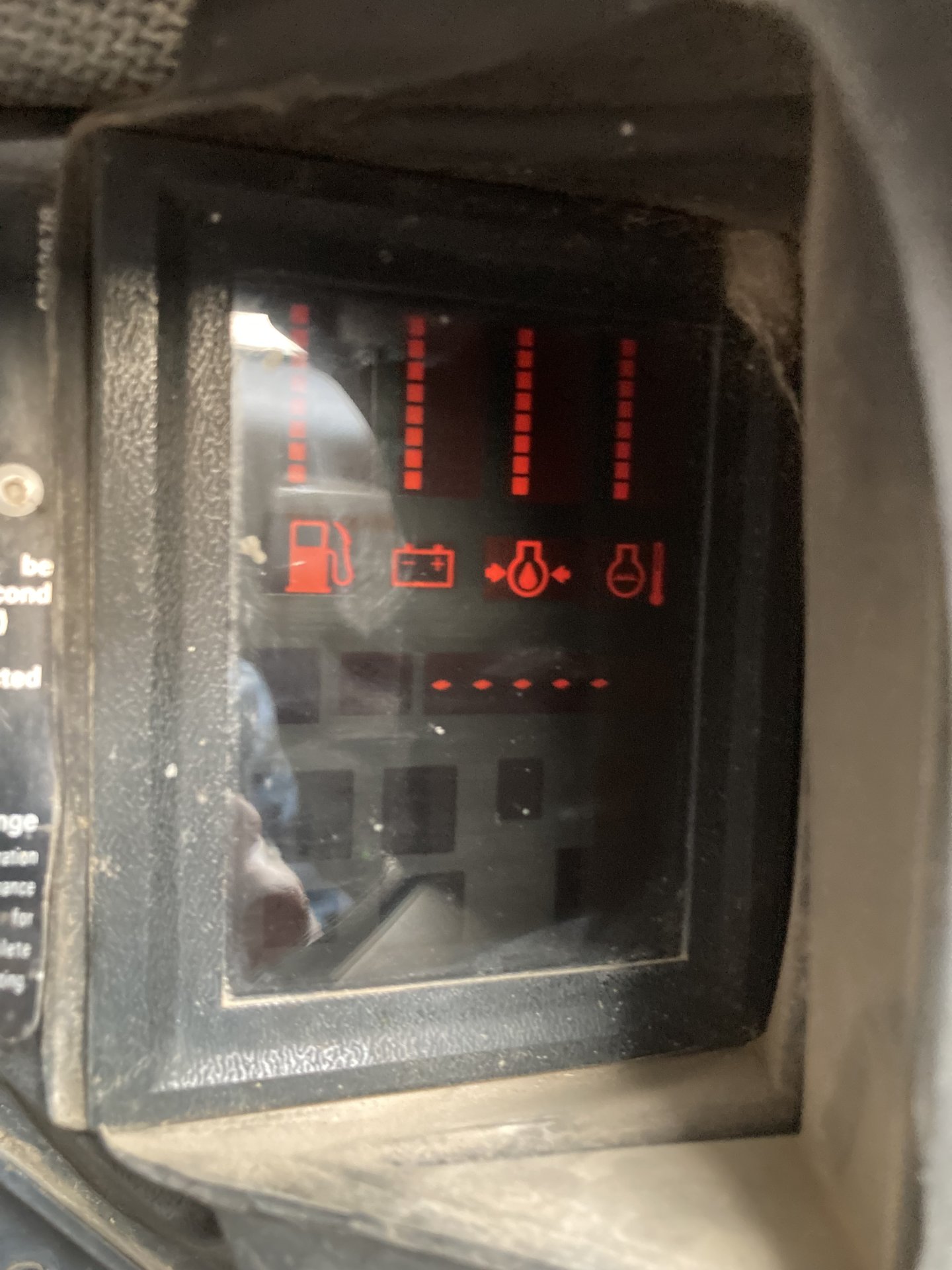

C chrisk1500 Member Joined Apr 16, 2025 Messages 10 Apr 27, 2025 #1 Moving down the list of issues with the skidsteer… My display looks like this: None of the bottom lights ever light up. Gauges are all full bars. Hours read as dashes Where does a guy even start? Will it just need the controller rebuilt? Attachments IMG_5213.jpeg 308.6 KB
fortworth-cowboy Well-known member Joined Apr 12, 2025 Messages 487 Apr 27, 2025 #2 Remove the Display from the machine, turn it around, on the backside should be brackets for bulbs installed. Take the bottom ones out and replace them--Problem solved.
