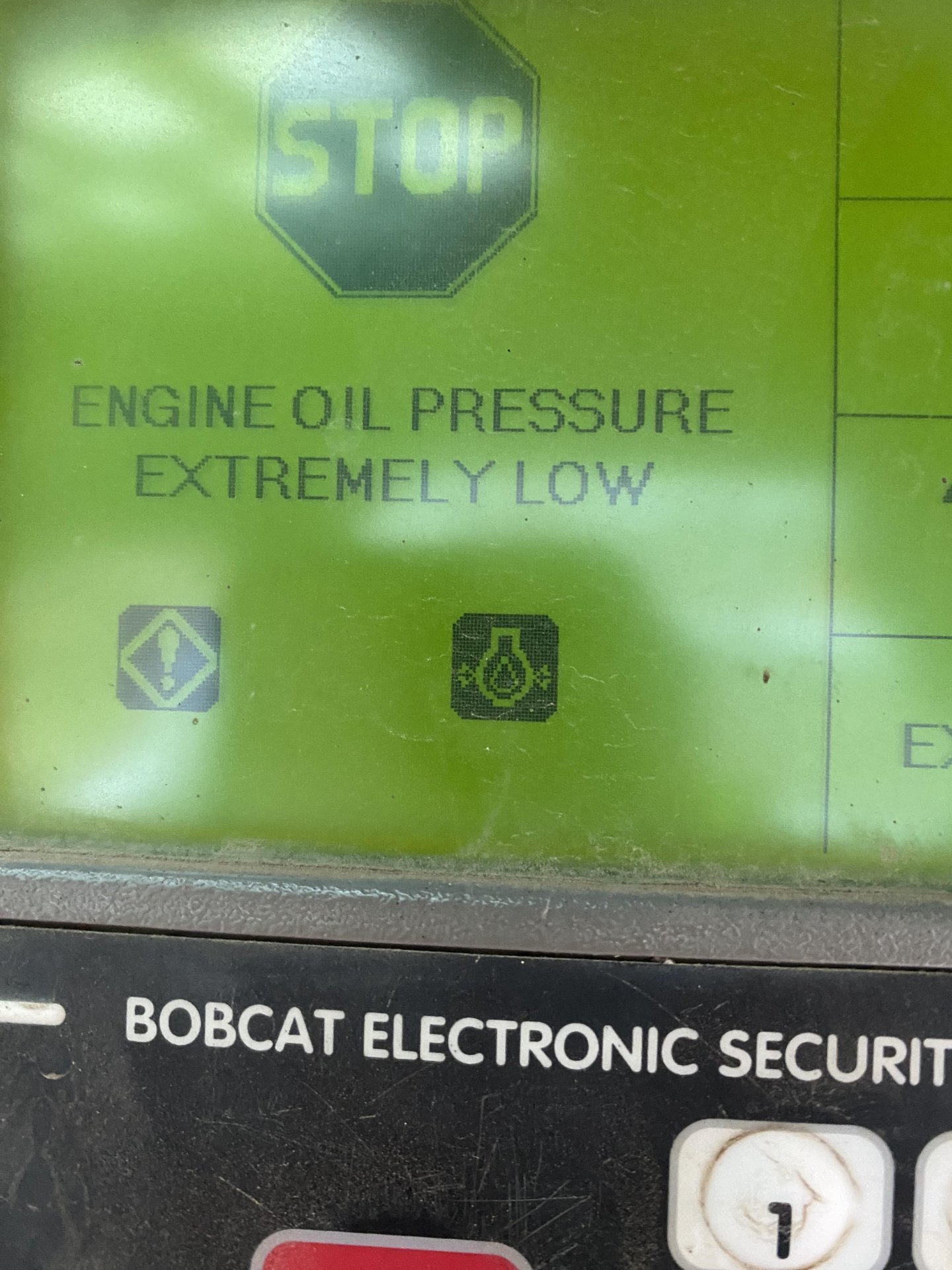

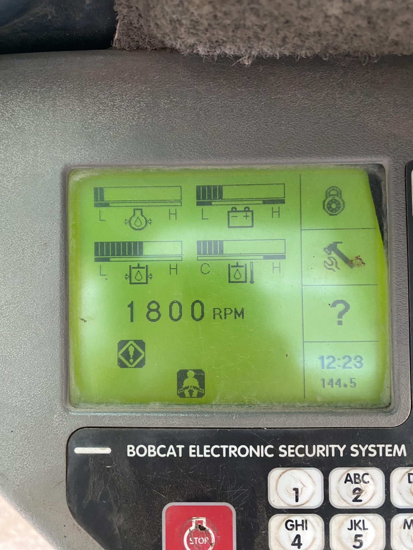

Bobcat T190 keeps shutting down due to low oil pressure
Gauge also reading low oil pressure
Could it be a sensor or is the oil pump bad?
Gauges picture: top left is oil pressure, bottom left is hydraulic system temperature, correct?
warning picture: this warning comes on, then machine shuts off

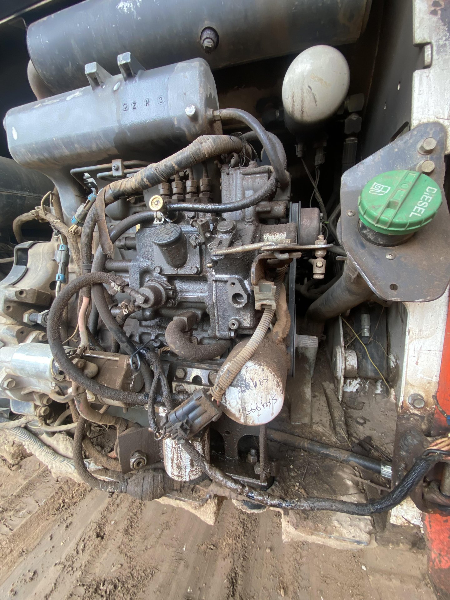

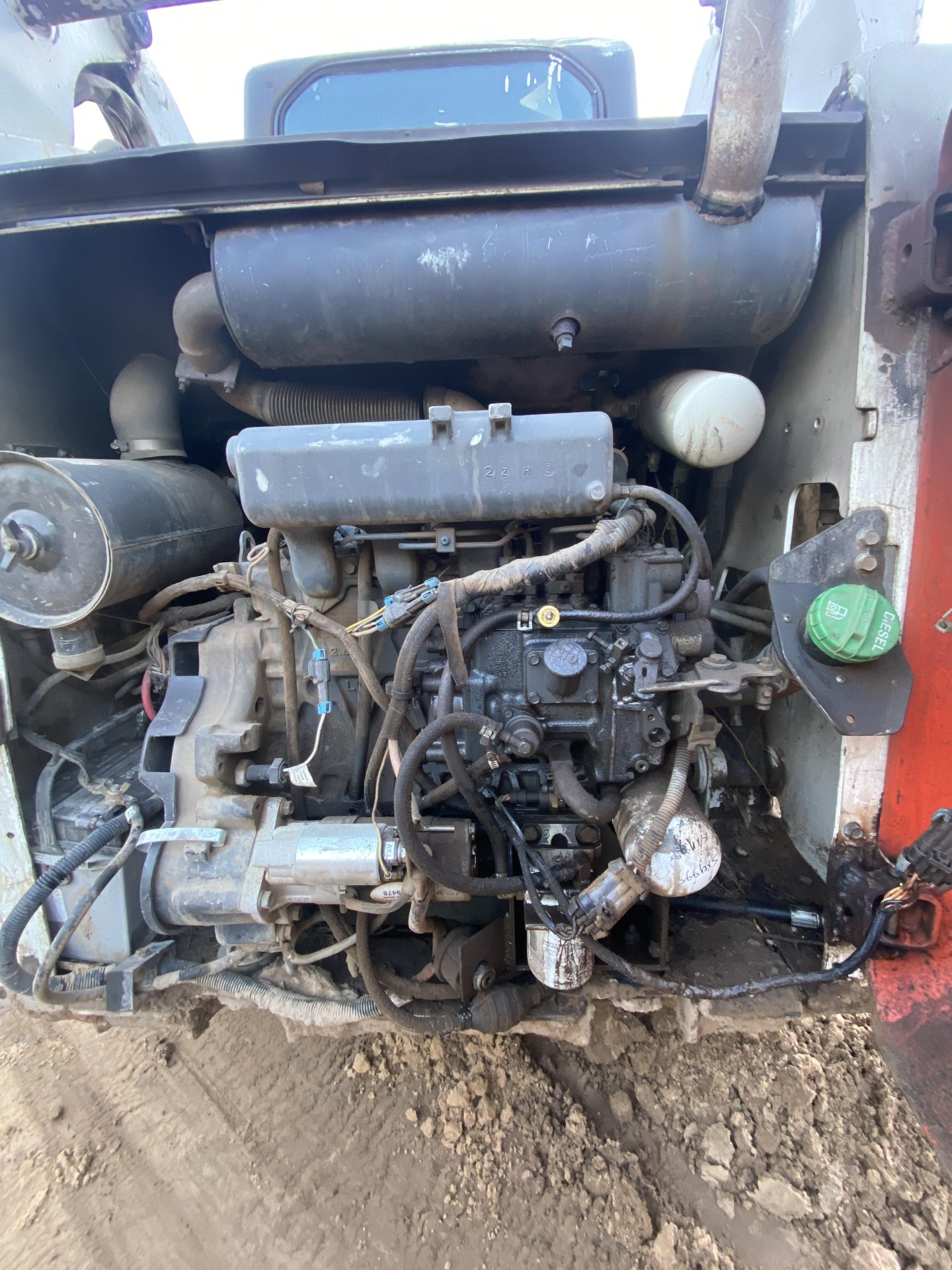

Engine picture: I did add oil and checked it with the dipstick at the bottom, and oil is full, but
I see 2 entrances to put oil, is that right? I added oil to the bottom opening, and I do see another opening higher up, further in, harder to get to, but it is the top of the engine
Let me know if I made a mistake
The machine is not mine, do I keep running it and finish the job, or tell the owner that I wont run the machine in fear of messing up the engine?
Edit: the oil level did go up after putting in the oil in the lower oil cap, it was half on the dipstick, I put in 32 ounces total, it shows full on the dipstick

two places to add oil is not unusal on diesel engines, I guess replacing the oil pressure sending unit would be your best move. If it did not have that computer that want to see oil pressure I would say to add a mechanical gauge to verify what the electronic one is reading or misreading, then if they read different (as the manual one reads normal pressure) then replace current sending unit in the machine having verifyed it is bad. I guess you could use tee and do as described if you have enough room, and have another reference for oil pressure conditions.
I only have the machine until Thursday, is replacing the oil pressure sending unit a big job?

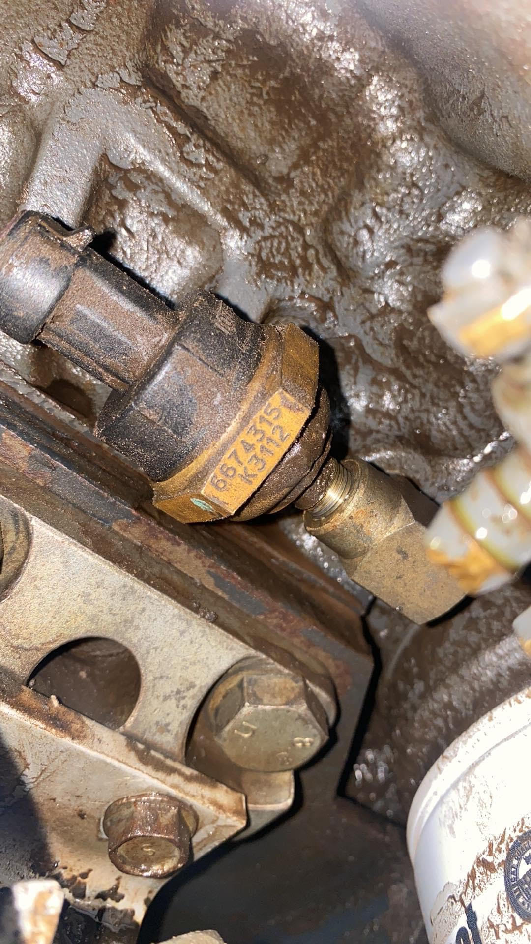

Where is the sensor located that tells oil pressure? The engine is V2403

well if the oil is the wrong weight and real old it might cause some of this problem. but I would think it is bearing wear not external leaks. maybe tell him to go with a straight weight 40 oil. and see how it reacts. good luck
I added oil to the full level using the top hole
When cold: machine will run for 30 minutes before shutting down
When hot: machine will run 30 seconds then shut down
What could be the cause of this problem? I am considering offering the owner:
"I will fix this issue on this machine if you let me use it for a week for free"
Let me know if yall can help me fix it for him. How much work is it to fix this issue? Is it just a oil pump, or is it more complicated?

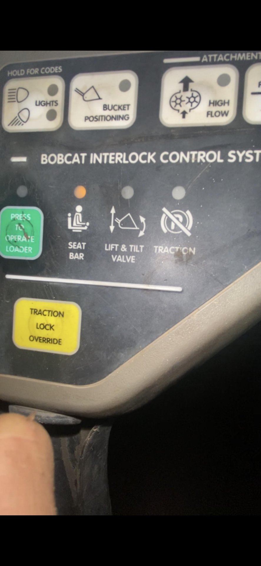

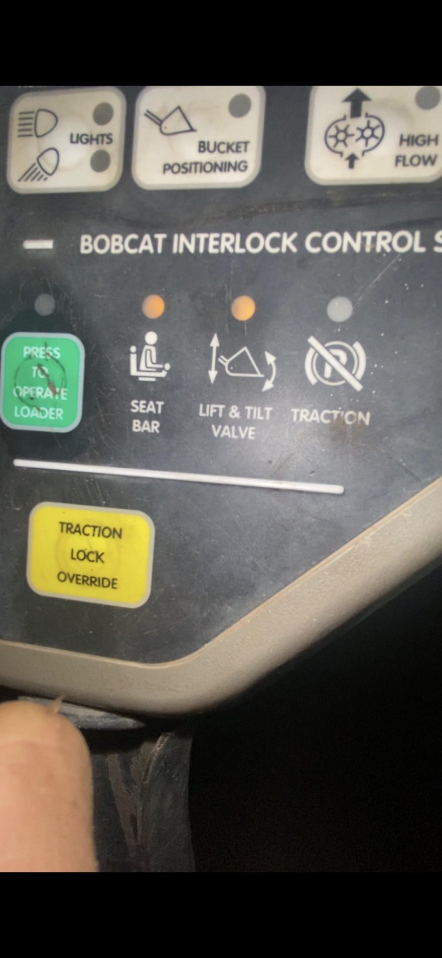

Another issue that I will offer to fix: On the top left side, the "lift/tilt" is flashing, telling me a problem with the system
When machine is cold: that system works fine and you can lift/tilt
When machine hot: that light is flashing and you cant lift/tilt
Ok yes I am listening, you are saying the problem is "bearing wear"
Is this a problem that is fixable or major? My understanding is there is an oil pump that can be replaced and would fix the issue, but maybe I am incorrect
A temporary fix you are suggesting: Use straight 40 oil, which would be thicker, and would create more pressure on the weak system
Yes, I will suggest that to him
I will not do it to this machine because it not mine but:
Theoretically if I put gear oil, it would thicken oil and maybe help in this type of situation? I am asking to learn for future situations like this

First thing to check: make sure that the proper oil sensor was installed, it is very similar to hydraulic oil sensor but will cause this problem

I cleaned the area on the machine, inspected the wires going to the oil pressure sensor
the tasks in order of importance I would do if i was going to fix it:
1. get a good oil pressure sensor, 2. Get a manual gauge to check oil pressure, 3. change oil pump

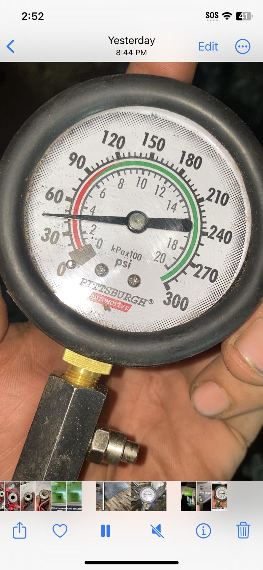

Update on the T190 turbo:
Took off oil pressure sensor, connected manual gauge
Pressure reading when cold: 45 psi
Pressure reading when hot: 32 psi
Pressure is fine, maybe sensor or wiring is faulty
Now another problem:
The two pictures showing the flashing lift tilt shows a fault, some kind of ground code that stops the bucket from moving
Machine when cold: lift/tilt will work for 25 minutes, then locks up
Never works when hot
Someone know how this system works and if I can bypass it, it would be appreciated
all these problems might be related to one wiring harness location issue. but as a opinion those oil pressure numbers are ok but not great. but the engine will not sieze with them., just as a idea disconnect the oil pressure sending unit and see what the skid steer gauge reads should be zero if it reads anything that will tell you of a electrical fault.
You think the lift/tilt is wiring harness issue? Where is the location of this issue, near the engine or under the cab? How can I test this? Or better yet, how can I unplug the sensor and let the machine be able to lift / tilt?
I was reading pressure should be 48 psi, the machine will do 45 when cold, then will drop to around 32 psi when fully hot. Those numbers should be fine from what that guy said in the video who was having the same problem.
The one thing that would help me: how can I disengage the lift/tilt locking system so that it does not lock up?
The main thing that eases my mind is that there is fresh new oil going to the top of that engine, with sufficient pressure
Please explain that lift/tilt system, how does it work? What is the point of it? Why is there separate locking systems for the tracks/bucket? Where is the location of this issue?

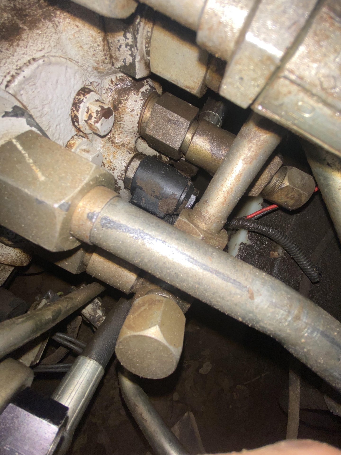

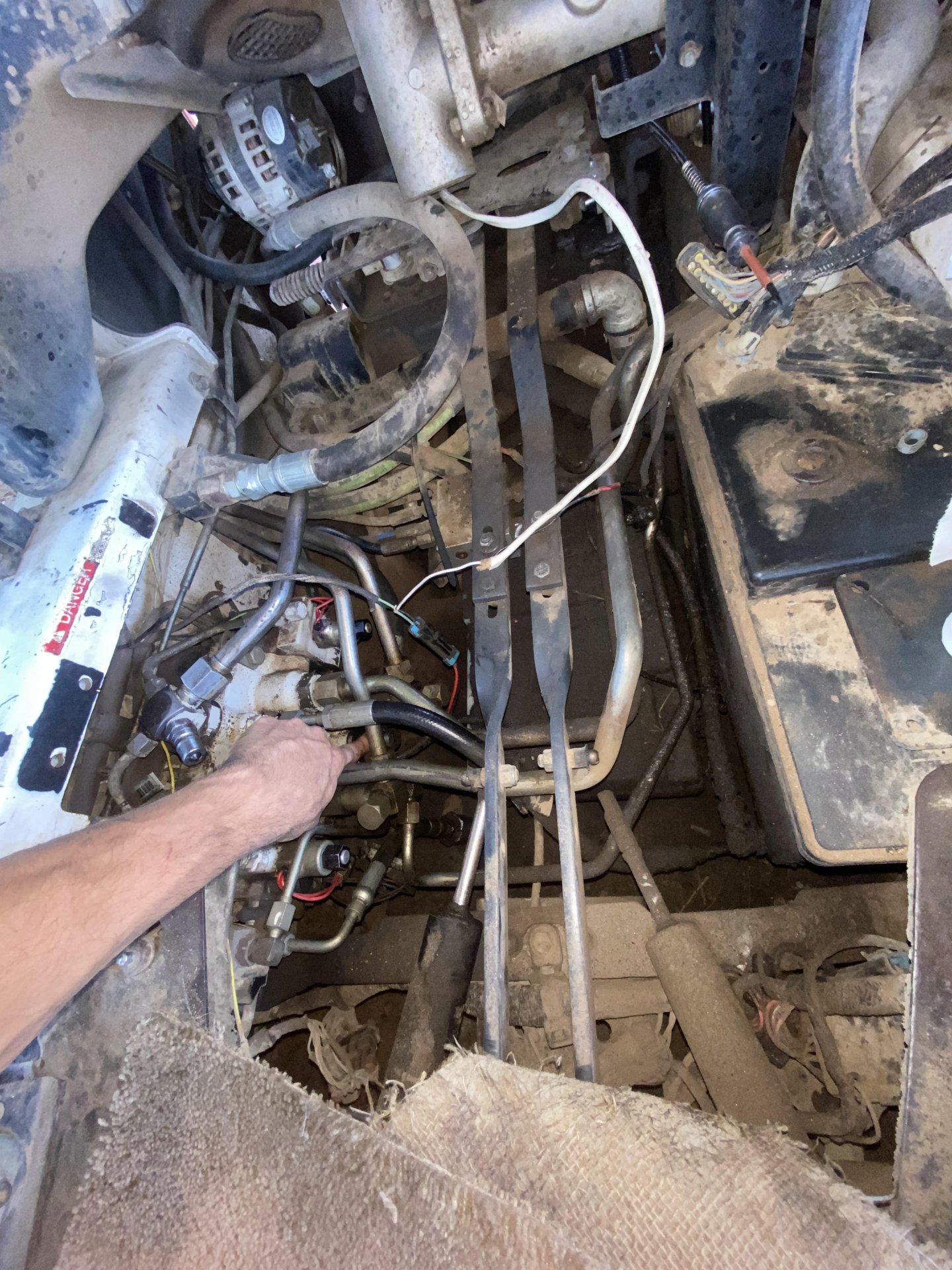

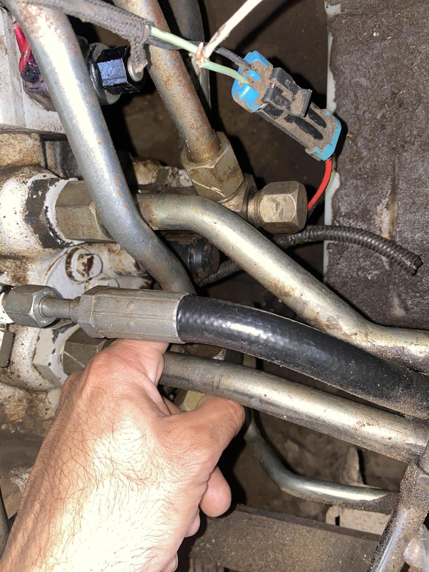

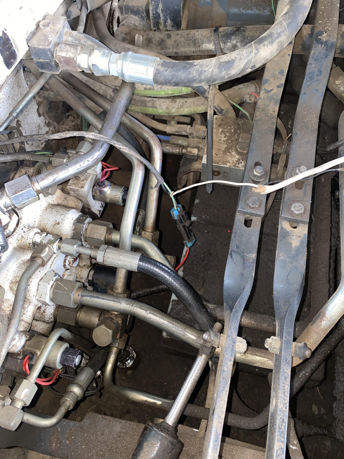

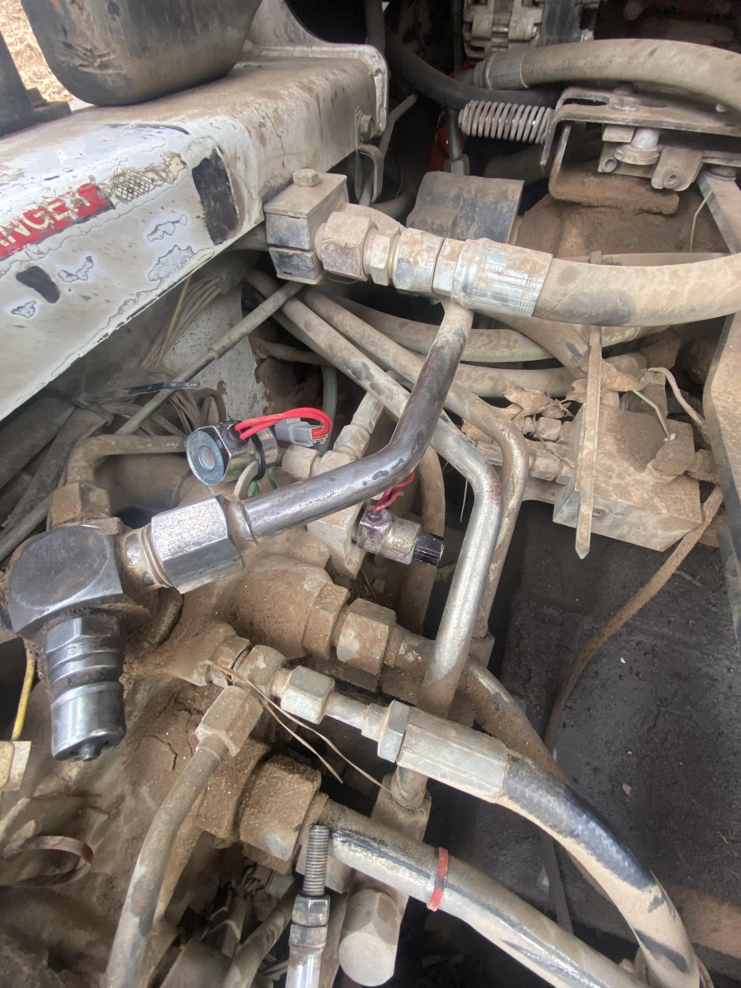

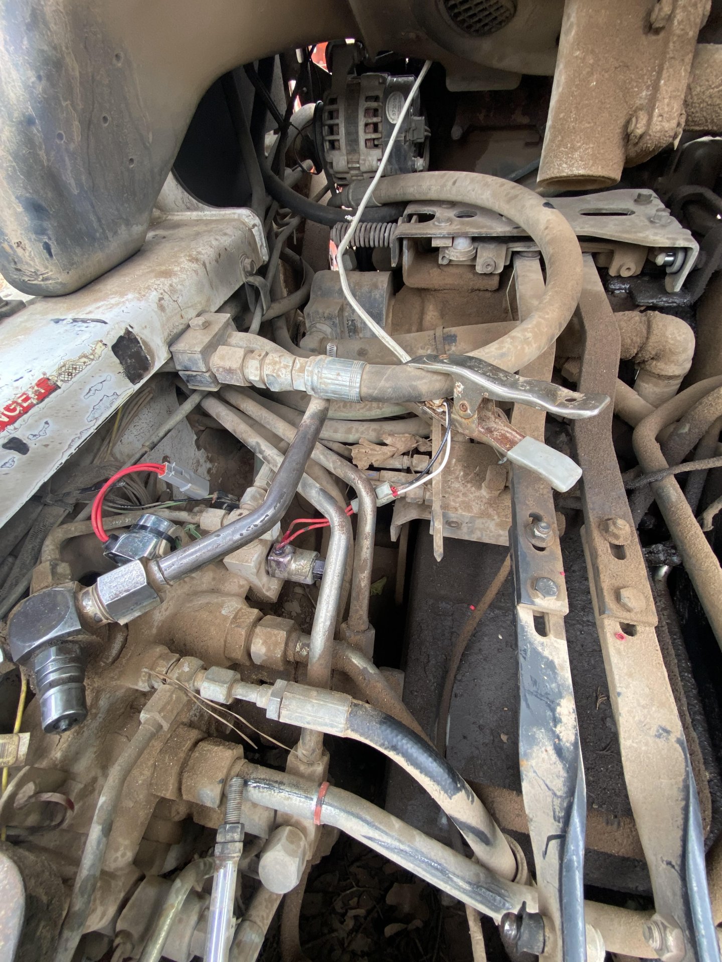

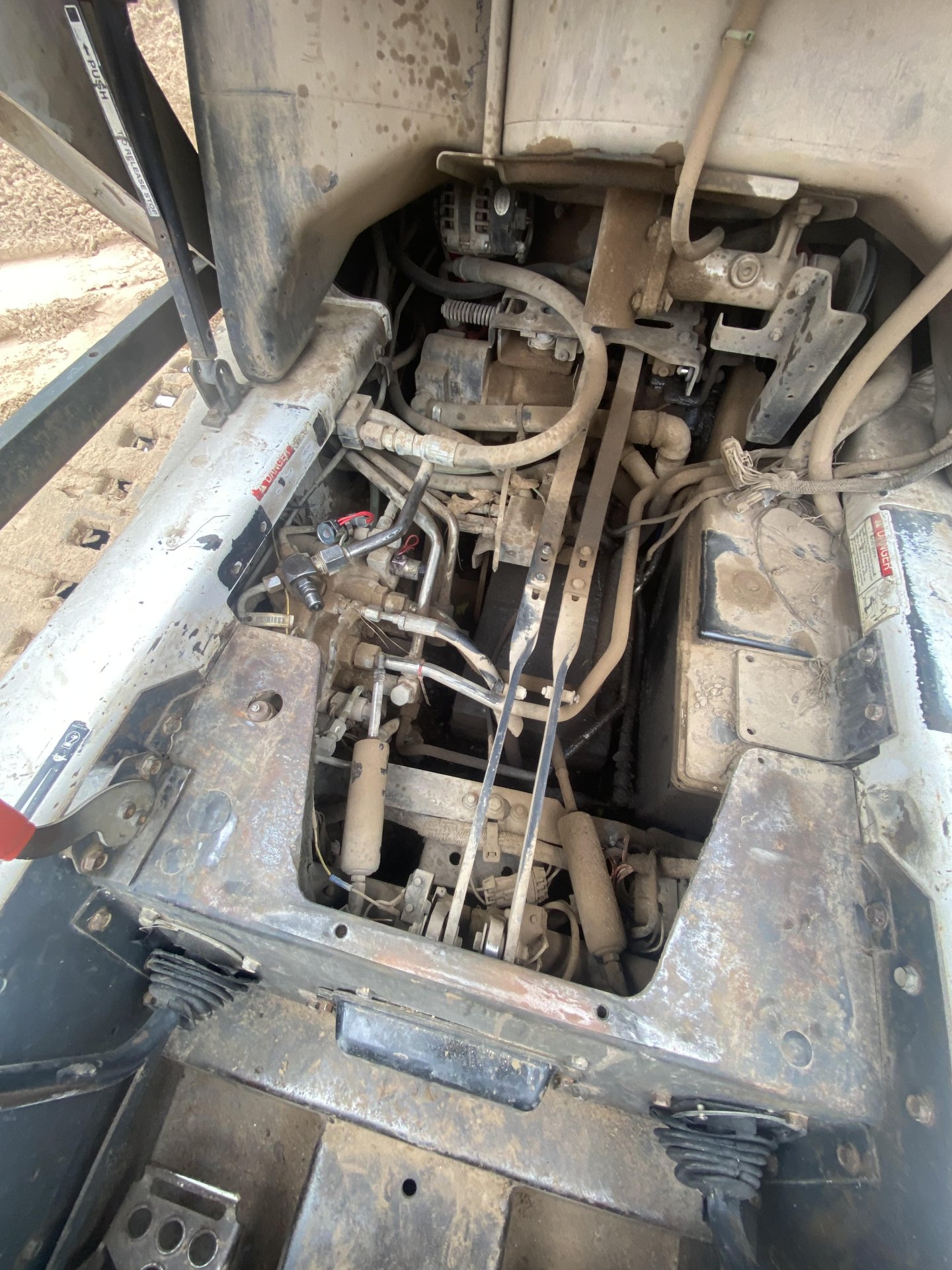

The owner did show me this sensor being bad
This sensor is located under the seat, under the cab, there is hydraulic lines etc
the owner said this sensor could be the problem
I tried to plugging it in, unplugging it, I tried a wire to put into the harness that goes into it,
Nothing worked. Lift/Tilt only works when machine is cold.
Here's a video of what I am talking about, same issue, same exact problem and the general location of where the owner told me to look
Machine is locked up, fully stuck in a pit
Usually, when it is cold, the machine can lift/tilt, but at this moment, lift tilt fully locked
I cannot get it out of the pit because the bucket is locked
Pictures: Sensor location under cab, tried fixing old sensor, didnt work, tried putting in new sensor that does not fit into the hole but will take the wires, still lift tilt flashing
Anyone know how can bypass this situation so I can get the machine out of the pit?

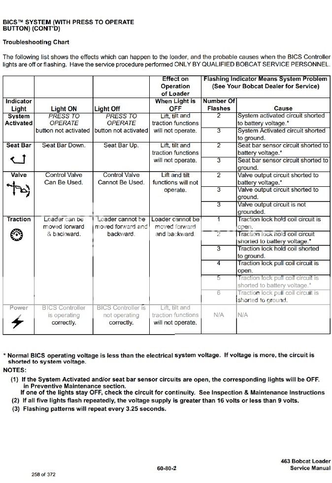

here is some directions I found about disabling the BICS system:
If it's in your way, as you say it is, to TEMPORARILY bypass the BICS, raise the cab and look at the valve block. There should be a solenoid valve in it and a wire going to it, with a plastic warning tag on it. Unplug the wire, and hook the portion going to the solenoid to a 12V hot and ground.
Basically give the solenoid power and see what happens

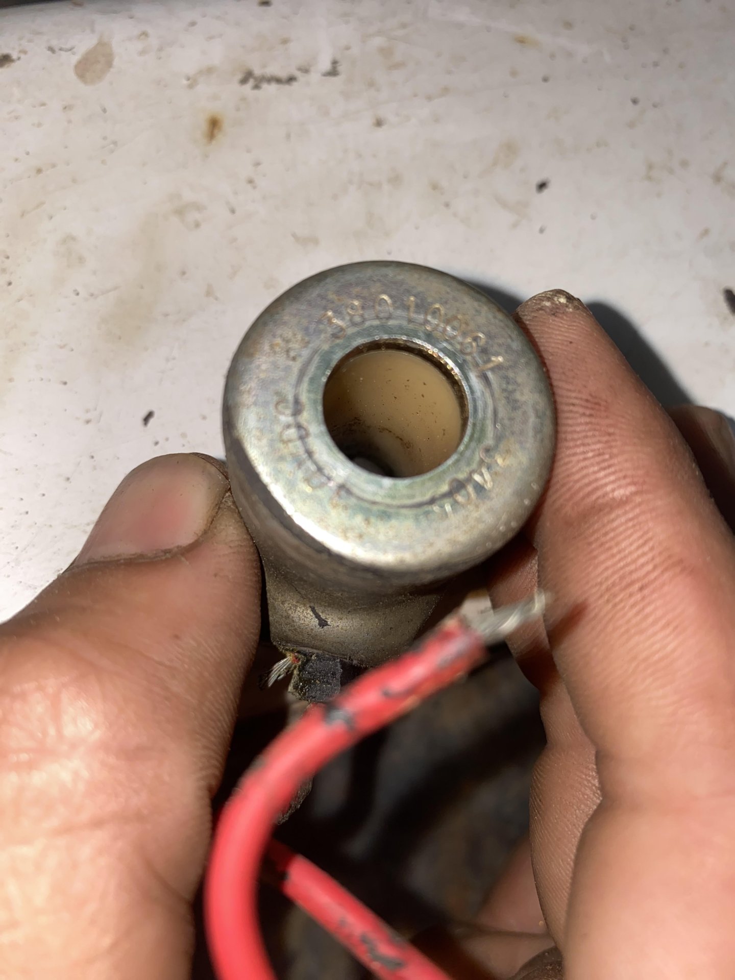

What is the easiest way to conduct this test? I will now go and put power to those two ends on the old solenoid, I will run temporary wires to the battery and see what she does
Ok this is where I am at, trying to put 12 volt power to the solenoid, does not work
Please someone give advice: How can we free the bucket so it come up, then I can back the machine to where it needs to go
The machine is stuck, I cant get it out of the pit, and its getting picked up soon
I'm guessing: loosen a hydraulic line, but I dont know which one
Here's a possible solution that bypasses the BICS system
From what I understand: He hooked up relay that powers something in the control module
3 solenoids that power the lift tilt going into a relay, then that sends power to module telling it that everything is ok
If someone can walk me through this, it would be appreciated
I am under the driver seat doing electrical diagnosis
Voltage going to BICS solenoid, 4 volts
There is ONE FLASH on the dash for the lift tilt fault
Please help, machine is stuck and needs to be picked up
I put 12 volt power to it like the video showed, except without relay, didnt work, it says in the attached diagram that BICS voltage is lower than 12 volt
