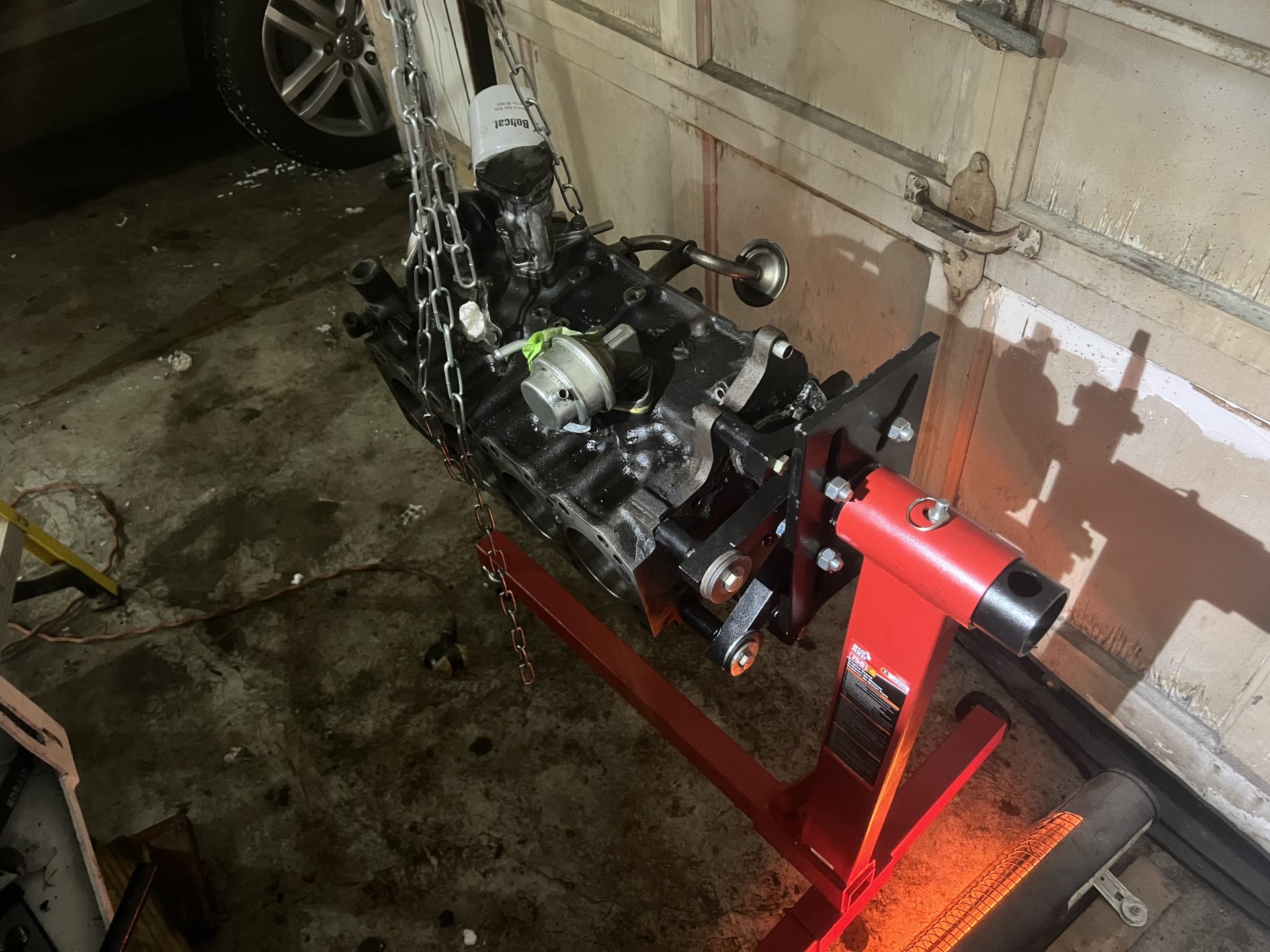

A definite positive news meanwhile today was that I was able to get the engine block finally attached to the engine stand 🙂

Glad to hear! Say, by chance... Could you tell me what size hose that is next to the upper radiator hose on the water pump? I think it's a 1/2 inch, could you confirm? No rush.
Motor on the stand will make it much more "civilized" to work on, nice job.
Good job on the stand. That will help keep things clean inside and much easier to work on. I think I mentioned it earlier, but, my head was warped .005 between cyl 2 and 3. .005 is max without resurfacing. That area is common as it is the hottest area. Doing great.
