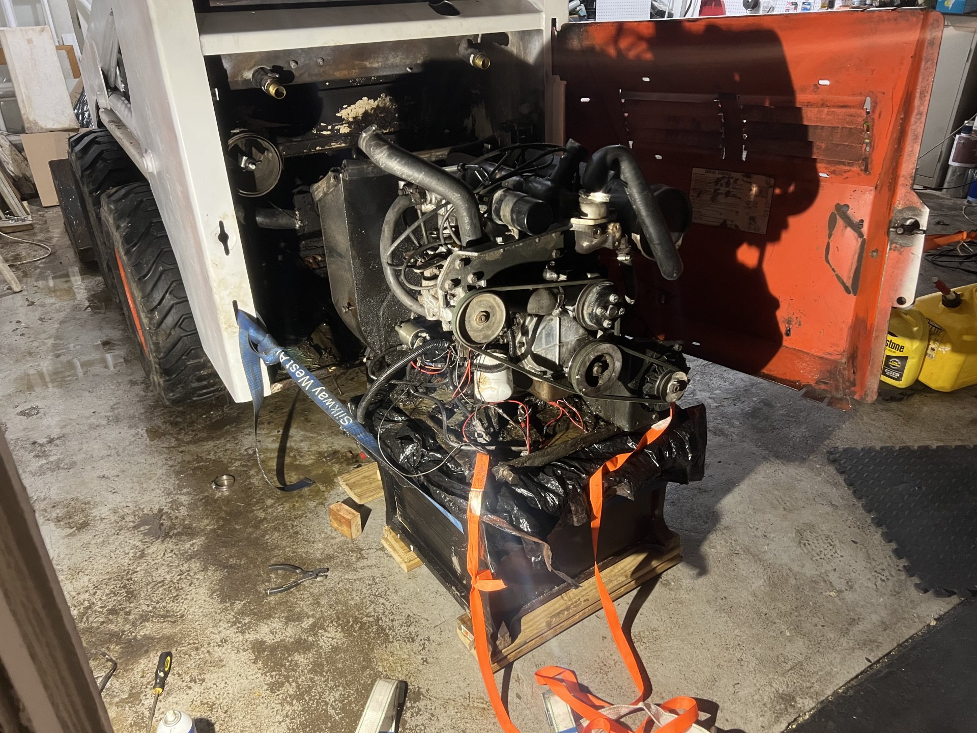

Thank you for the detailed explanations and advise, appreciated! I had no idea a hoist could be rented! I spent half a day today building a platform, disconnecting the engine attachments (which surprisingly went smooth without the need to remove the seat), figuring out how the engine would need to be pulled (ended up using my van to pull it out inch by inch onto the platform). Engine is out now, but I am a bit worried about looking at all the oil and oily sludge that is behind the engine - worse nightmare .. could some of the hydraulic pipes and connections be leaking?!!

Thank you for the valuable advise .. I will get the head checked at a mechanics shop (once I get to the head!). Yes pulling onto a platform was a bit crude method .. I was just by myself so going back and forth between driving the car a bit (to pull) then checking if the engine would not fall off was a bit cumbersome : )

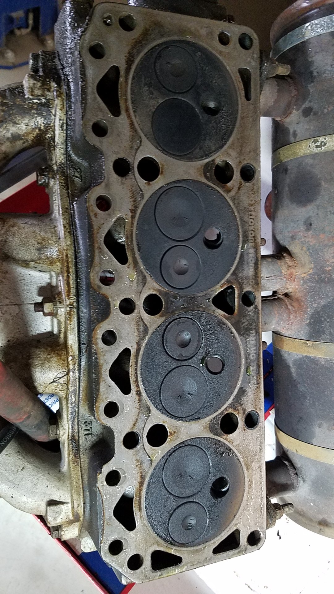

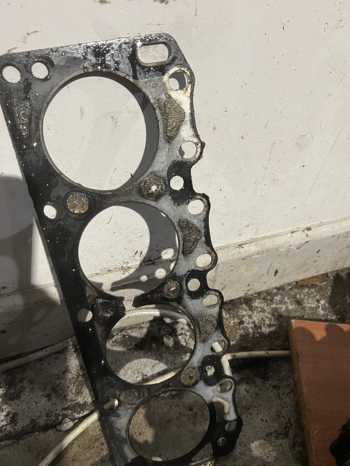

Finally have the engine head block visible - the head gasket was definitely damaged (pic attached below), and the video link shows the top view of the engine head, as I love the pistons manually .. I am also noticing of the holes completely sealed off .. perhaps the blue devil coolant sealer I had added blocked the hole instead of fixing the tear in the head gasket? Not sure .. but any advise on how to proceed, and if I should be looking at replacing the pistons etc would be highly appreciated:

Definitely a leaking head gasket there, yikes! I would be pulling the oil pan to see the condition of the bearings at the very least. Before taking any of the pistons out pay attention to how far up in the cylinder all the pistons come. They should all be exactly the same distance below the deck surface. A bent connecting rod can easily happen when a cylinder gets the volume of coolant in it your motor was likely going through. A bent rod will be shorter and not come as far up in the cylinder. Anti freeze in the engine oil is very bad for bearings. Lots of small details make for a reliable engine repair, start by checking these items first.

At 100/110 psi compression, you're at the bottom of the range, but you've got acceptable numbers. To get the block bored and an oversized set of pistons in there, you're looking in the area of 2500. A set of pistons is a grand for these engines. You may find a set of pistons that would work like a 1600 Lotus or Anglia on eBay, and those might be cheaper. Just pay close attention to bore size. If it's me, I'm not going to gamble, but that's just me. I'm a dealer for Reliance Power Parts, and can get those parts.

I did not see any cylinder ridge so have your mech. check the bore and maybe some honing and a new set of rings will do the job. yeah check the crank and bearings since you are right there.

Valuable advise, will definitely check how far the pistons come up and if they are at each other. Incidentally, a forum member Ster1 happens to be in the area and dropped by to advise me! He indicated by moving the crank shaft that the bearings seem quite smooth, but it doesn't hurt check them out anyways when I get the oil pan removed.
