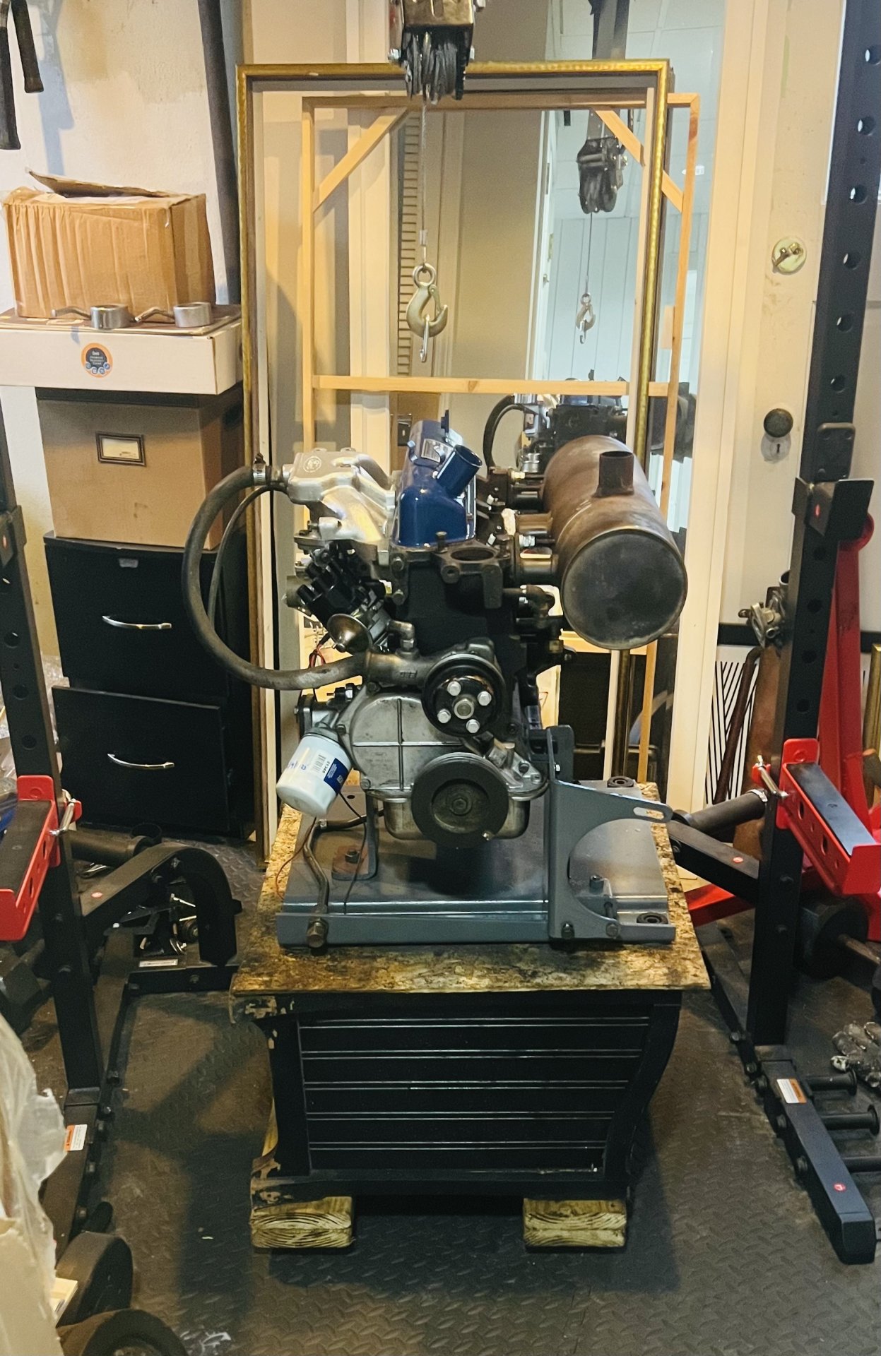

Now on a home made stand .. starting to look more like an engine : )

That is looking great. You are certainly getting there! I am waiting for the time when you reinstall the engine. I found a way to get it done but curious of advice you will get. I may have done it the hard way, I have no idea. Make sure you grease that coupler between the engine and pump while things are apart.
