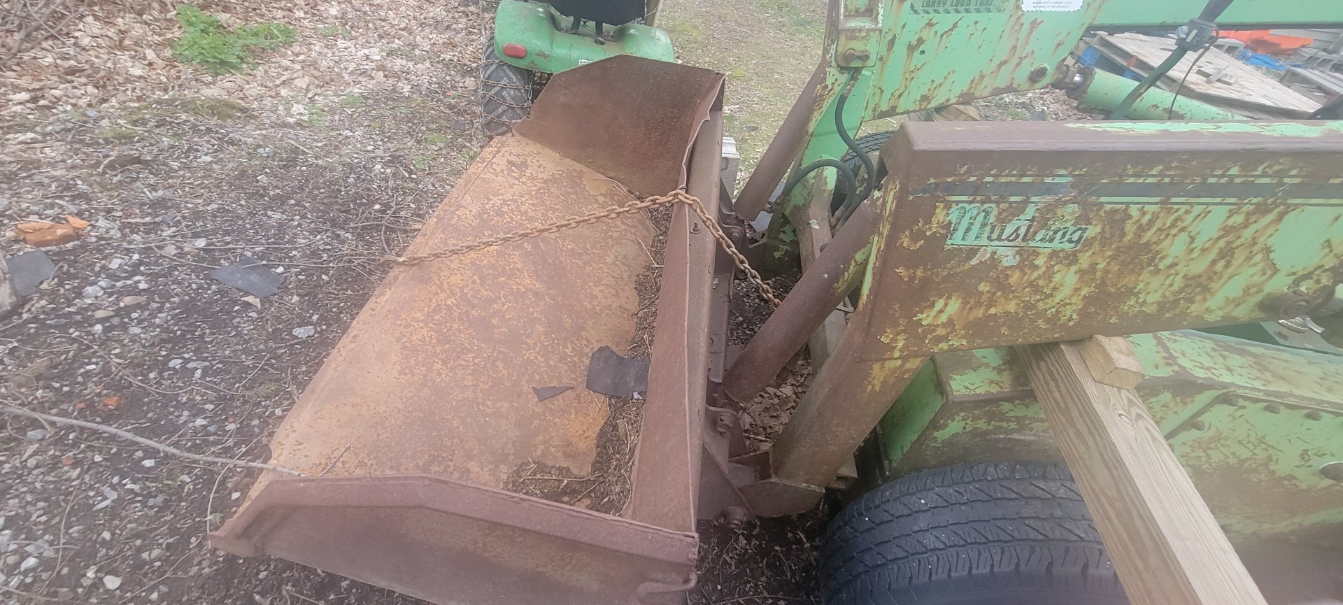

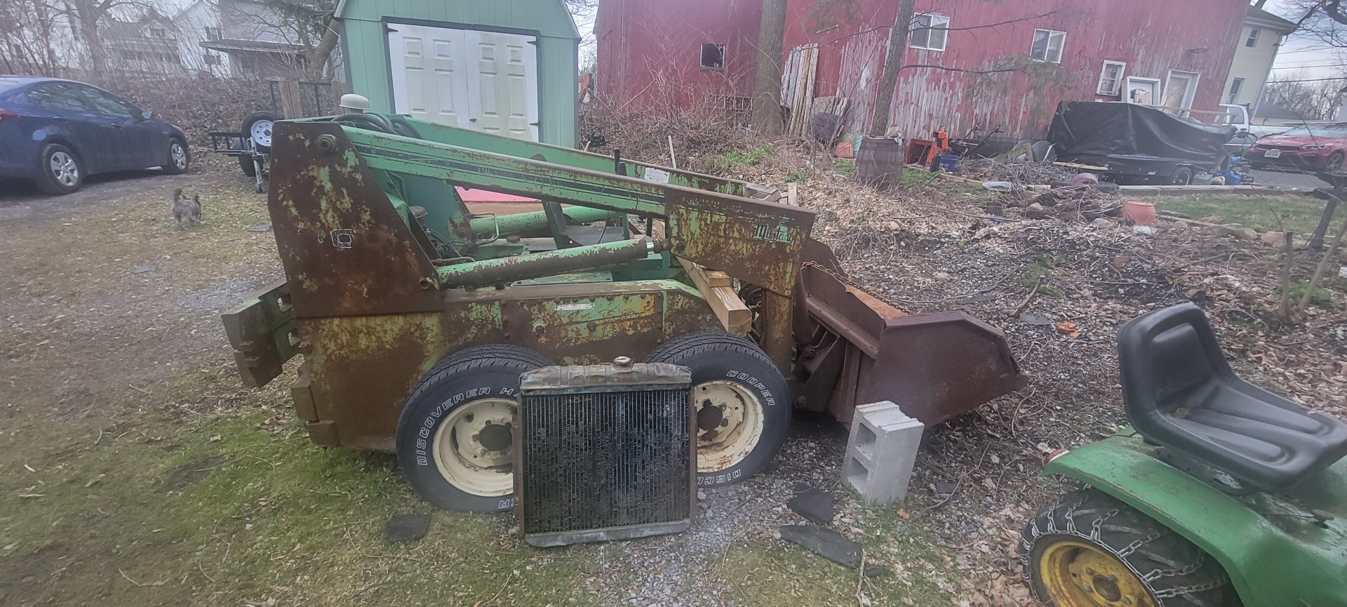

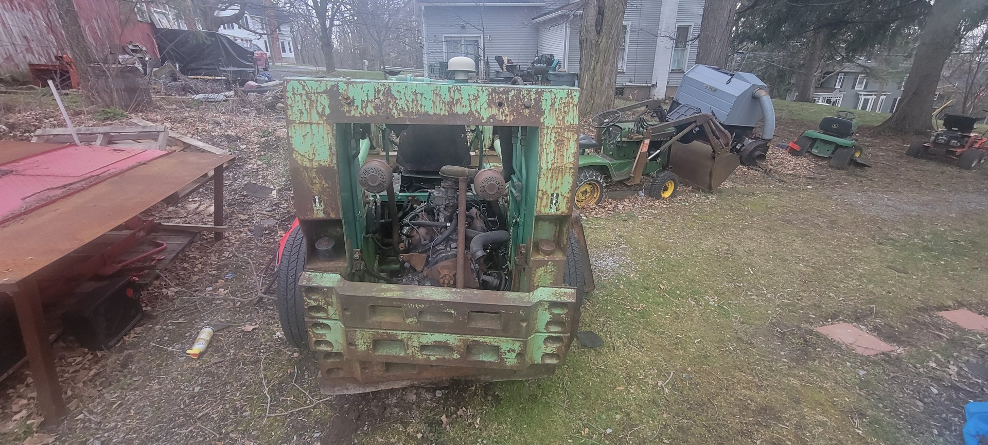

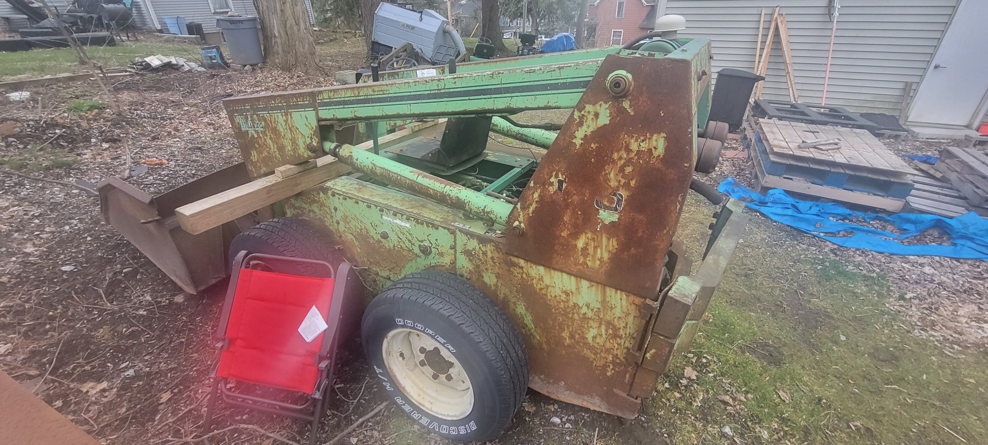

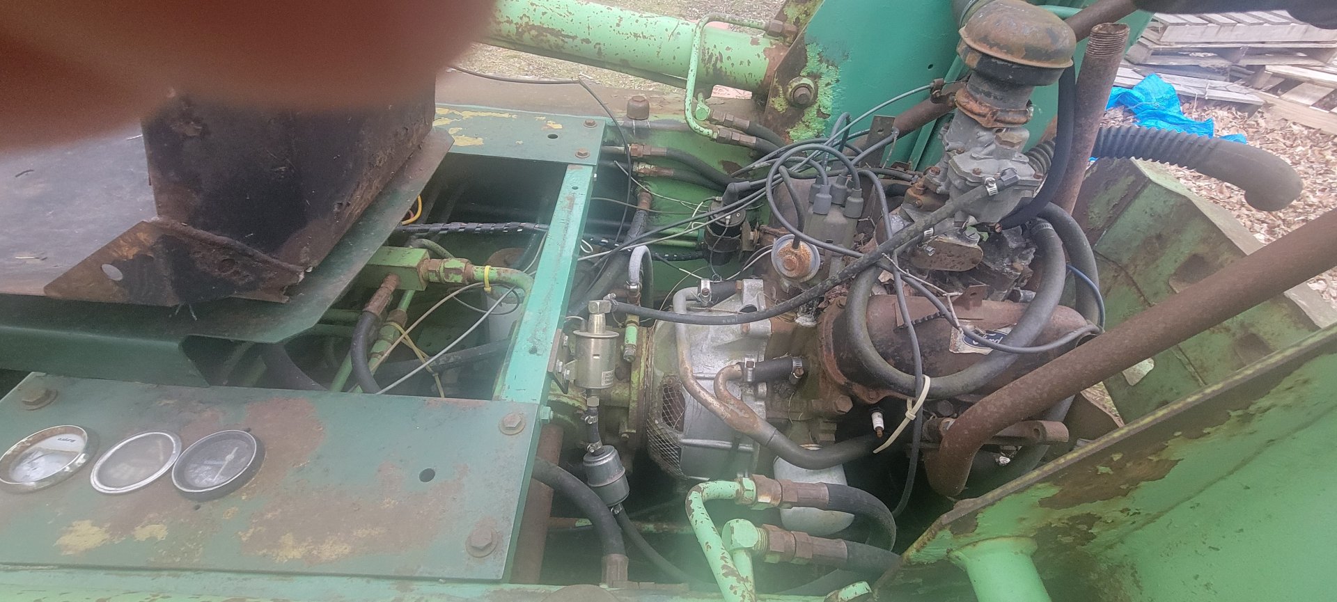

I appreciate the feedback. I'm not afraid of what I might run into rust wise or anything. If I need to get it sleeved or something it is what it is. My biggest struggle is I have no garage so I'm shad tree mechanic-ing old school style. I am almost 55 so not exactly new to me. But it would be better to have a Garage where I could throw it on an engine stand and work on it without worying about the weather etc. I will post some pics of the Skidsteer so hopefully I can get some more feedback once you all have some more info.

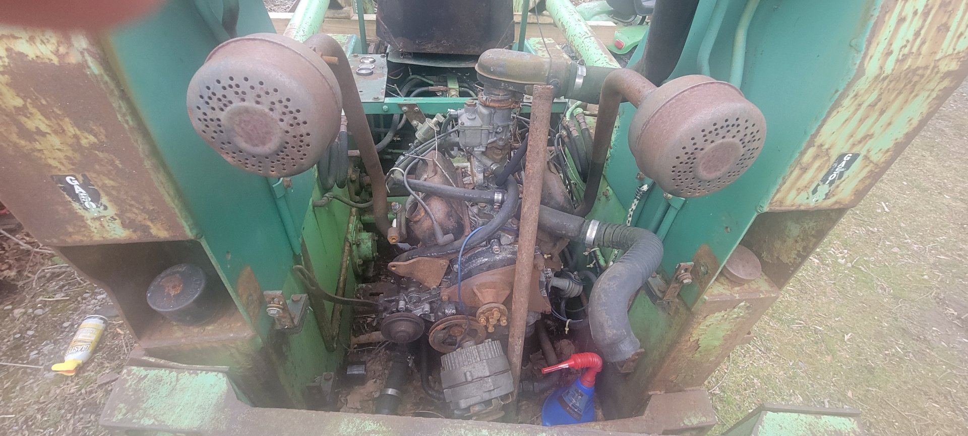

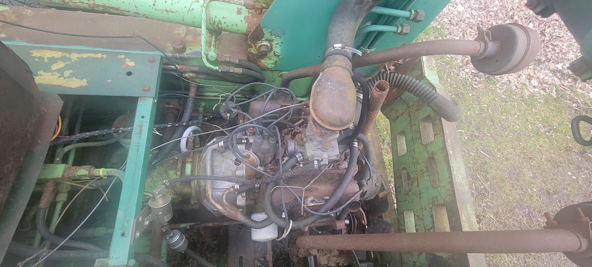

I don’t see a sheave in the pictures. As far as using a different engine, I would recommend sticking with the original as much as possible. Retrofitting would likely require significant engine-ering (pun intended)!
Looks like a torque converter, hence the bellhousing. Unless there is a kit somewhere, which I doubt you'd most have to likely have to build an adapter plate to mount another engine to the housing, plus engine mounts. Both can be done but not without a significant amount of equipment and know how. There are YouTube videos.
Yours is the torque convertor version, which is good in my opinion. "Throw any engine in"? No. I researched other engine possibilities to mate up to the bell housing, which is a must to mate up to the gear box. Other engine possibilities are Taunus, Cologne, Capri, Ford Ranger II and some earlier mustangs. Problem is they are significantly longer than the V4. I've sourced most of my parts off eBay, most as NOS, for my current overhaul and it's not too bad.
