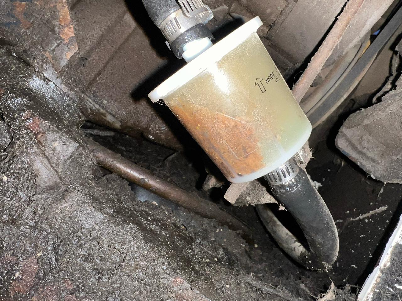

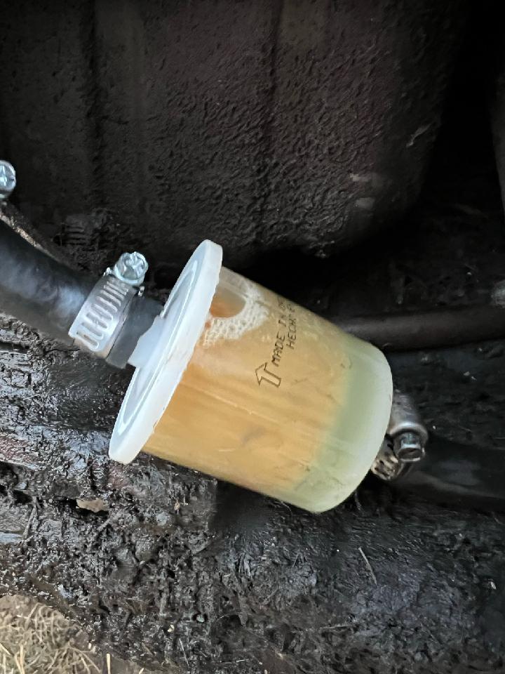

Made headway this evening! Pulled the strainer off in the tank and put a bulb filter in near the primer bulb. Most likely will go through several of these before I've got it all clear...but it's running!!
