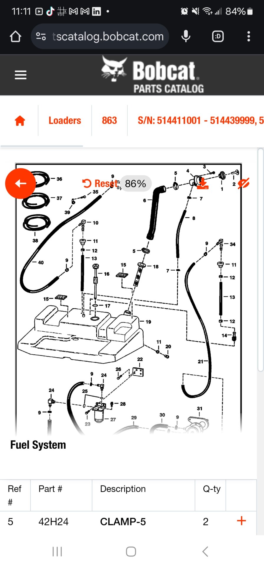

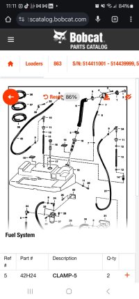

I just noticed that the drawing is calling off a strainer (#18) at the tank...I'm betting that it has never been pulled...looks like more work to get to the issue.

It does look like you will have to pull the screen to get to the bottom of the tank.

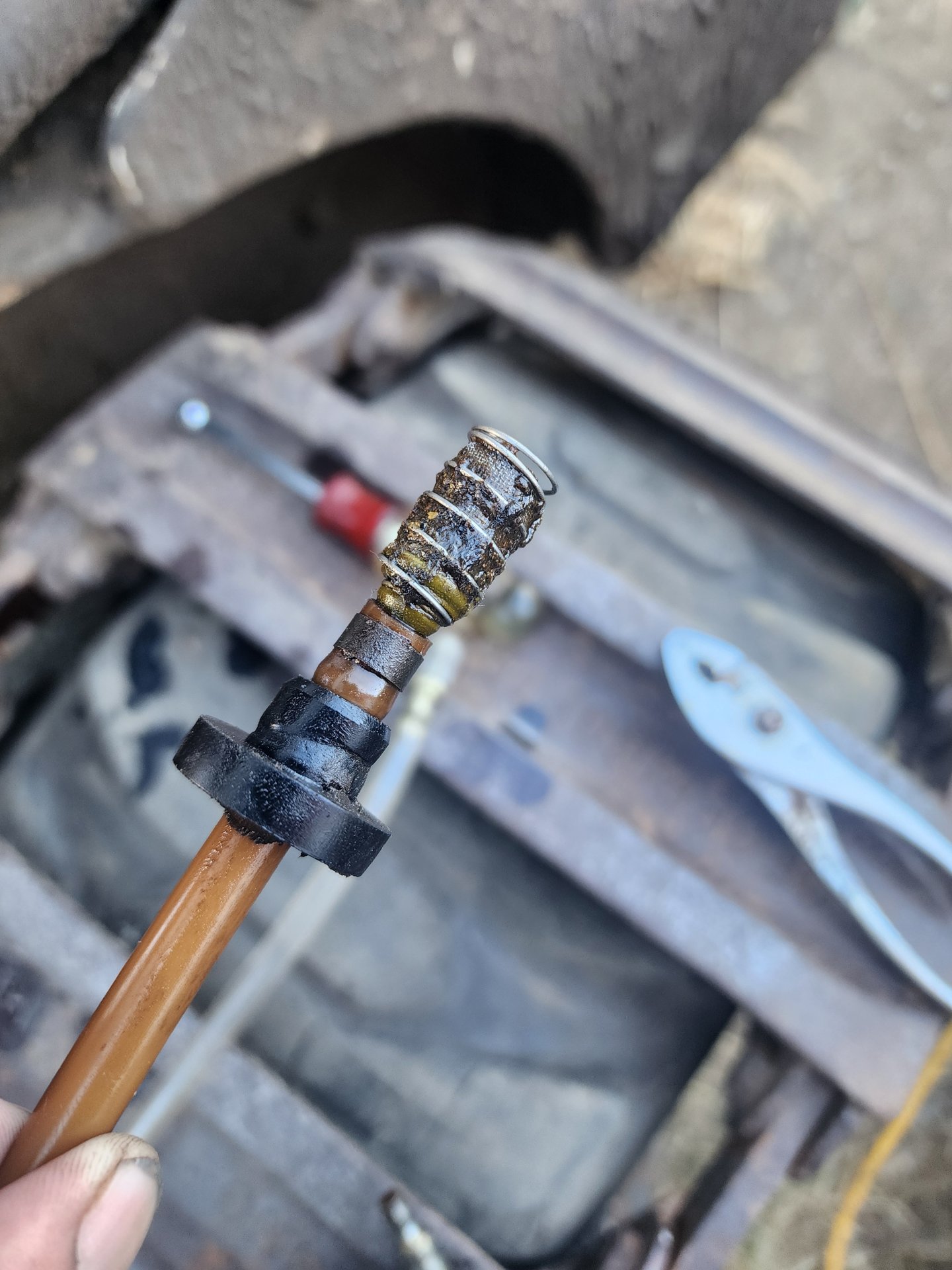

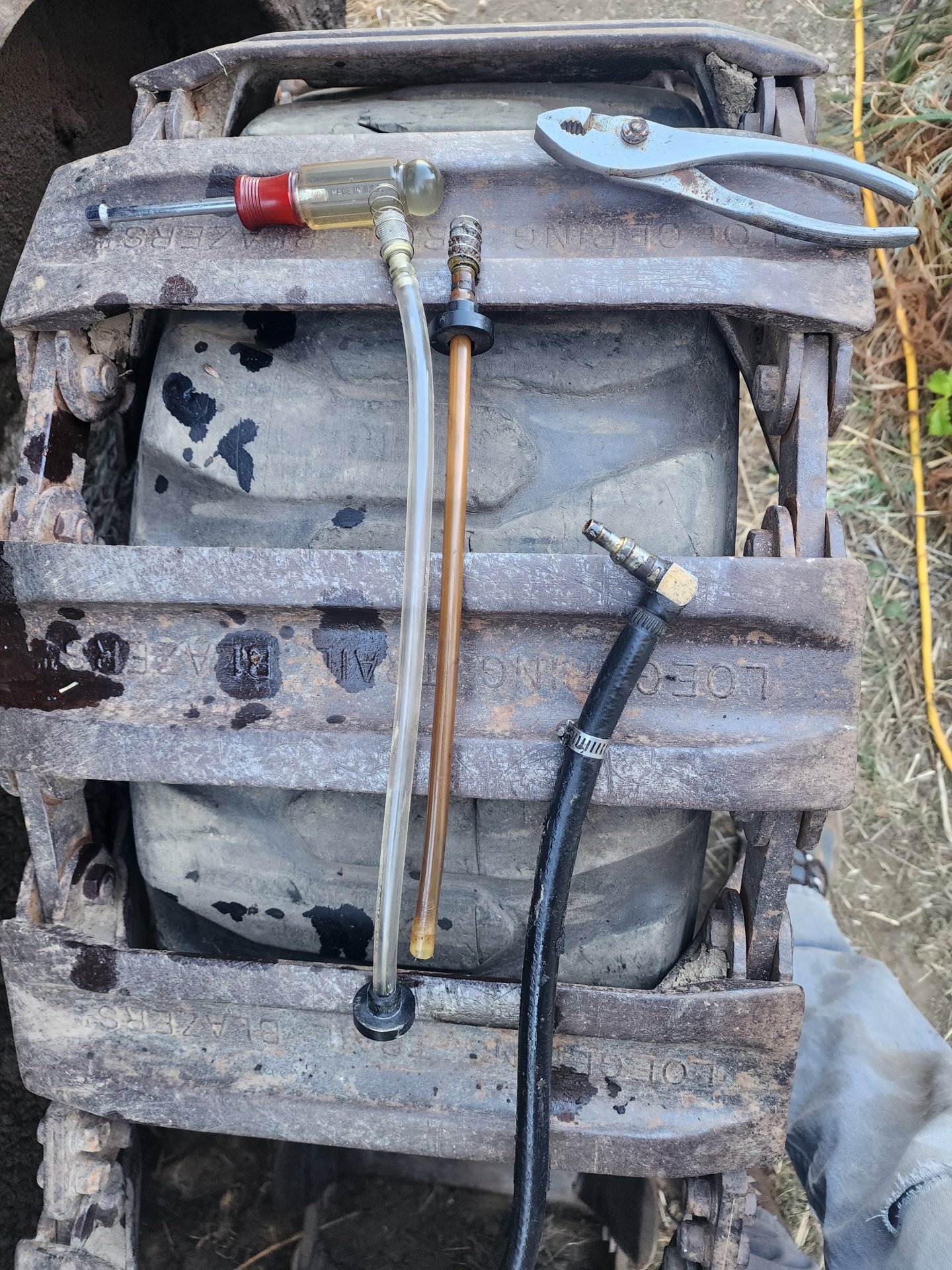

Well let's see....new fuel shut down solenoid and relay and new primer bulb....bulb now collapses when trying to start. Picking up a new fuel pickup tube and strainer... time to crawl back inside again.

I knew the solenoid was bad and the tech at Bobcat recommended the relay when I was picking up the strainer and hose for the pickup. Good news is, all those parts seem to have not been in vain.
I primed it up to the top of the filter being I had everything pulled out (I replaced the supply line while I was playing blind contortionist as well), started up within seconds. I was like finally!!!
Took it for a drive across the yard and it started to bog down again. Jumped out quick to check the primer bulb and it was 1/2+ collapsed again. That leaves me with one thing remaining i believe...so much build up of crud in the tank that it's getting the new strainer plugged. It sits for a minute and it will start back up for a few moments until it's drained the line again.
With all of this, I believe I am going to put down some blocks and drive the left side up on them and drain all the fuel through the drain port (after i put a little air to the supply line and attempt to clear the strainer first), put a couple gallons of fuel in and drain again.
Wish me luck. Open to any other thoughts as well.

What does Schematic show...pulls straight out forward or backwards?
#11 & 20 on schematic right??
