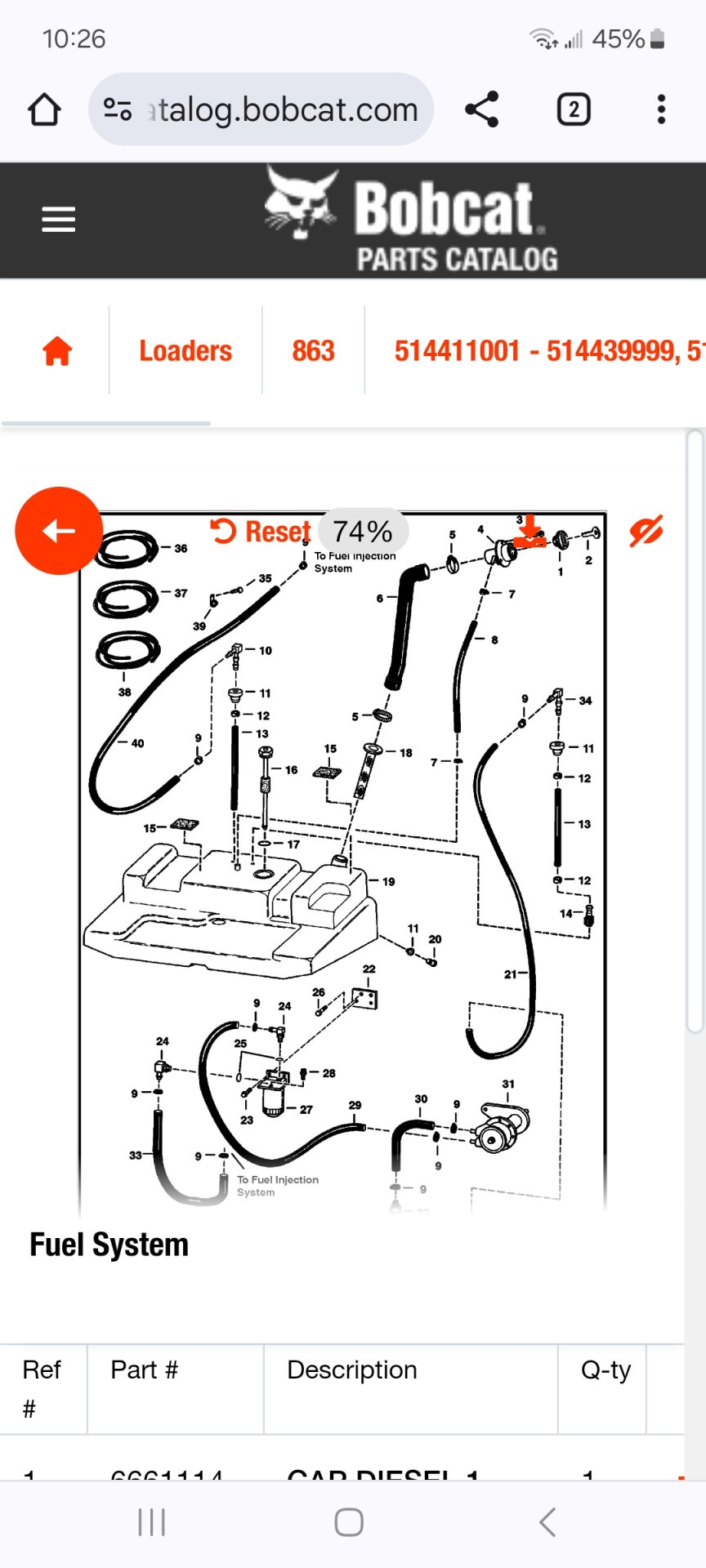

Here is the 863 fuel tank / parts

What about a reducer hose? 1 inch to 1/4"?
Also, might be a plug to drain. But a major pain from what i'm told.
Todd

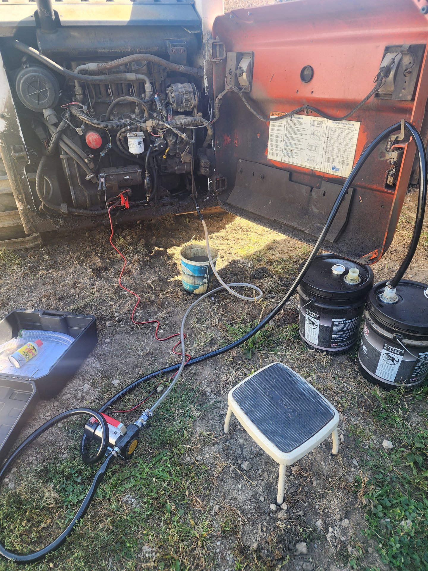

Well, still could not get a hose onto the tank. But what goes in, must come out somewhere, right? 😎

Only thing with this is that what ever is below the strainer is not being removed. The color coming out the first minute or two definitely looked to be mostly water.
