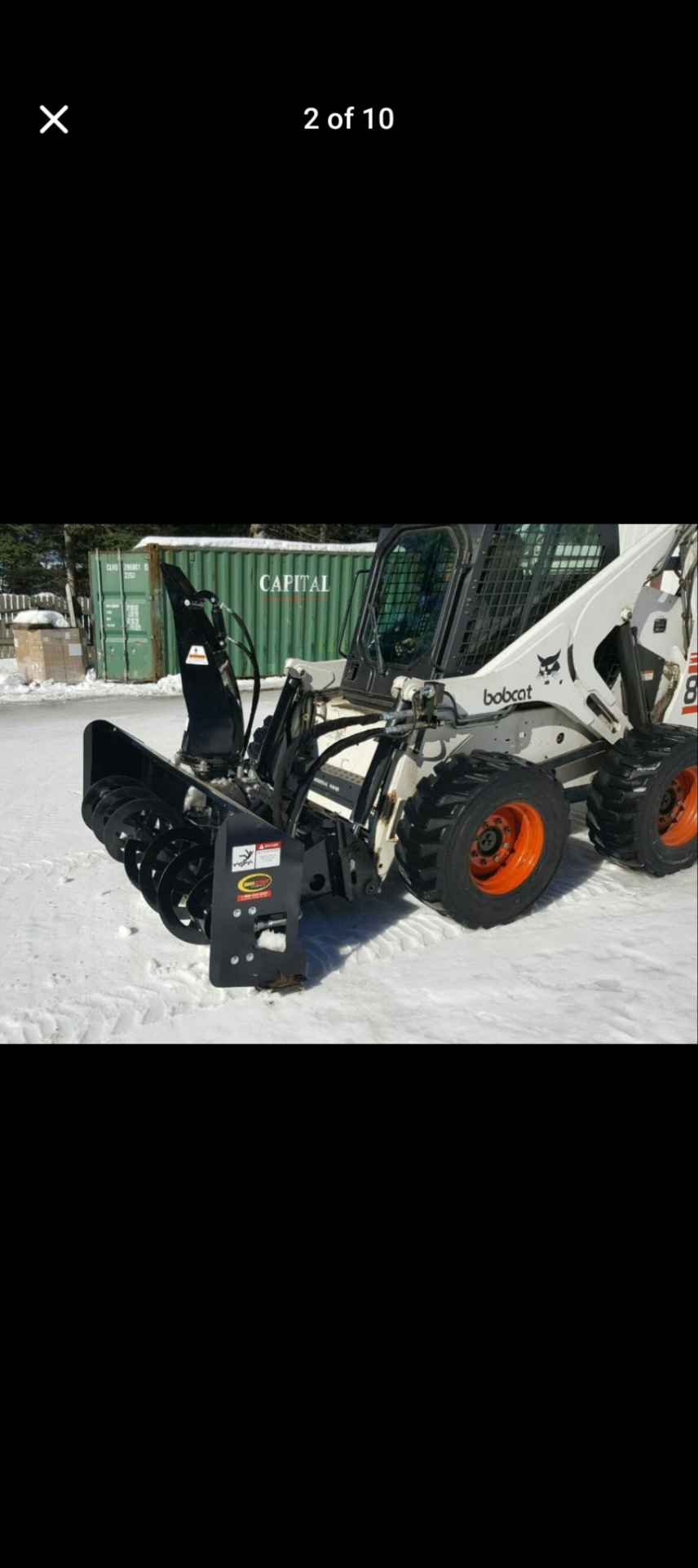

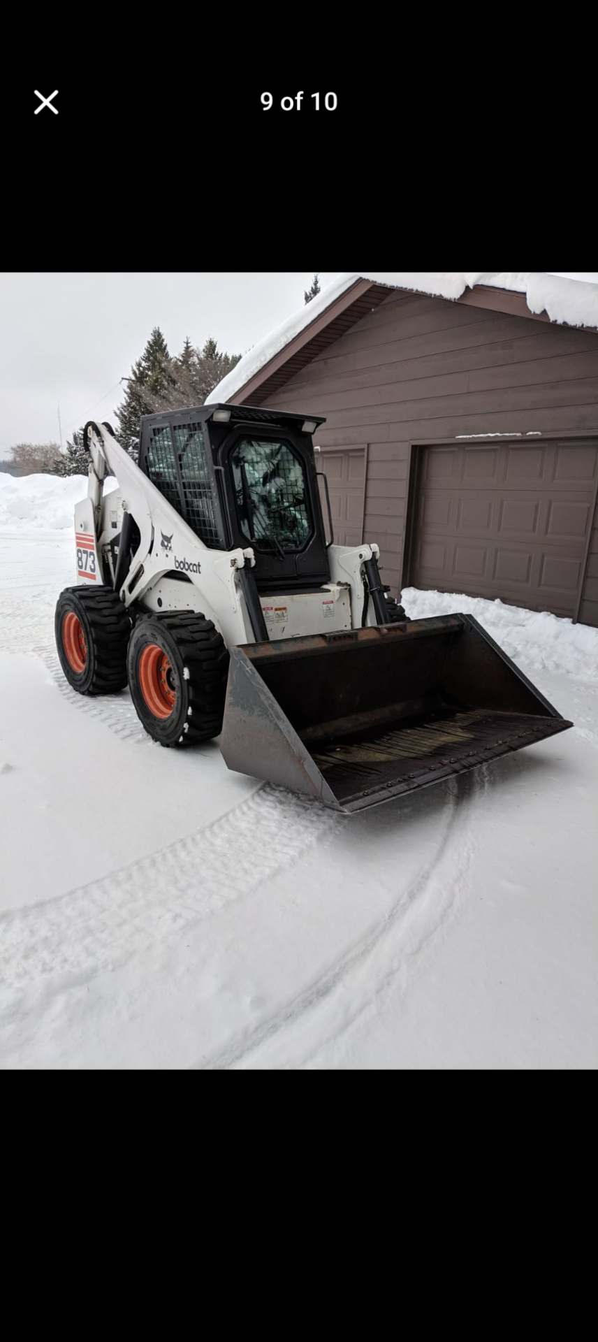

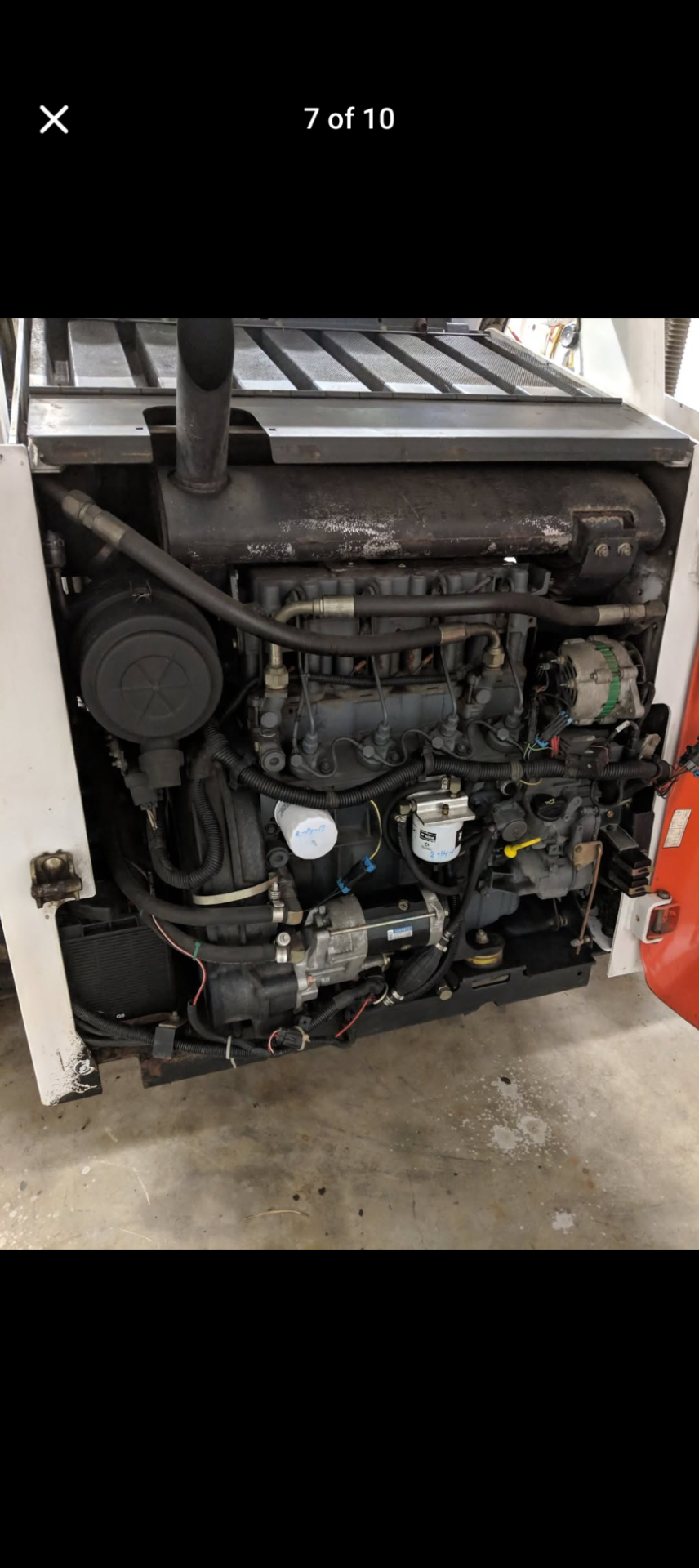

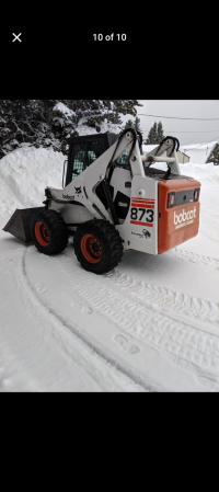

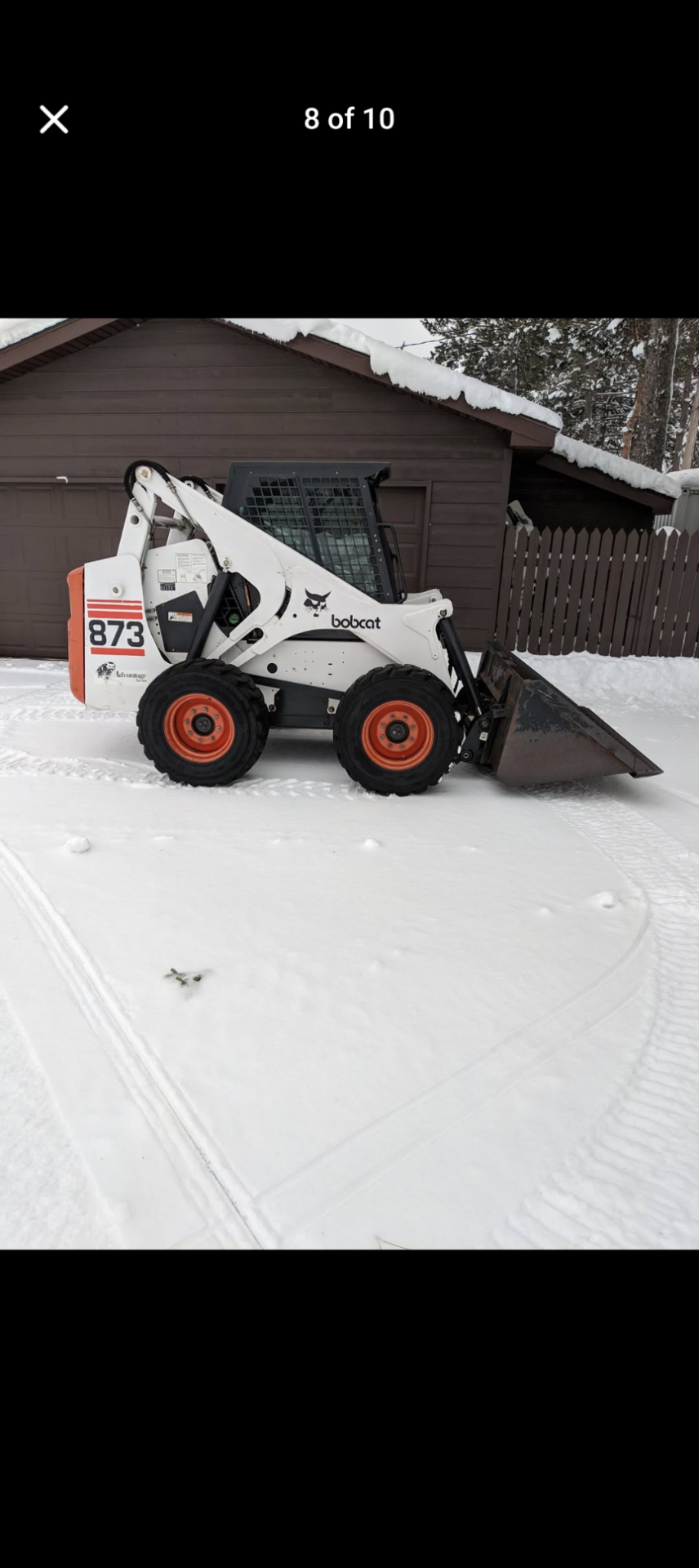

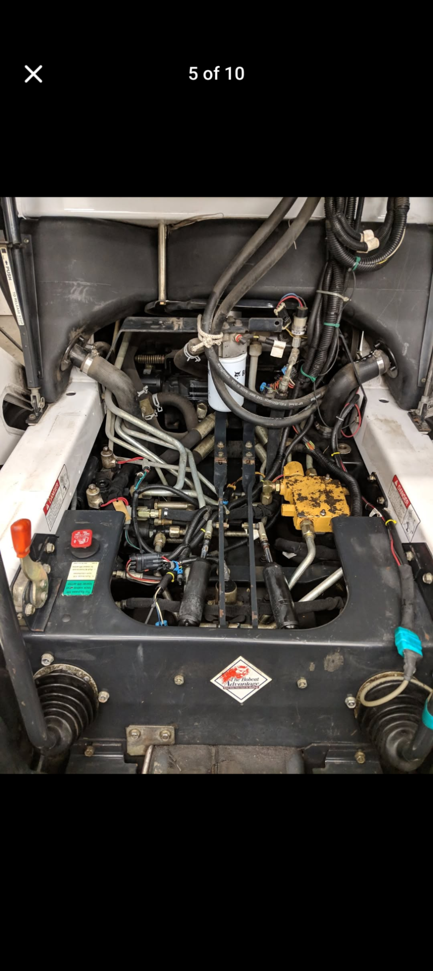

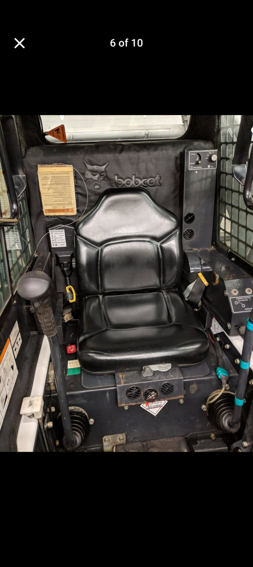

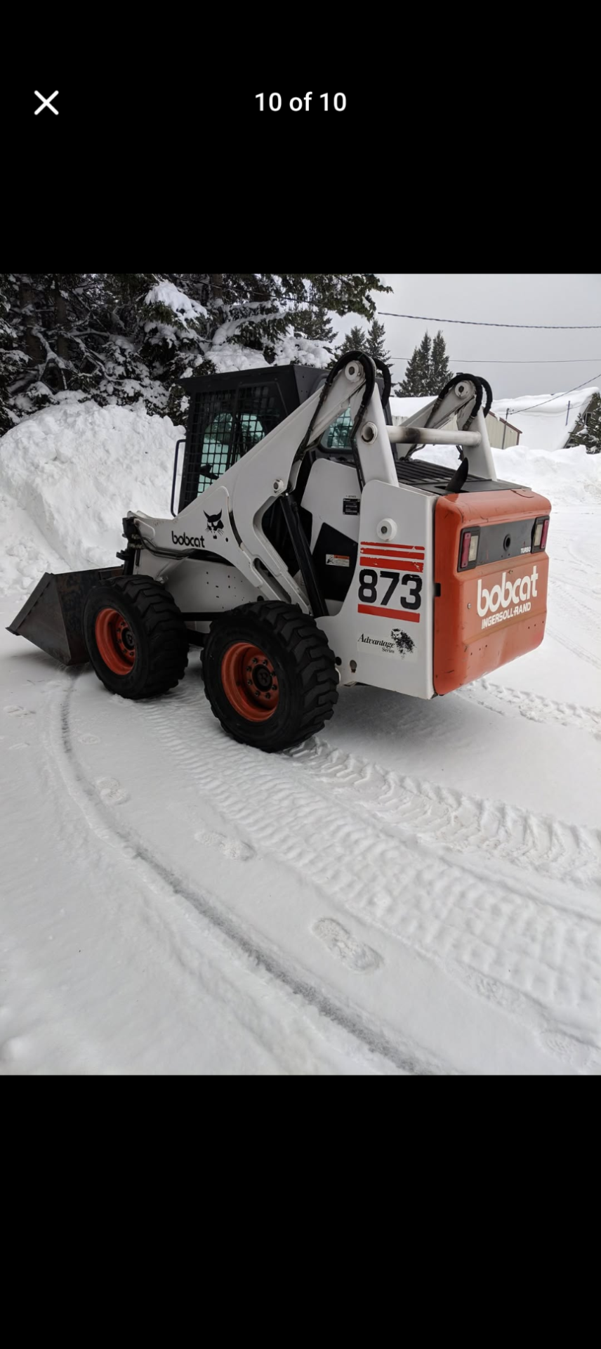

Looking at possiblely picking up a 1999 bobcat 873 f series. It has 1,8xx hours and looks very clean. 1 owner, said he only really used it to clear snow for the parking lot of his hotel and was always kept in a garage also Said they just put a new belt on for preventative measures so that seems good as I've read when it goes it can get messy. It comes with forks, bucket, snowblower, grappler, metal tracks, and a new set of tires with rims as well as snow chains.. priced at 36obo. I think I could talk him down some. I'm gonna go look at all this here soon anything to look for and what seems like a good price?
I'm gonna be using it for my property, clearing brush trees, light landscaping moving stuff. Clearing snow in winter and possibly getting a wood processor to save my back.
Thanks for any input

not sure where your located at but IMO< if he's asking 36 grand for this, that is way way way high, even with all that comes with it
its 26 yrs don't forget, hours might be low, but everything on this is old and time has a way of wearing things out just like use!
it does look nice and clean, which is a plus, but I think IMO he's about 10 k too high to be called a deal IMO!
BUT area also maters when pricing things, in my area this would be extremely high asking price, maybe , , where your at, prices may vary, but I still say 36 is high!
MY 2 cents ?

36K with everything is a bit High. It's 26 years old. $25K would sound correct. Timing belt changed? Proof of it with hours by a dealer?
Or just drive belt and fan belt?
It's supply & demand on Skid steers. Depending on where you live makes a huge difference.
My two cents.
Todd
Yes timing belt. Said it was done by a bobcat dealer and has paperwork. I am northern Michigan so thing are a little bit more expensive around here.

That's steep. Forget about the attachments and look what that kind of $$ will buy, a nice Kubota powered unit. The snowblower is nice, the rest of the stuff can be added as needed. The earlier 873 models, I think this one would be included. Had issues with the lift arms cracking around the pins. I can't remember the details but do yourself a favor and search this out. I think the later models beefed up the area around the pins to prevent this from happening.
The steel tracks tell me the machine was put under stress. There is a current post about a 873 with a broken sprocket that also used steel tracks. It's not very common, but over the tire tracks do add stress to the drive train. I'm wondering if the extra set of tires/rims are a little bit smaller to accommodate the tracks. Some machines had issues with the tracks hitting the top of the wheel well area unless a lower profile tire was used.
Short reply:
Priced high. I bought mine for 16k used 15 years ago. Seller had meticulous service records and receipts.
I have steel tracks over rubber tires. 873 needed spacers to move tires and wheels outward for clearance. Not smaller rims/tires.
It hasn’t really failed me in nursery tree spade work. Replaced head gasket after noticing some external oil seepage=oil cooled Deutz. Otherwise a solid machine, but slow.
If you get it, remember always shut it down at idle. Turning key off at high rpm could starve turbo.
