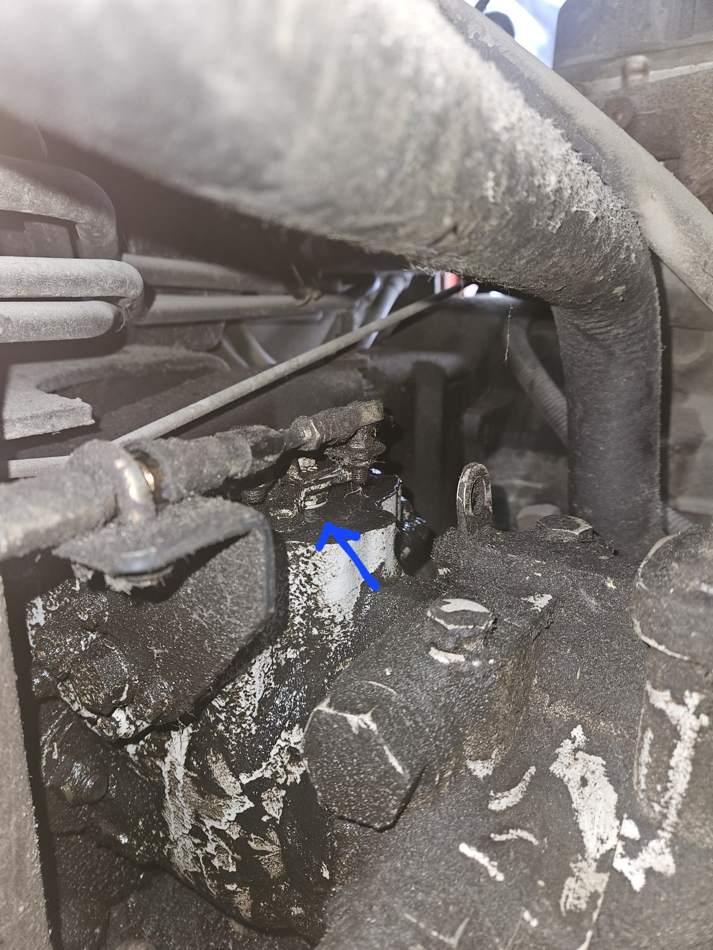

Now it was time to start the motor, I plugged the block heater in for about a hour, jumped in the cab and held the glow plug button for about 10-15sec. I used a flat head screw driver to turn the ignition and to my suprise the machine fired up instantly. Was slightly roughy to start as it was -10 outside but the idle smoothed out pretty quickly and was running great.

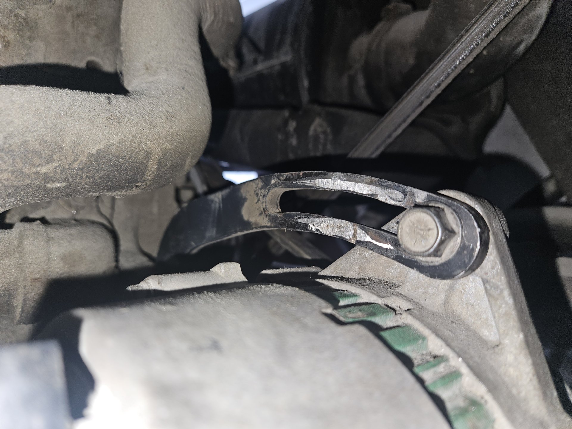

After that I let it idle for a few mins checking for leaks or strange sounds, I did notice a belt chirp on the accessory side of the motor which lead to to find a broken alternator belt tensioner bracket. Since then I've welded it together. see pic below

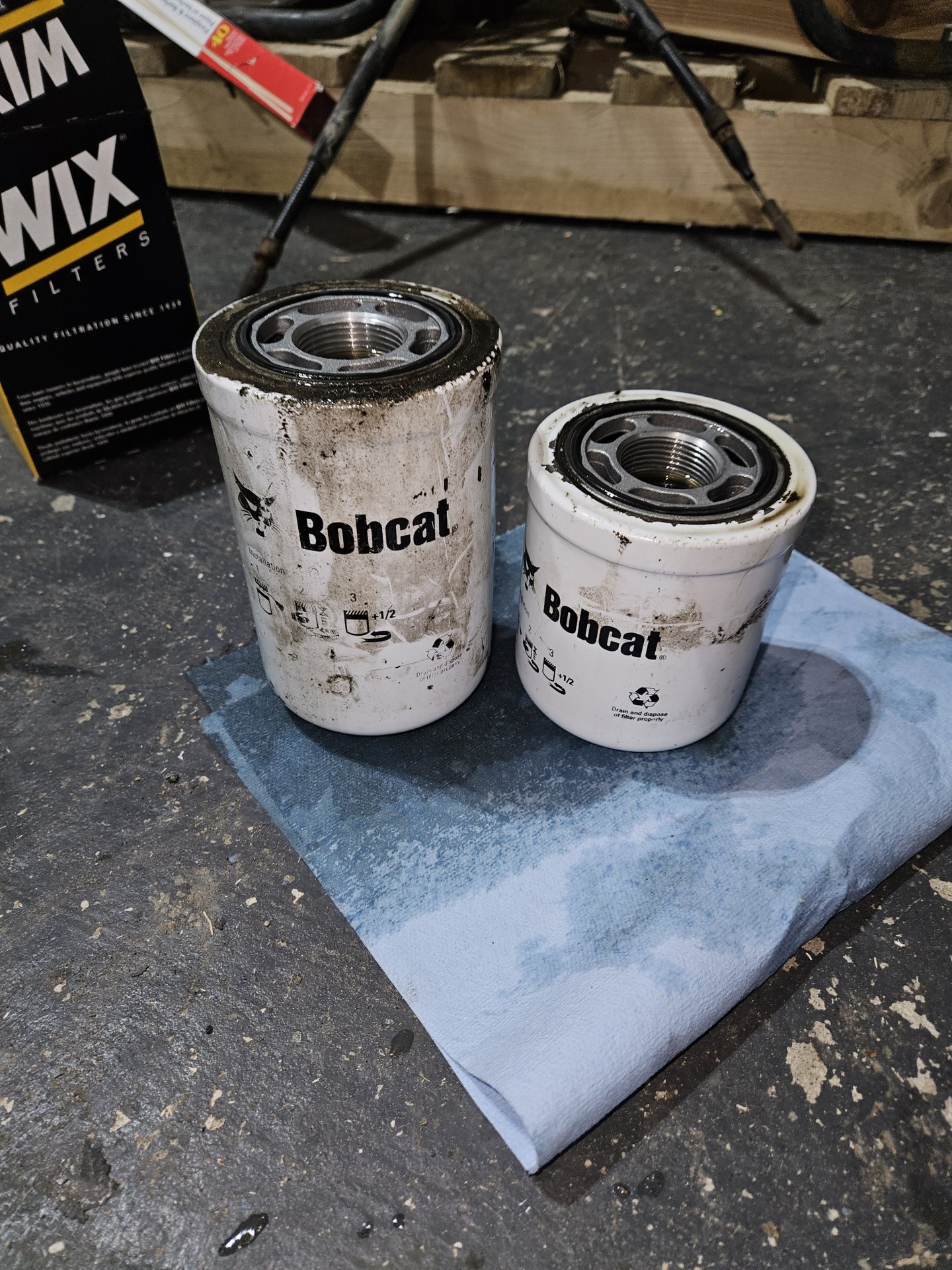

I've since placed a order for 2 new Wix hydraulic filters which I'll change out and see if that solves it. Start with the easiest first.

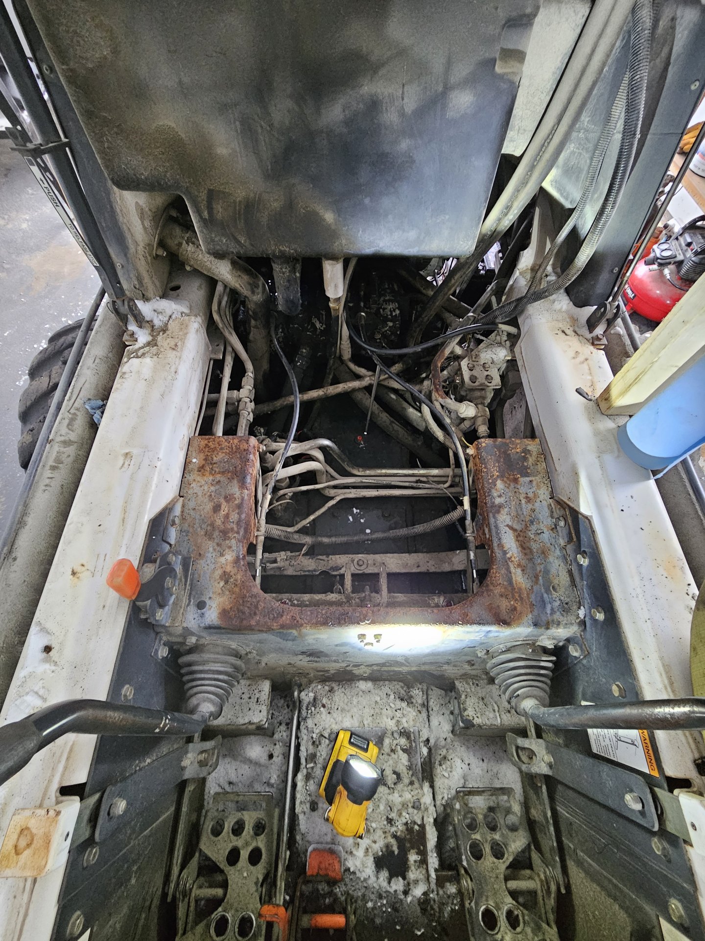

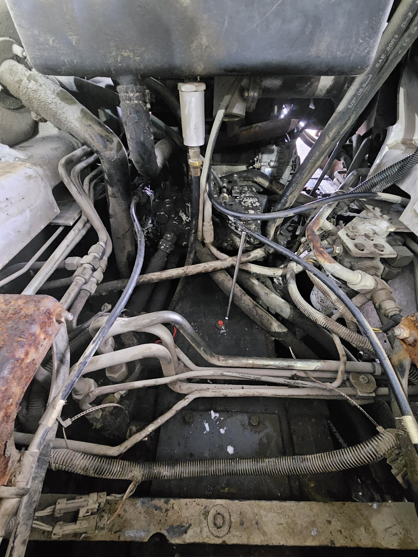

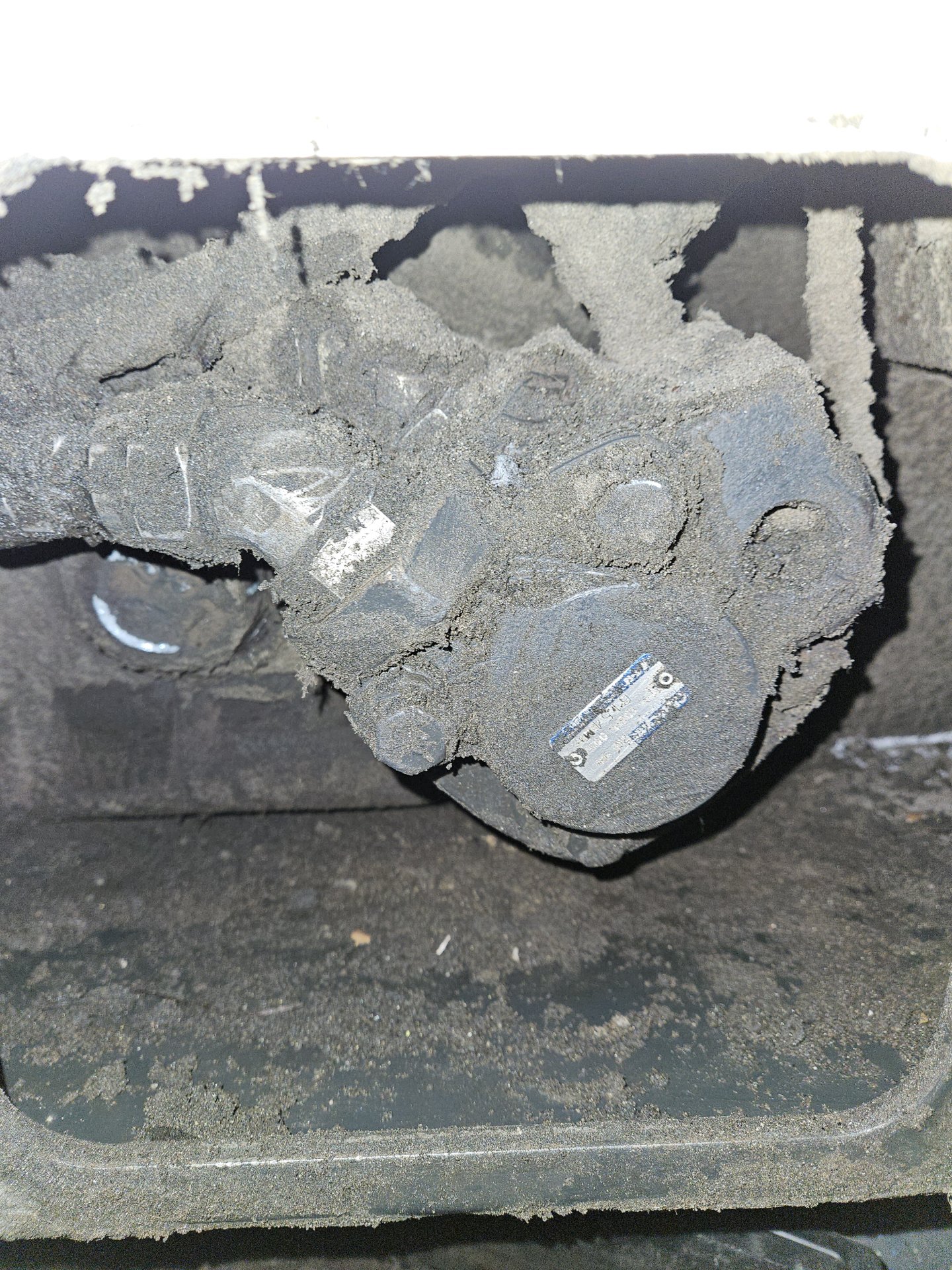

I then raised the cab of the machine and upon Inspecting the inside it looks as if it's never been cleaned. Lots of dirt, fluid and debris inside. I also notice I have a active leak coming from the tops of the hydraulic pump where the steering levers connect. I've read there is a sleeve and o-rings to replace there. The other active leak was coming from the hydraulic drive motor that's behind the missing covers between the wheels. Lots of sand and junk in there mixed with fluid laying in that compartment.
My next step is to give the machine a good cleaning , is it ok to pressure wash the hydraulic pumps and everywhere under the raised cab? More so a good degreasing and fanning of the pressure washer being careful not to infiltrate water into electrical connectors and such. I'm sure my drains are plugged as there's a inch of junk in those compartments behind the wheels. Also about washing under the main hydraulic pump between the fuel tank and hydro pump? Is there worry of getting water in the fuel tank?
Pic of dirty hydraulics compartment.

I degreased mine with simple green and careful use of a pressure sprayer without issue.

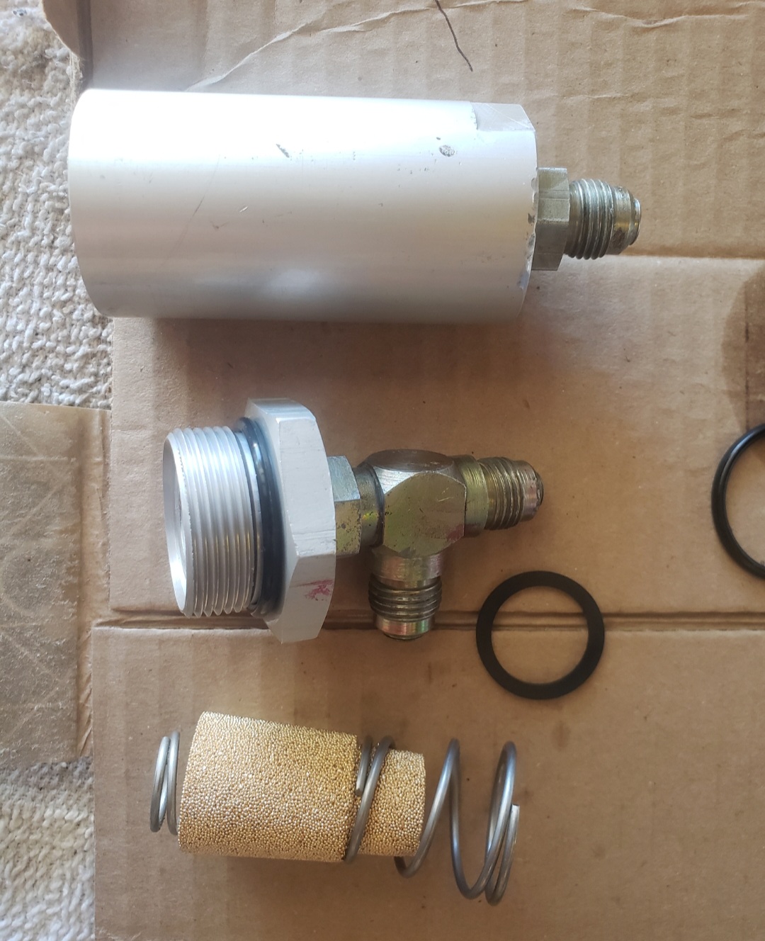

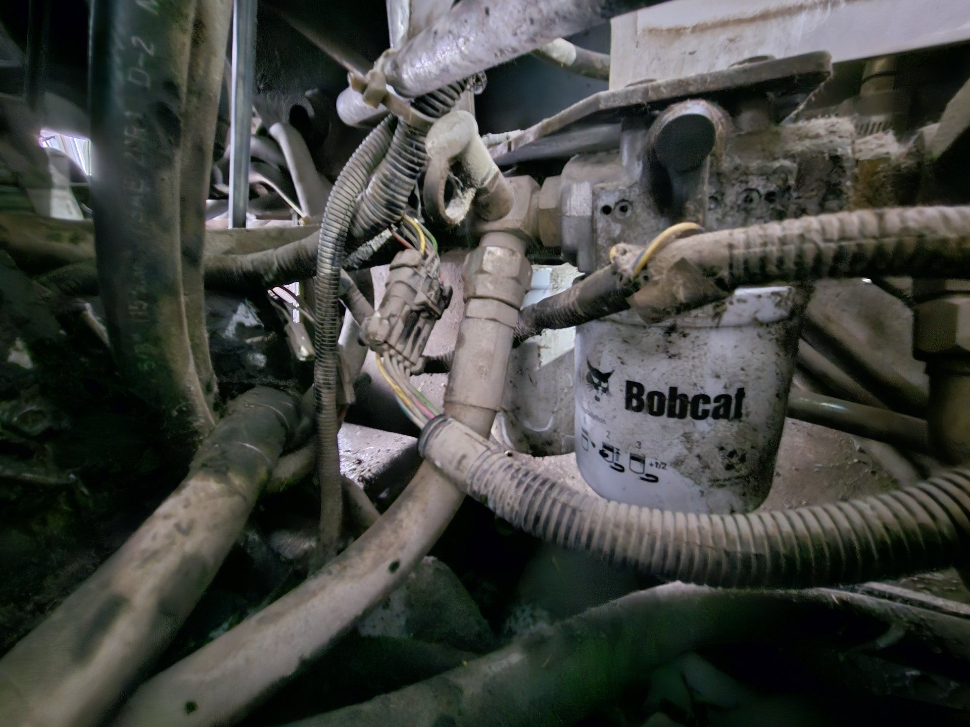

Hydraulic filters. You should have two other ones too. Do you see that silver aluminum in-line Hydraulic filter looks like it's straight out of the bottom of your Hydraulic tank? That is the filter too. Usually one of those to each side of drive. When I got my 863f they were clogged with sand! You can replace the element and O rings(2). See my attached picture of one apart.

Awesome, I'll definitely pull those out. One would assume you have to drain the hydraulic fluid reservoir prior to pulling those case drains... Or at least plug it. Maybe if the filters are in ok shape they can be cleaned with solvent and blown out.

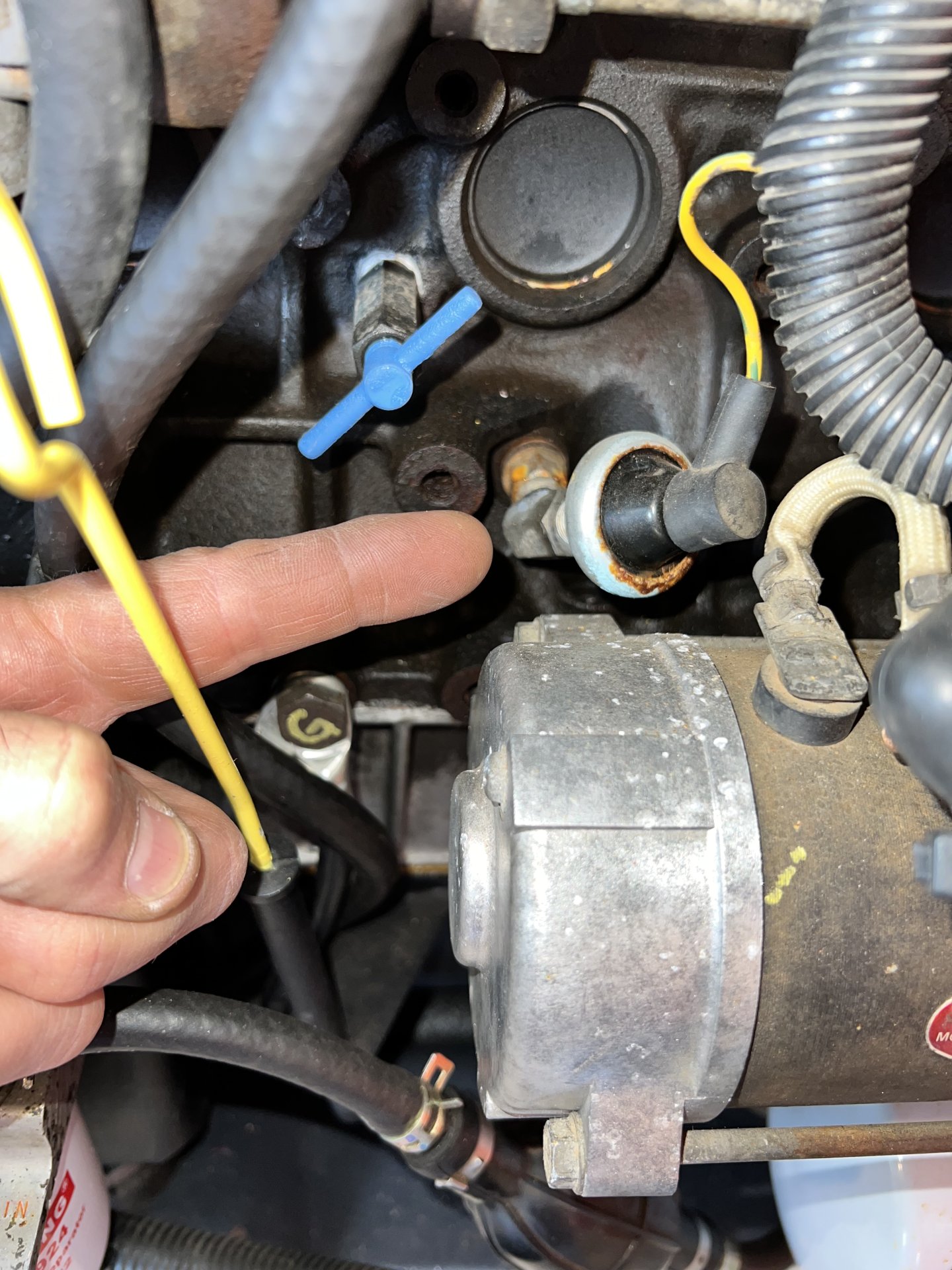

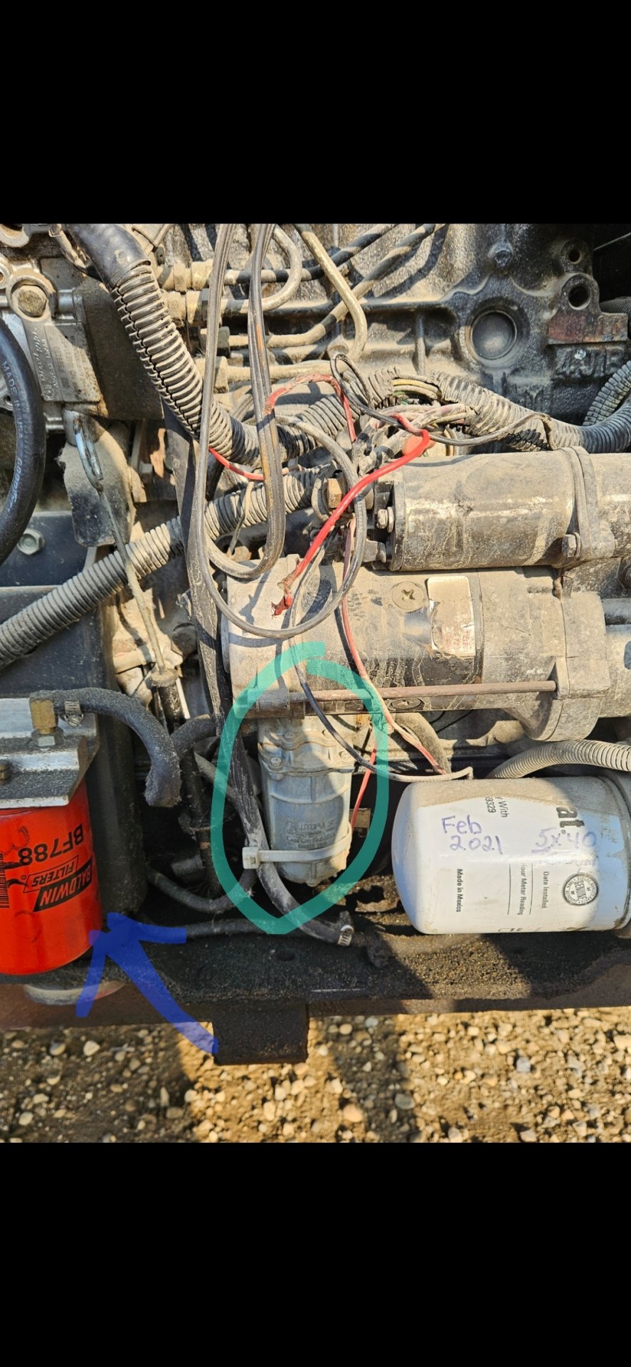

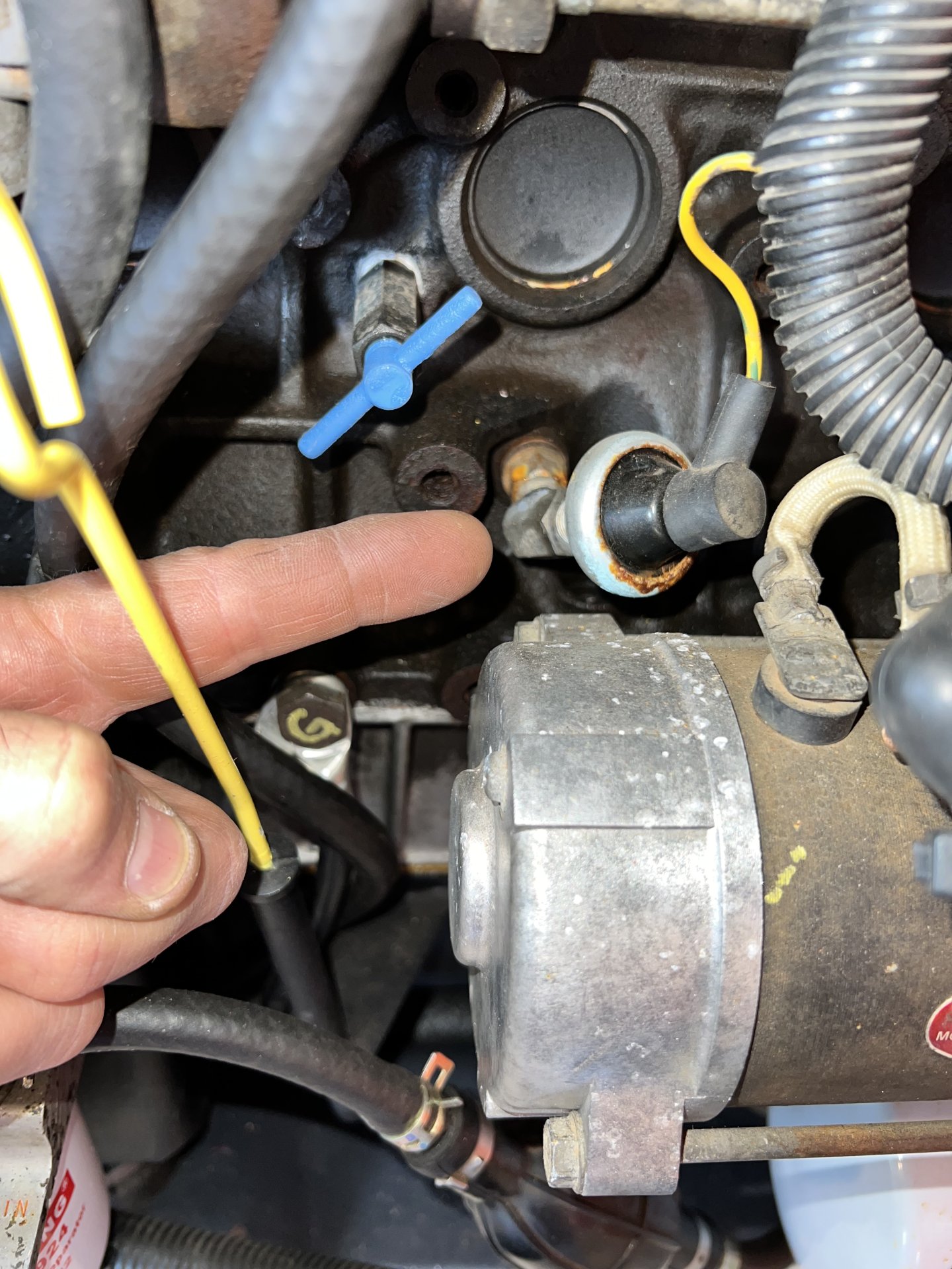

On a side note, does anyone know where the oil pressure sensor or switch is on that Isuzu motor?

Yeah you have to drain the tank to do the filters etc. I replaced the small inline filters but they do split apart, and I suppose you could clean the brass filter inside and reuse (I replaced). I went with AW-46 fluid but it takes 10-30 OEM. If you have to do any repairs between oil changes and need to drain the system, you could consider pouring it back in through a filter (that's what I did).

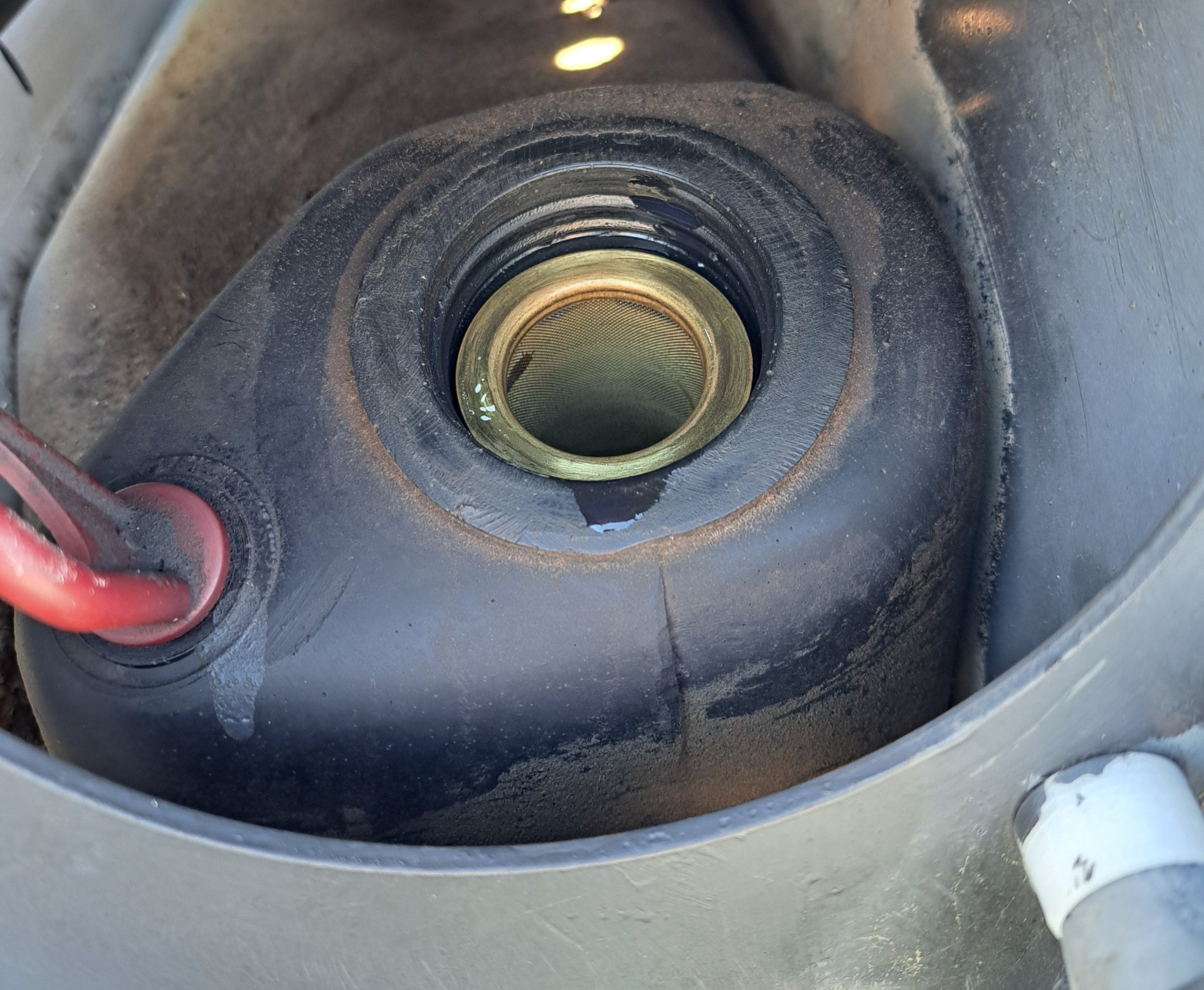

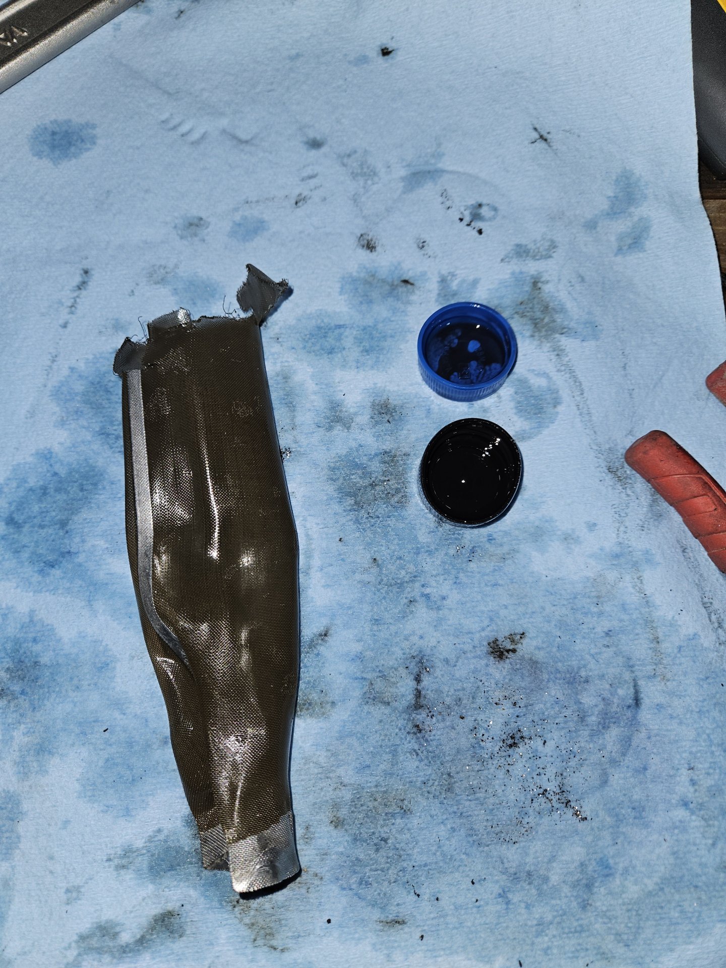

Ok did some work on it today. Bought myself a drill pump and sucked out the hydraulic reservoir. On the bottom of the tank I noticed the sock filter was laying there. I was wondering where it went.... Also inside of the sock was 2 caps from old oil bottles. This had me worried maybe another cap could be sitting in the tank or even sucked into that large hose going to the hydraulic pump. Tomorrow I'll remove the tank and inspect..

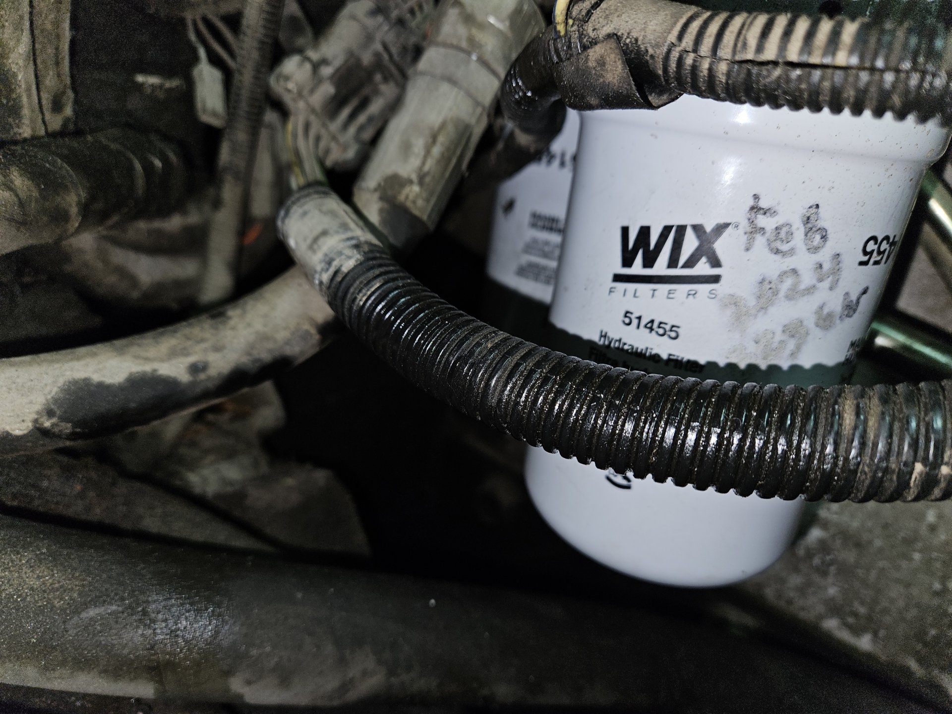

I also changed the hydraulic filters. One was a different size than the other. But I replaced them with 2 Wix filters.

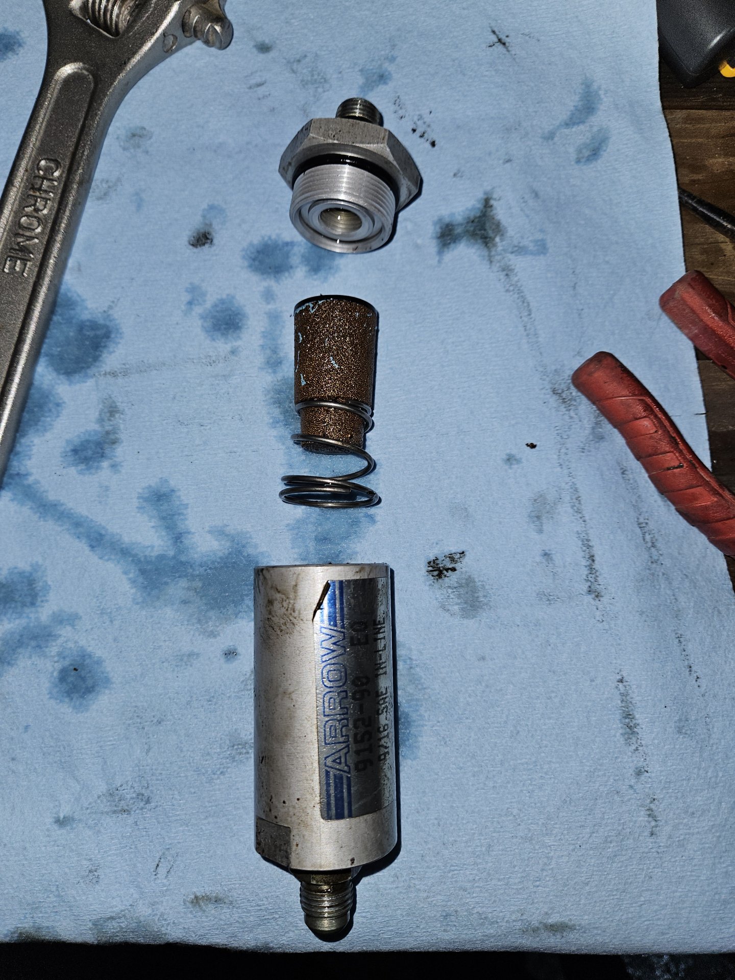

I also removed the one case filter from the bottom of the reservoir. I opted to clean it out and blow out with air. There was some strange blue material on the bronze filter. 🤷‍♂️

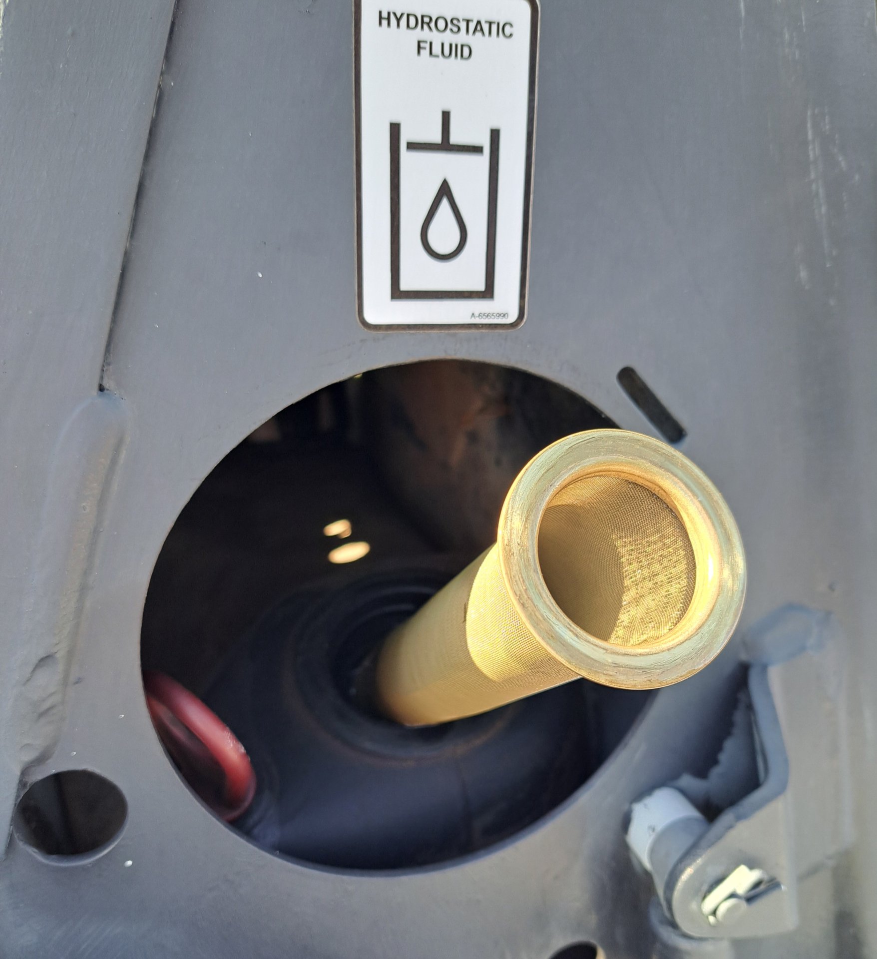

I bet small pieces of the blue cap were in filter. The very top of my Hydraulic tank has the screen/sock with a large ring . Is yours missing ? Is the top ring there and sock fell in tank?
Did you replace the o-rings on the in-line filter? Make sure they are Good. Did you check for a second in-line filter? If you have a second one I would be it is on the left side. Right if you are looking from seat towards rear.
Yes my sock and large ring are gone. I'm wondering if the ring is in the tank, it's hard to see in there with a flash light. I'm going to pull the tank and maybe slosh some diesel around in it to clean it out and inspect. That's a good call about the blue particles in the filter.

Also yes I did see the other case drain, it's down deep under the large hydraulic hoses leading to the left side drive motor. I'll be pulling that today.
Here are pictures of my Hydraulic screen for the tank. Looking at it I would guess the ring was tossed. It is larger than the fill hole. So it should not be in the tank.

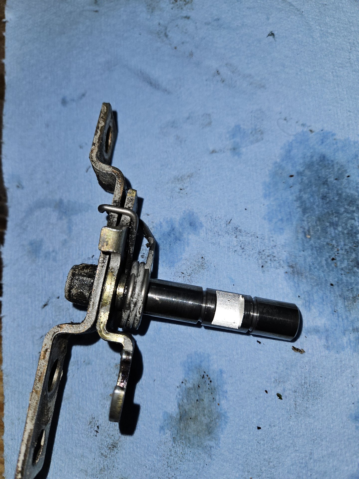

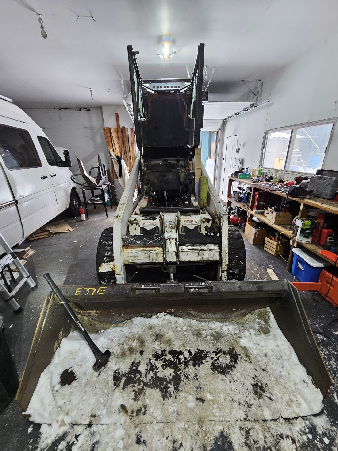

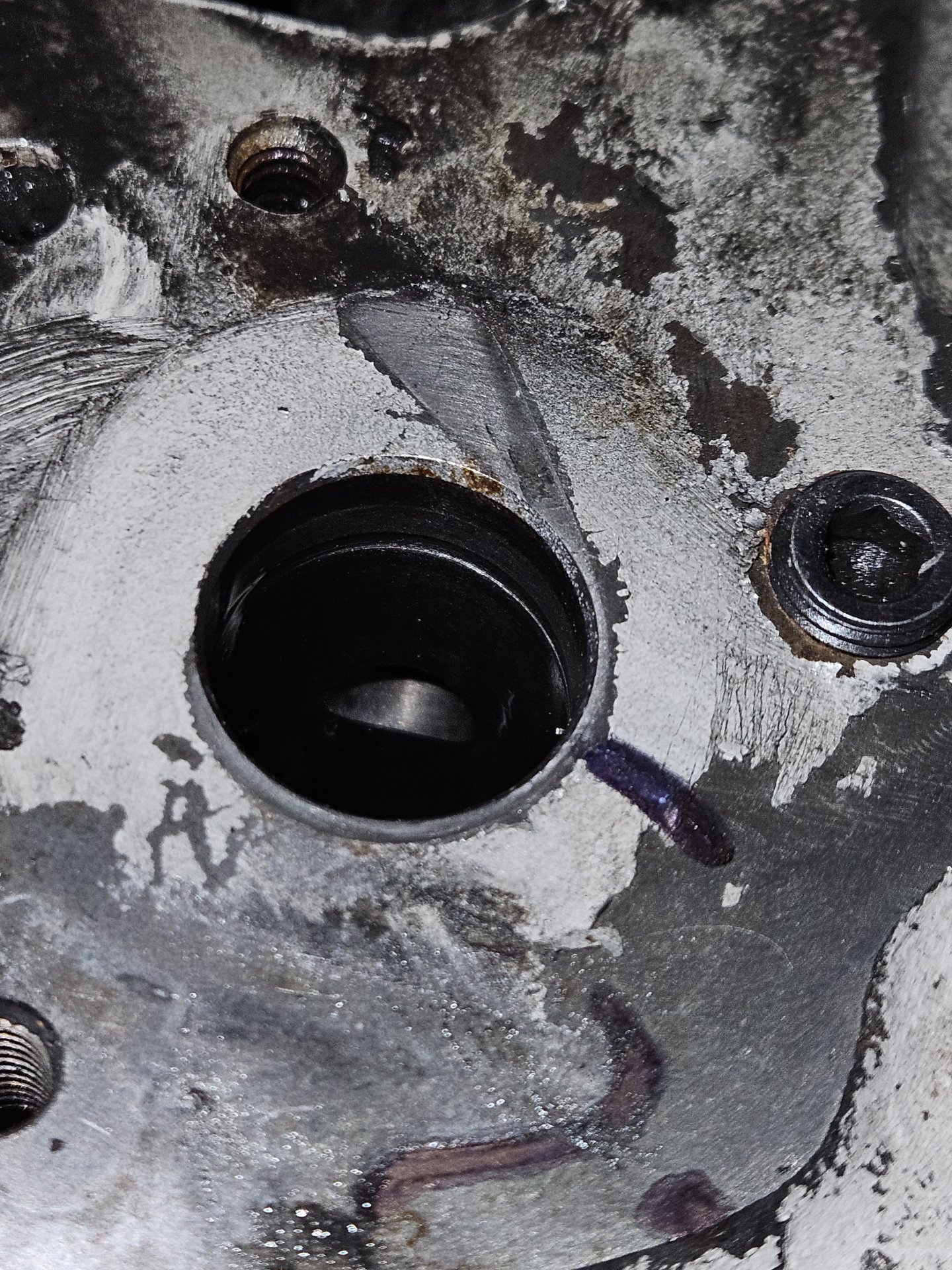

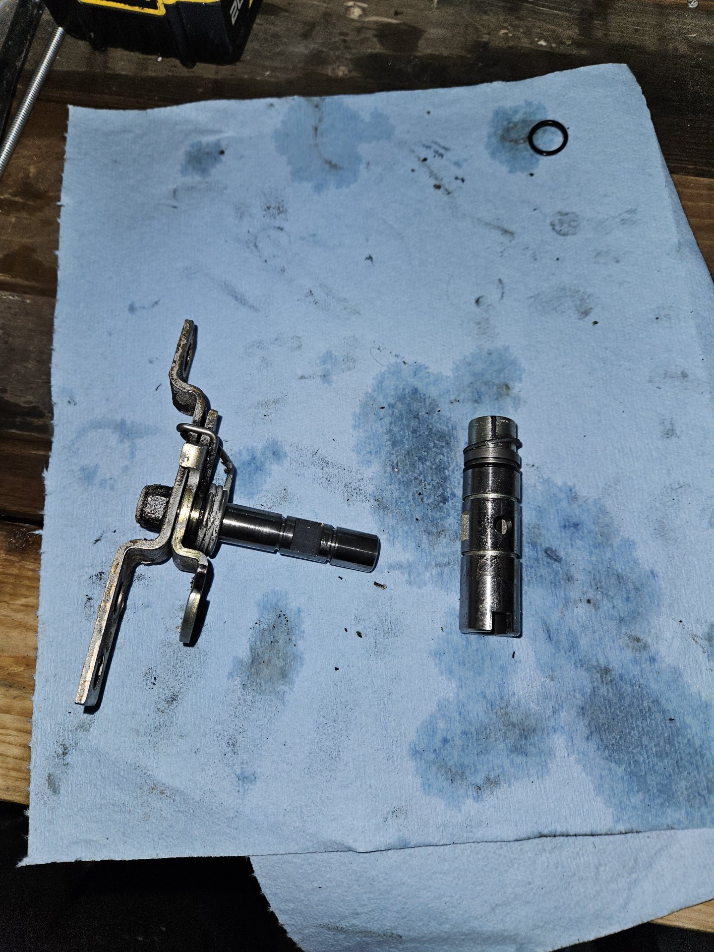

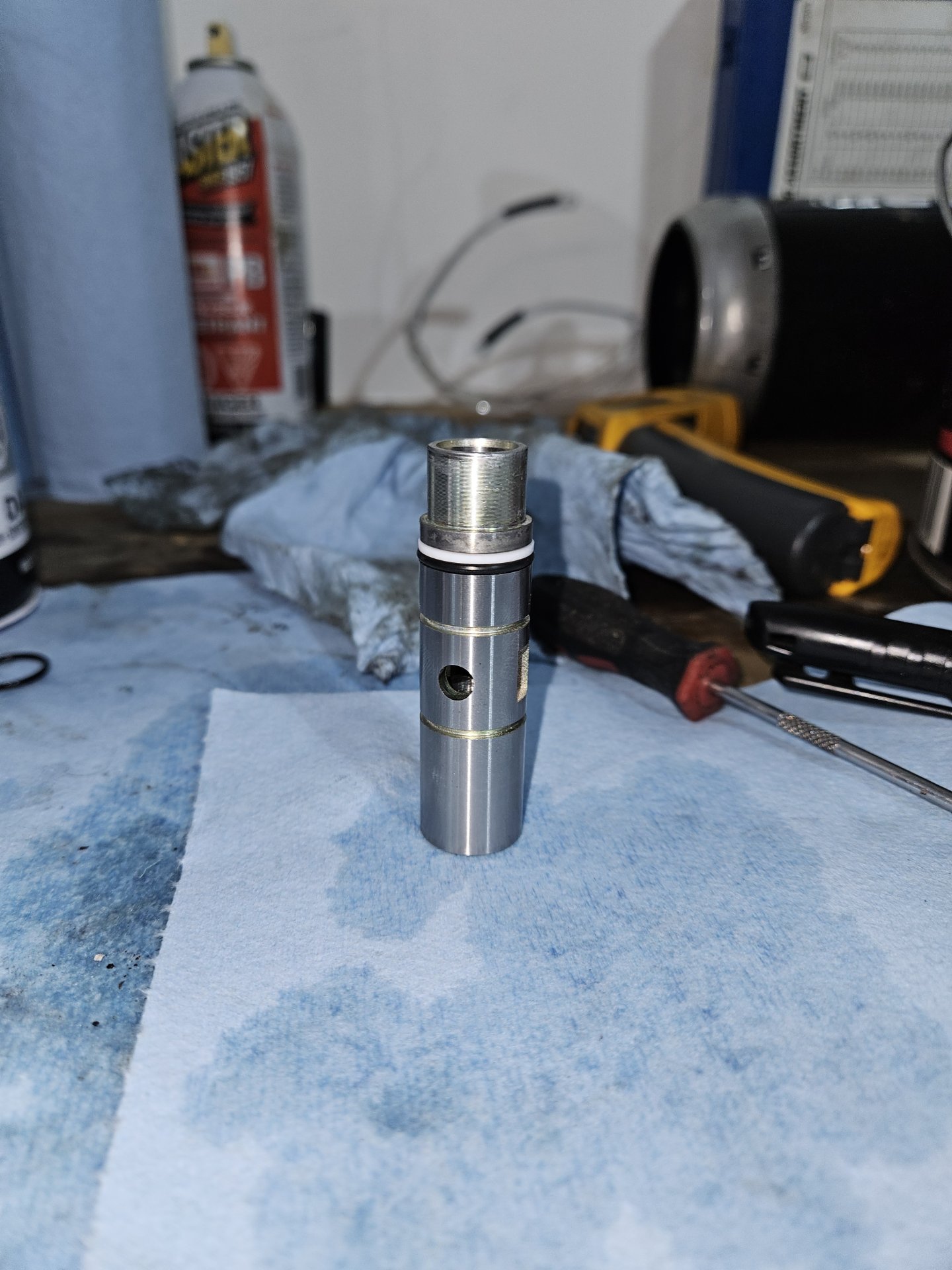

Got around to getting the 2nd case drain out. It was pretty clean so I just blew it out and cleaned with solvent. I ended up pulling the hydraulic tank to clean that out as well, there was no additional oils caps inside 😂
Next I removed the servo spools and o-rings. They both came out easily, I opted to do the double oring method but unfortunately the top oring rolled over its lip on the sleeve and tore going back in. I think tomorrow I'll get some Vaseline and maybe slightly cool the sleeve and oring in the freezer.
Is this groove supposed to be machined in the pump housing or is this the outcome of grit getting in there and wearing it out (hence the servo spool fix kit you can buy)
