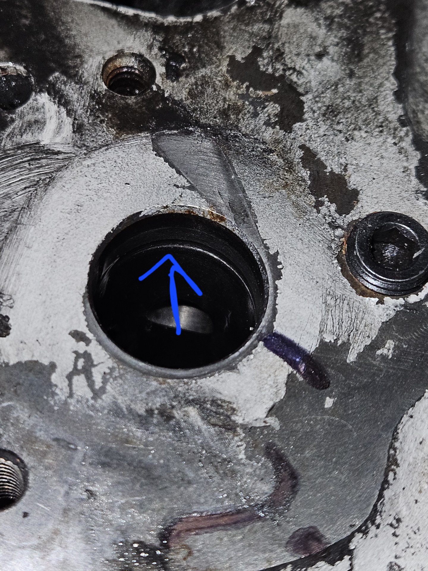

The groove: if you are referring to that triangular shaped raw metal in your picture, is likely from the neutral return spring rubbing against the housing.

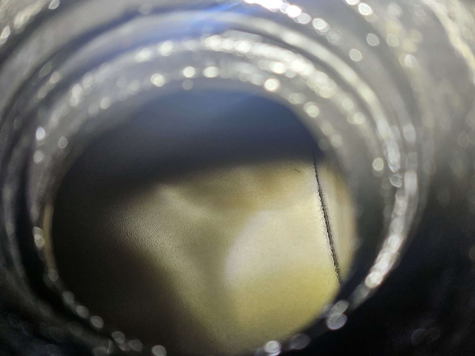

Also this is the groove I was mentioning, that's probably machined from factory? Just seems strange because the service bulletin in the document says the new sleeve places the oring 0.05" below to seal on a new surface of the bore.

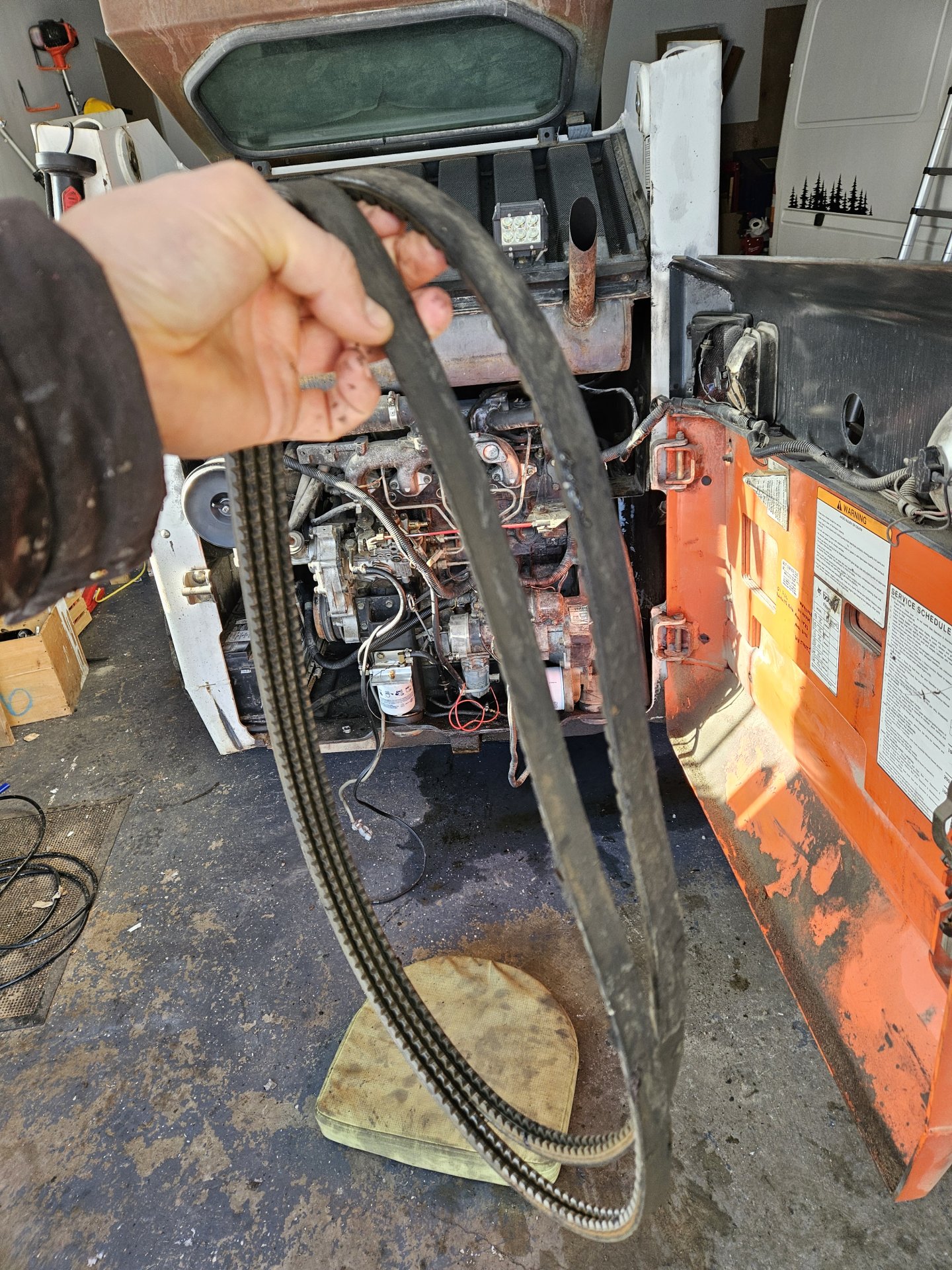

Also replaced the drive belt, it had a big split down the middle and was cracked all through the underside.

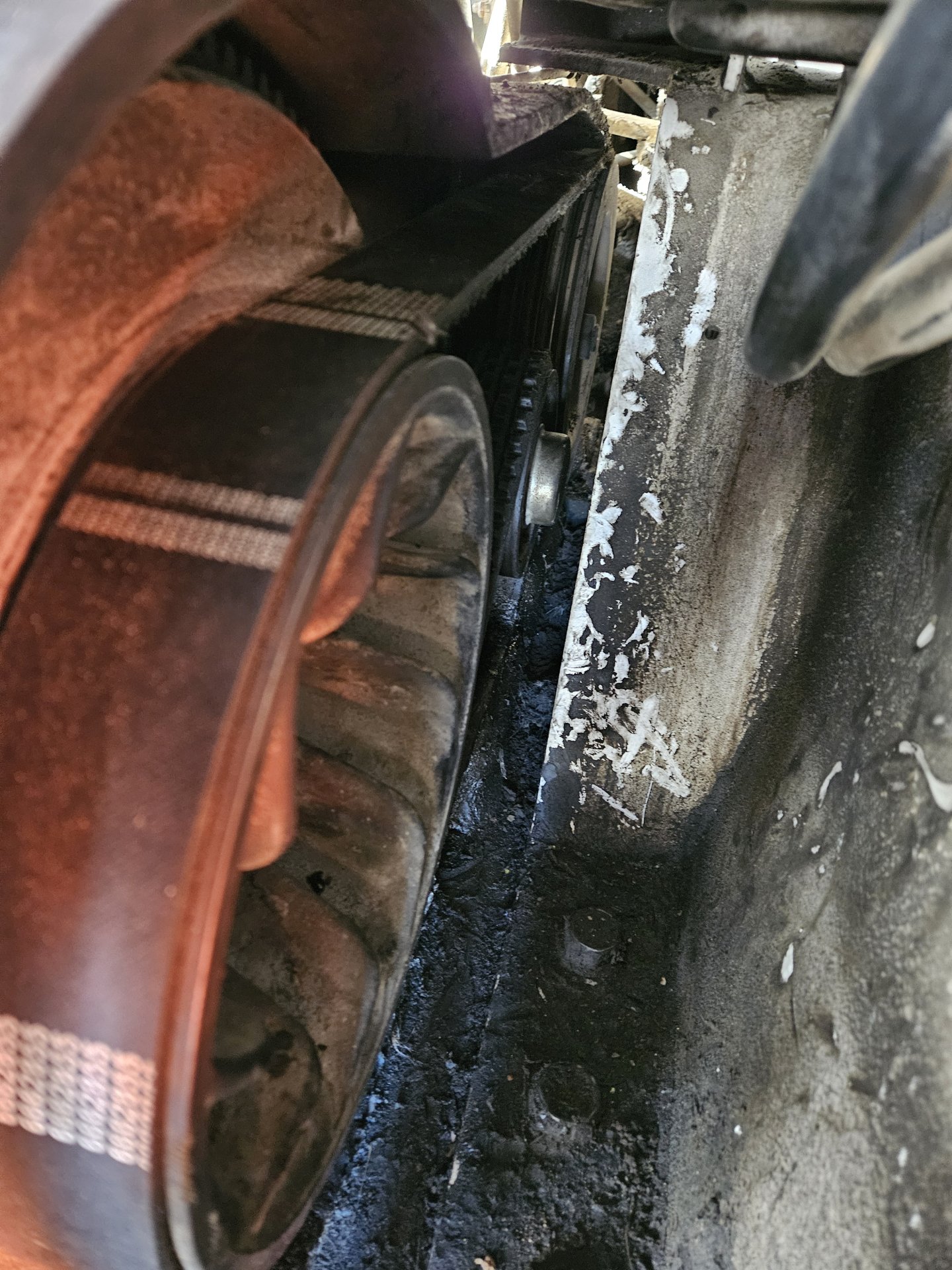

Installing the new one was a PITA. But I managed to get in on and tensioned. The manual talks about a spring loaded tensioner. I did not have that so I just tightened it snug with about 1/2 or so play.
The small tensioner in center, isn't it spring loaded or not? I know they have two types of "Tensioners" for those years.
