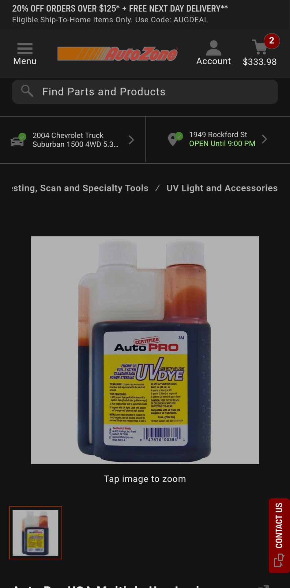

This is the type dye you will need. Also you will need a good uv light, and the uv glass. You don't have to have this brand specifically, just this type. Add 1oz per 1 gallon of fluid. Equipment manufacturers don't make there own oil, they have it made to there specs. Any oil that meets api specs (moat name brands) will work just fine. Everybody has there favorite go to fluid. As long as you use the proper weight for your usage (temp)you will fine.

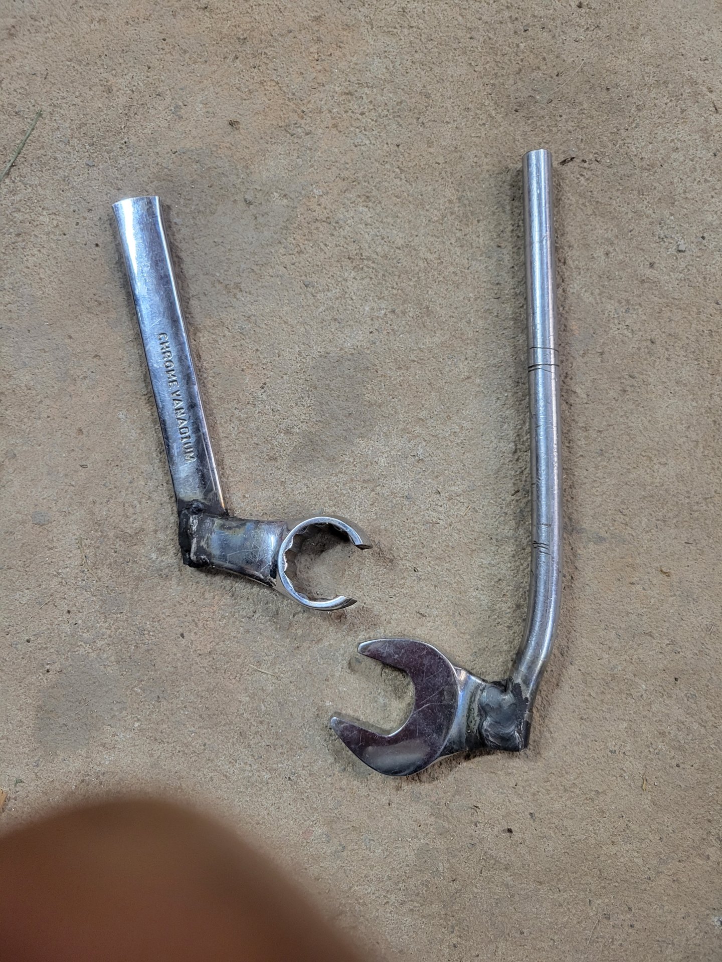

When I bought my 743 it had been sitting for 5-6 years because of a blown hose and had been leaking at the valves. Thinking at first it was the valves leaking they never took time to repair it. Then a few years later that hose blew. He couldn't find anyone that would replace the hose and not wanting to take it to bobcat, he parked it. It sat for all those years when I bought it for a song. NOW let me tell you that hose was something to change!!! I had to make a wrench to get it off and my then 10yr son was the only 1 of 4 of us that could get 2 hands in there to remove it or install it. I don't know how bobcat does it except by removing the pumps. I don't remember what the other part was it connected to, but it made it look like the valve was leaking. After the repair the valves weren't leaking after all. It's a short hose about 16" long that makes a u down from 1 to the other. Look close at it when you are searching for your leak.

The OP can google "nightmare hose bobcat" and it should lead to the thread here. My post tells how I tackled it. Halfway thru I was thinking about torching an access door tho. Lol
That's why is was asking GeorgeG which machine he was referring to. I've done 4 of those since I first did mine is was just curious what he was talking about. Because like you said there is no door though the chain case on a 743 and the valve sits between the tires not in the behind the rear. I think he meant some other brand. I've not seen a access door though the chain case on any bobcat. May be wrong ????

I won't do another one!!!
And won't take a $100 for the wrench I made. Time for someone else to do them!!!
when we repaired the old 743 we had to make several wrenches and sockets, seems every time we tried to fix a peak we needed a special wrench, most we cut a standard wrench and bent it to get in the space, not sure how the dealer does it but in some cases it was easier to remove the motor
