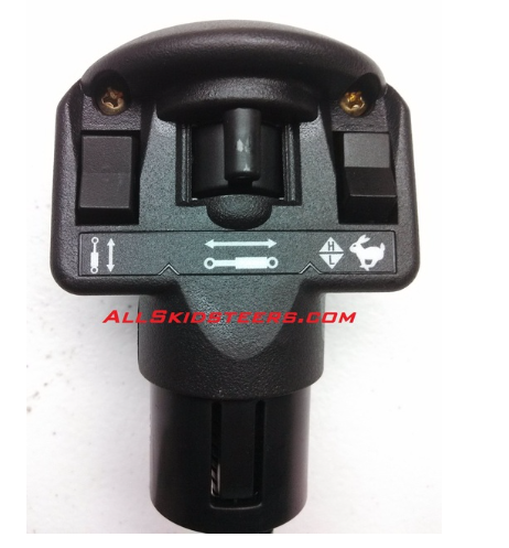

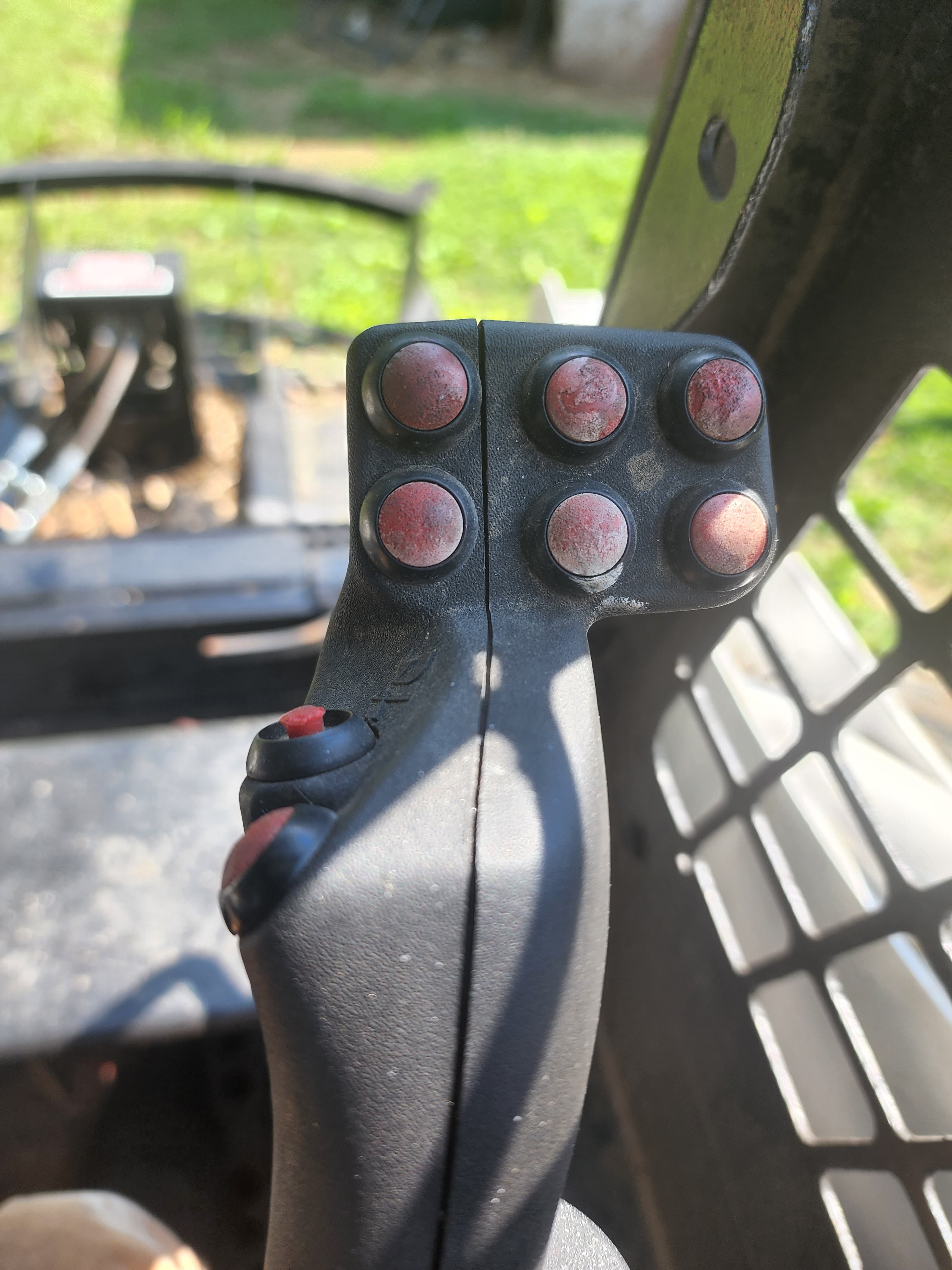

The way it should work if you had the correct handle. Press the aux button, then pull the right hand index trigger to engage the hydraulic flow to the cutter. If the blade is spinning in the incorrect direction, then the top paddle with the side to side arrows can reverse the flow direction.
When my brush cutter was made, the hose couplings were on the incorrect hoses. So when I pulled the trigger, it spun backwards. I used the paddle switch to simply reverse the blade to the proper direction. But I ended up just swapping the couplers to the opposite hoses, so I only need to hit the index trigger to engage the blade in the proper
When my brush cutter was made, the hose couplings were on the incorrect hoses. So when I pulled the trigger, it spun backwards. I used the paddle switch to simply reverse the blade to the proper direction. But I ended up just swapping the couplers to the opposite hoses, so I only need to hit the index trigger to engage the blade in the proper direction.

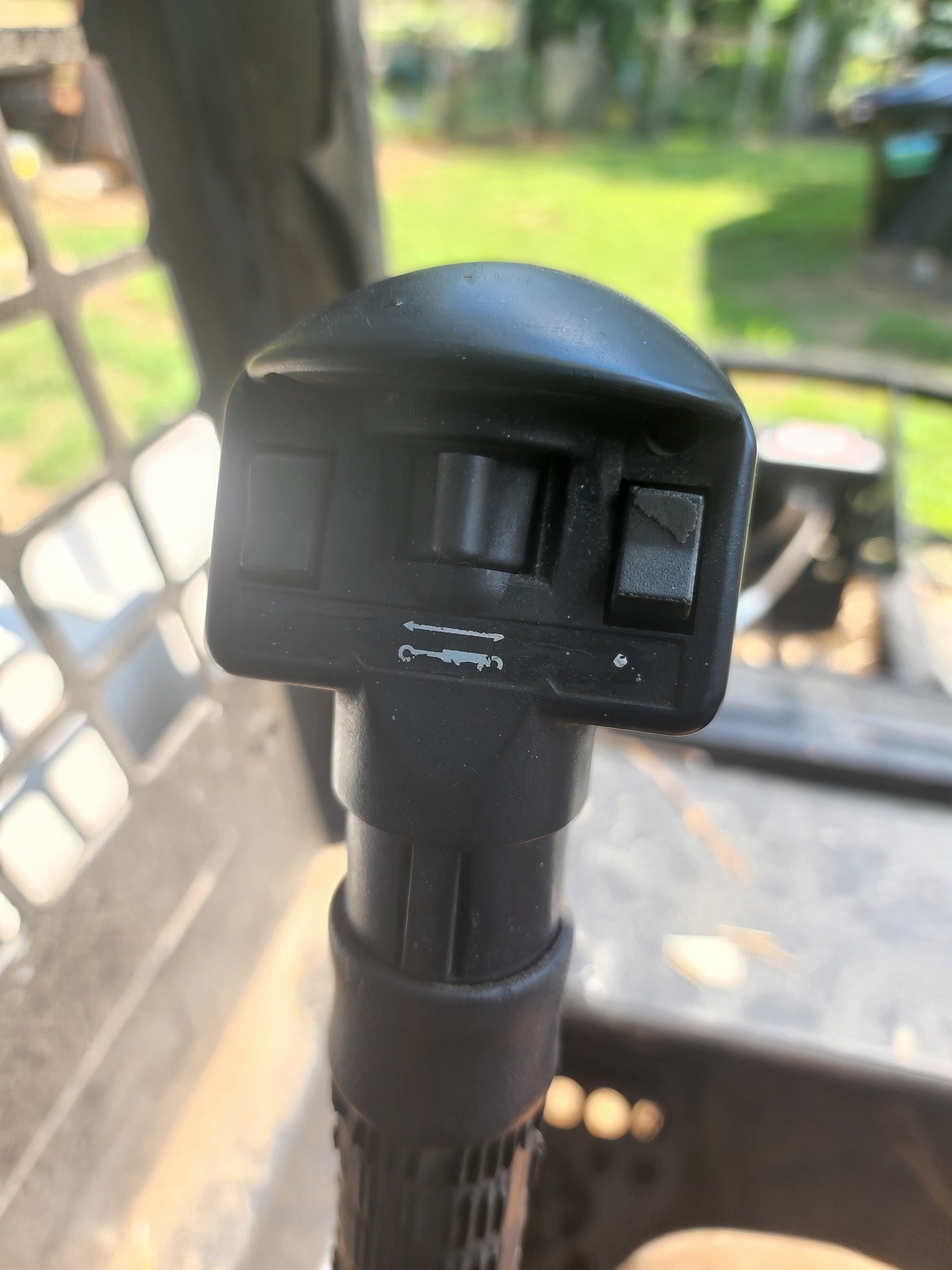

Firstly find out, for sure, if your machine has hi-flo before going any farther! As I said before lift the cab & check for the aux. pump. Secondly, an 863G puts out about 18gpm @ standard flow & will run your brush cutter. Mine worked quite well but you have to remember.....more throttle= more flow.Thanks Koko for your advice, so your right hand control looks like the picture above. Last night I find out the Auxiliary fuse was empty thought that was the problem but no. Later today I'm going to check the right hand control and check the wire. It look like the picture about have the continuous flow button, I problem need that button for my brush cutter to get fully engaged is that true. ???

Thanks KoKo, I have no idea about the hi flow pump. I have a bobcat 873 advantage g series.Firstly find out, for sure, if your machine has hi-flo before going any farther! As I said before lift the cab & check for the aux. pump. Secondly, an 863G puts out about 18gpm @ standard flow & will run your brush cutter. Mine worked quite well but you have to remember.....more throttle= more flow.
