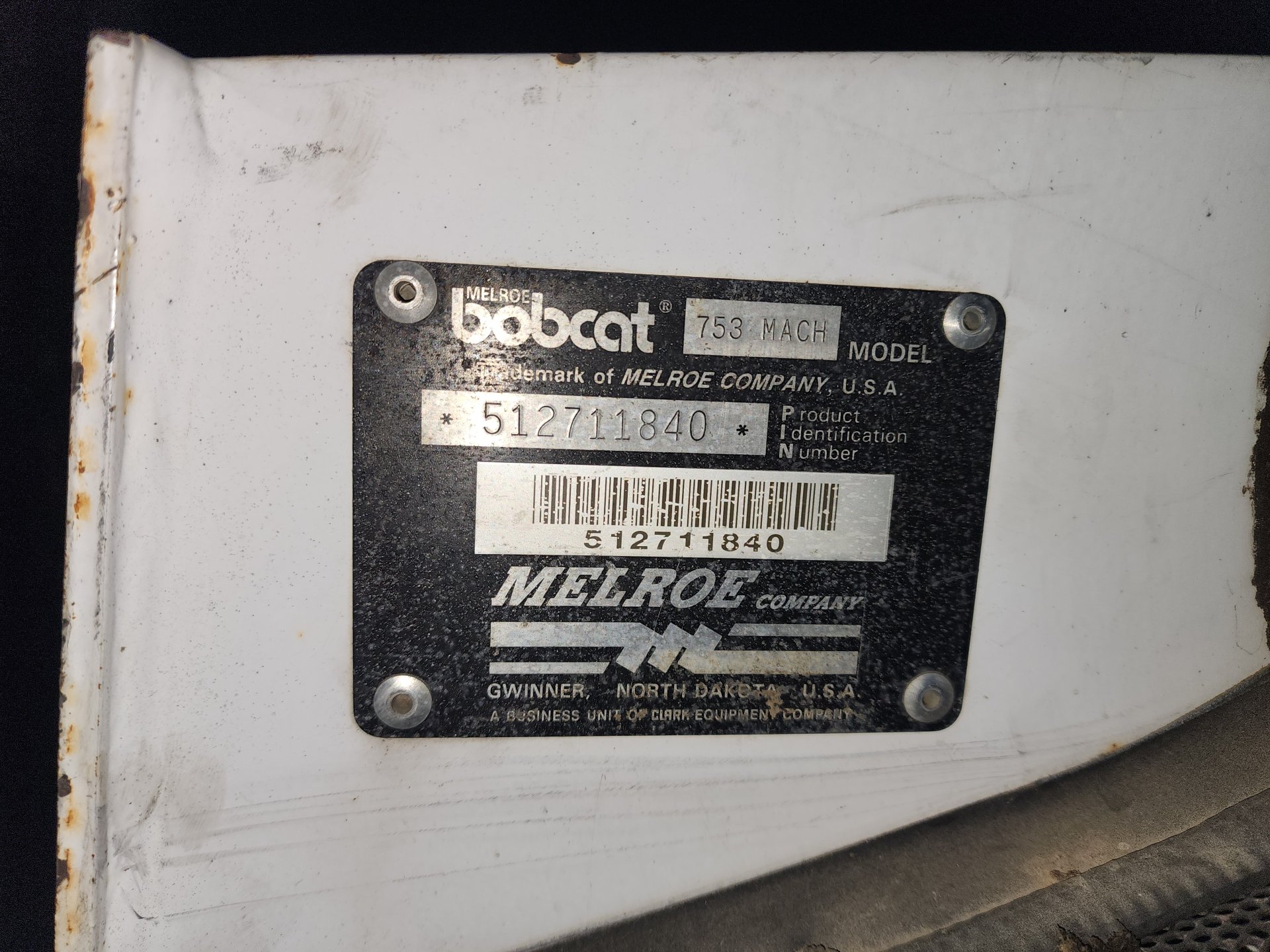

Check out Bobcats website. Put in your model and narrow the search with that serial (P.I.N.) number. Then you can look at your machines schematic. Find where the pressure switch should be.
Just a note, see if you have TWO hydraulic in-line filters. You mentioned you changed or cleaned One. Usually TWO on those skidsteers. I see TWO on your schematic. Items #31.
