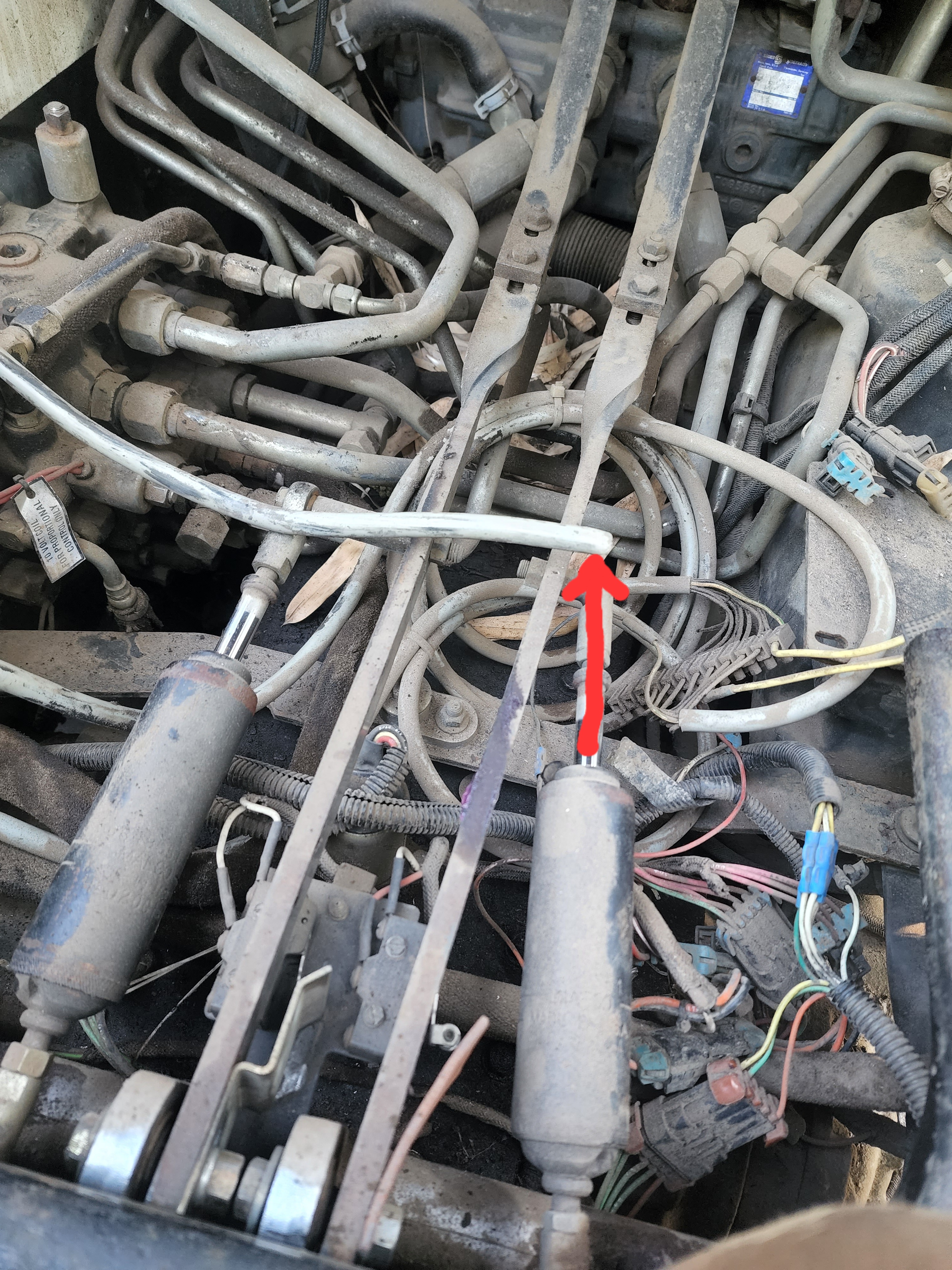

Well guys bad news the right hand control is not even wire. Just order a manual book for 873 and 883 g series book hopefully it have the wire diagram. Does any body have a picture on the right hand control?

Thanks reaperman but I already try that no luck. Yeah the brush cutter goes counter clockwise which to the left still no fully engage. Lol can't even cut a 1 to 1 1/2 tree.
The right handle control don't even exit because is not wire in. Talk to the dealer CID told to me to take the H valve off but just be careful not to reverse the hydraulic or else it will messy it up. YEAH NOTHING.
Right the left handle control engage the brush cutter but not fully engage. Hummm it suck
Sorry as for right now the left handle control engage the auxiliary but no fully speed.
Thanks Koko for your advice, so your right hand control looks like the picture above. Last night I find out the Auxiliary fuse was empty thought that was the problem but no. Later today I'm going to check the right hand control and check the wire. It look like the picture about have the continuous flow button, I problem need that button for my brush cutter to get fully engaged is that true. ???

Does anybody have a bobcat g series 873. I would like to have a picture of the right handle control harness (male and female wire color)
Google 'bobcat historical specs" and from there you can go to a link where you put in your serial number & you will get a diagram & part number of absolutely everything that your machine is built of!
Updated drop the bobcat off to the dealer. The service replace the valve don't know what valve was replace. They told me the hydraulic control valve pump has a crack might need to replace the pump. Let's hope the auxillary work for the brush cutter.
The Bobcat dealership told me the Service Control Valve is leaking internal and is not holding pressure. I have to purchase a new service control valve, can I rebuild the the control valve by replace all the seal.
