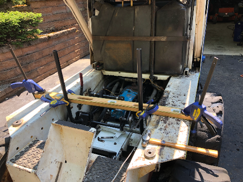

I just wanted to share my creep adjustment technique for anyone else struggling to get their neutral set.
Here is a picture of my setup.
I clamp a 4 foot level across the machine and then clamp the sticks to the level. While the neutral blocks are slightly loose I can use a hammer to tap the level near the sticks to get neutral set.
Then I use a small pry bar or a long screw driver to make sure I am pressing the alignment bar to the cams as I tighten them down.
I do the back pintle first which is the left side wheels on my machine. The right is usually more of a struggle because for some reason the cam action of tightening the bar makes it move in reverse slightly when I remove my clamps. So I just try and estimate the same reverse creep and tap the level so my right side creeps forward the same speed and then tighten the bar down and it seems to get me perfectly neutral.
Make sure to not have the long part of the clamp bars pointing down or you risk having it get caught on your tire (ask me how I know (thankful for foam filled tires)). Hope this helps someone.
Interesting way of getting around it, glad it worked well for you. I'm with you on using a hammer for fine adjustment, it have had to do the same thing.
