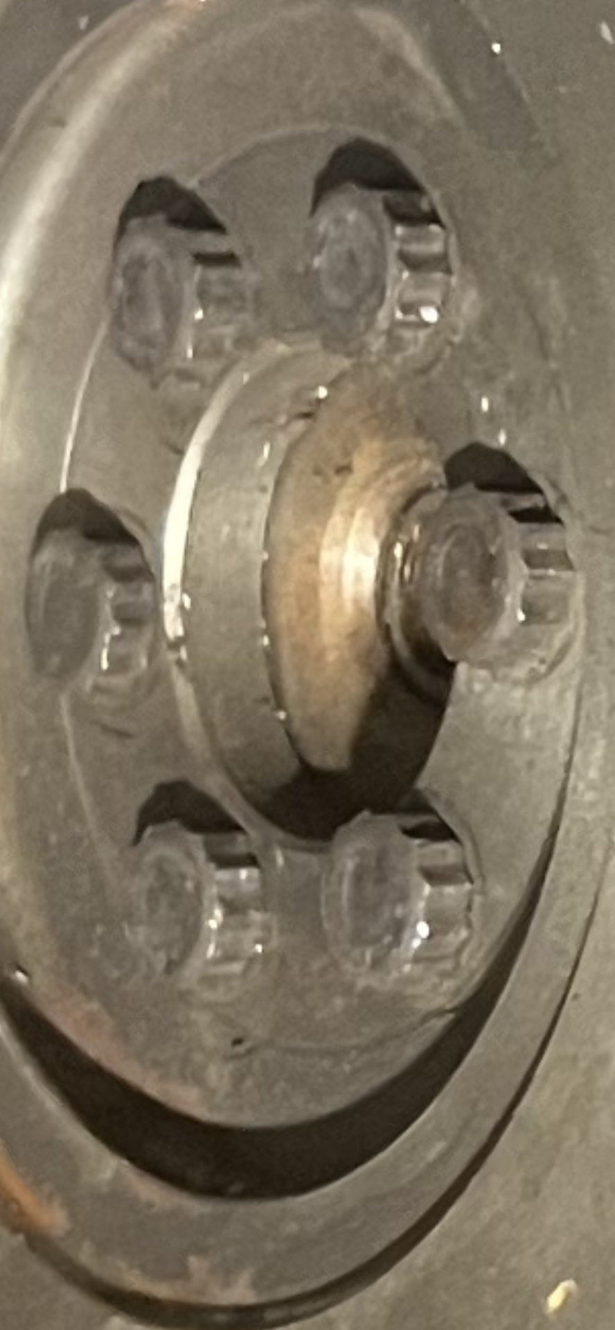

As I recall, the heads of the bolts were fairly thin / shallow. I went and got my 6 point impact socket so as not to accidently round the heads of the bolts off. They came out fine but I made sure I was on them good and square.
Definitely will be careful with those strange looking bolt heads, thanks Randy!
Thinking back, I'm pretty sure mine were 12 point. Foggy memory there, can't swear to it.
I'm not great with the memory either. You may be right. I know I stopped with the tool I had as it did not fit well enough. I came back with a socket that fit good and had no problem.
I just looked back at his pic a few posts ago, definitely 12 point. YAY my brain still works!
Pic attached - bit confused on what socket to get .. 12 points? Thanks!
