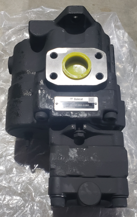

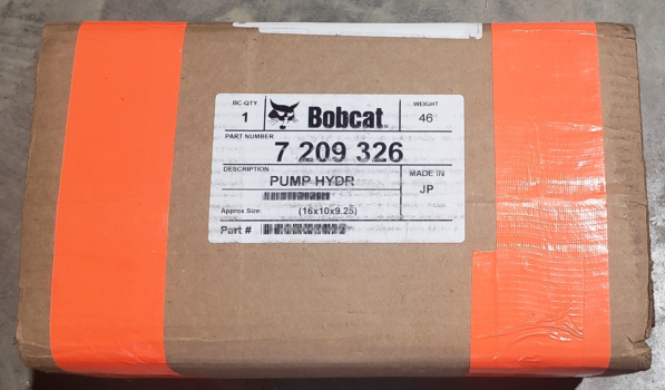

My dealer managed to get a new pump in last week! There was a waiting list for the pump, but I was on top...
This was one well secured package. Thick cardboard over wood framing. They are very generous with those massive shipper's staples.
I wonder how much machining debris is in the pump? My plan is to run the current filters and hydraulic fluid for a few hours and change everything out. Necessary?

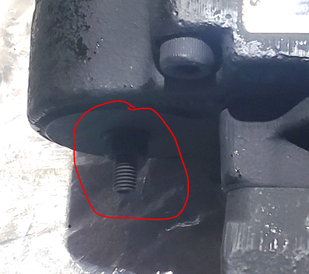

have it turned back down if you get a replacement pump.
I checked with the Bobcat Service Manager and he said the pressure regulator is built into the pump. Controlled by this nut...
It is set correctly from the factory, so a new pump is ready to go.
