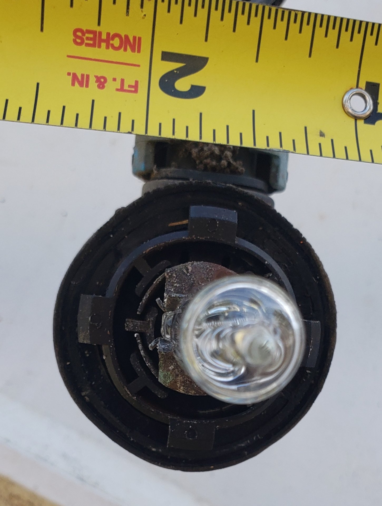

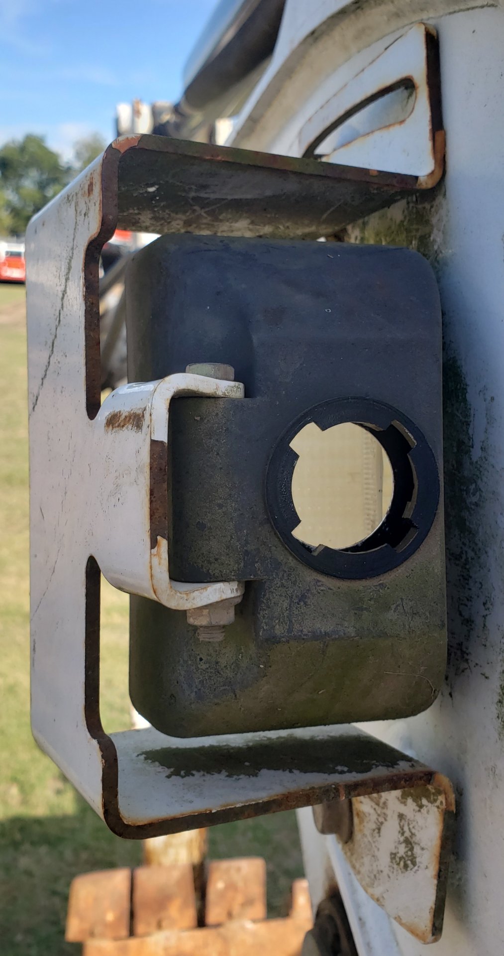

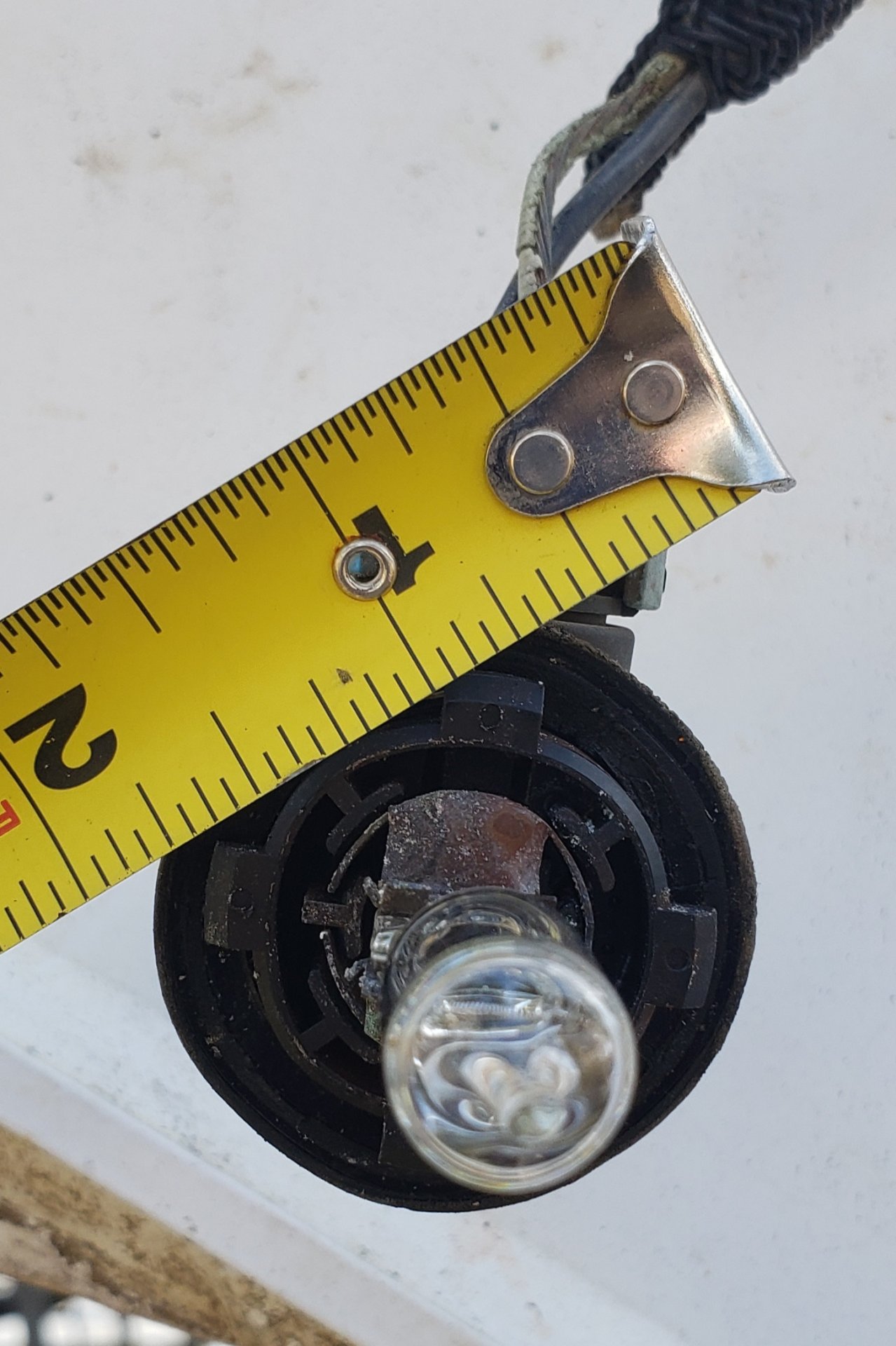

Most recent effort is a replacement bulb for my boom light. They've superseded the replacement socket/pigtail/bulb (yes, 3 separate SKUs!) setup for a sealed housing light. Replacement cost: $75-85. So if your bulb goes out, you replace the whole sealed beam. Way to be environmentally conscience Bobcat.
This appears to be a "standard" automotive-style, 1/4 turn, socket. One difference is that it is a 4 "prong" as opposed to a more common 2 or 3 prong.
Change it out for a led work light off Amazon. Better light, lasts longer and cheap. May have to drill a new mount hole depending on which light you go with but it will provide a nice upgrade.
I used the supplied connector and plugged right into a HID bulb from an SUV. It was a two-prong, but I managed to wedge it in tight enough to hold it. Not a great solution, but suitable. I didn't want to modify the factory wiring, but might decide otherwise in the future.
