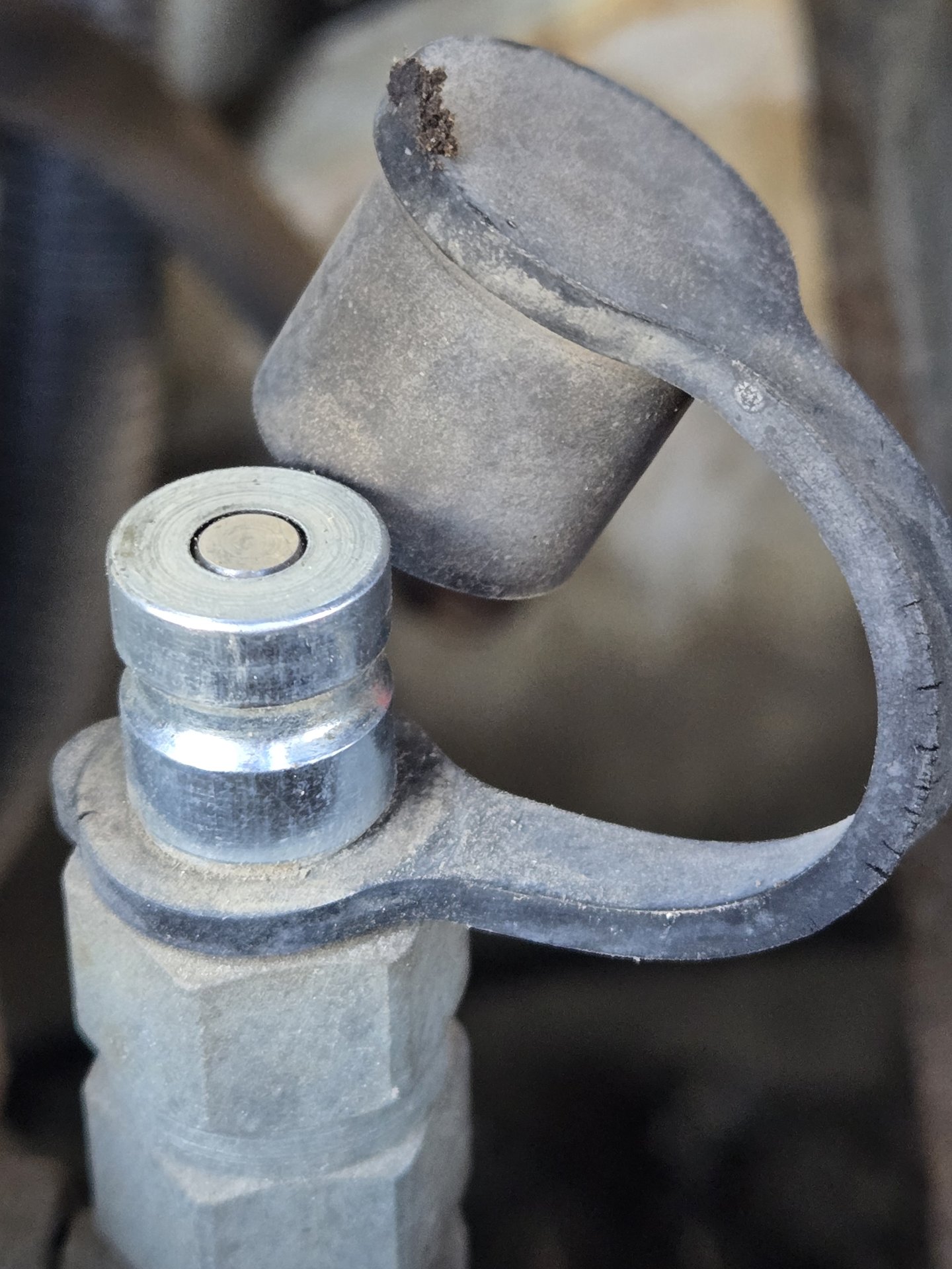

Trying to verify the test port on a 335 is a "Dixon 1PDF2....(1/4" NPT on backside)"
I would need 1/4" npt female to female hose and that would get me started? With a 5000psi gauge?
Also was wondering if I could test pressure out of the control valve for my left track, and then at the motor. Wouldn't a discrepancy show any swivel issues?
    381.8 KB
The test port is a Dixon 1PDF2.. It fits fine.
