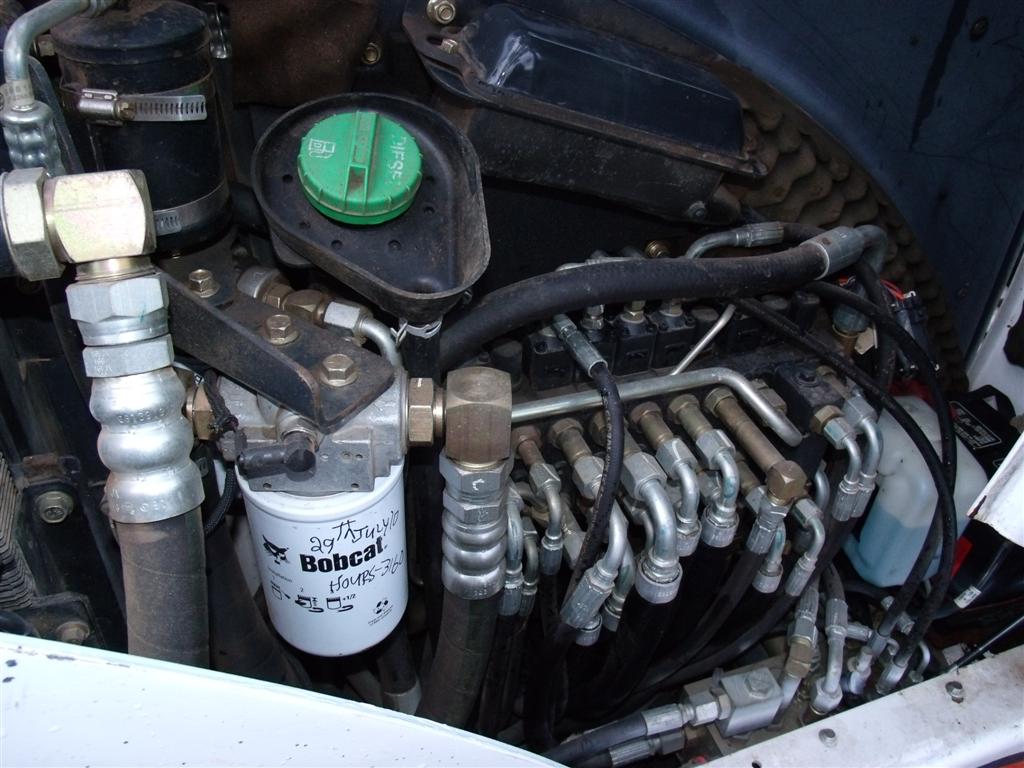

What type/year of machine do you have? Mine sits on a tray at the very front of hydraulic compartment. For some reason I don't have any new pics of that area, just an old one before I got busy cleaning and repainting. You can see top of battery in front of windshield washer fluid container.... APDC0489 (Large)
Its a 2003 341. I was wondering if that was the spot. It is the only area on mine big enough to hold a battery, but I don't see any clamps or trays it would have set in. Looks like a real pita to get to too.
Initially it was a PITA. Then, I realized the lid stop on the hyd compartment had two stops. I took out the first stop and now the lid opens past vertical...makes life so much easier if a battery needs attention. I pulled the lid off, battery tray and whatnot to repaint and fix where necessary. The tray bolts into the body on side and uses the two bolts of hinge. Can probably fab one easily enough. I'll eventually post a pic of how the lid opens now, and how easy it is to access everything...the previous pic is before I had a chance to remove the first stop....no idea why there are two stops...safety sakes in case one breaks? The gas spring works using the last stop.
