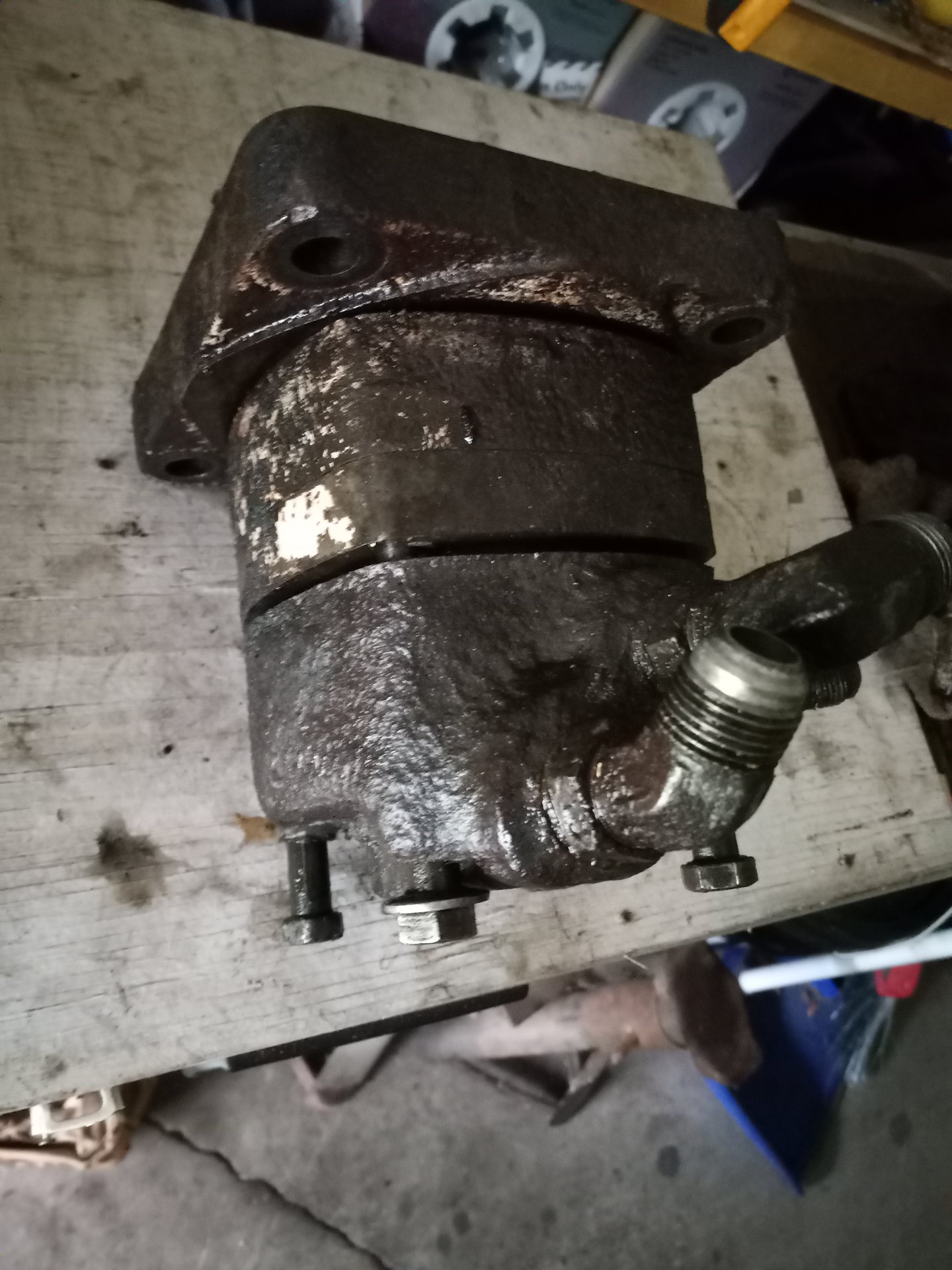

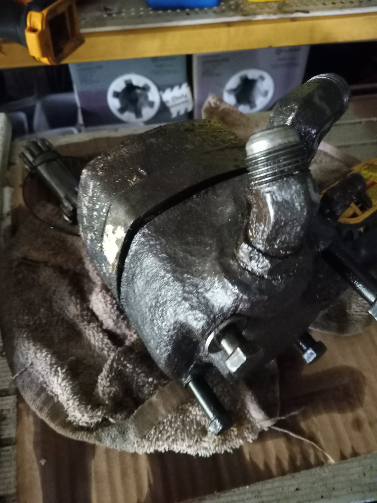

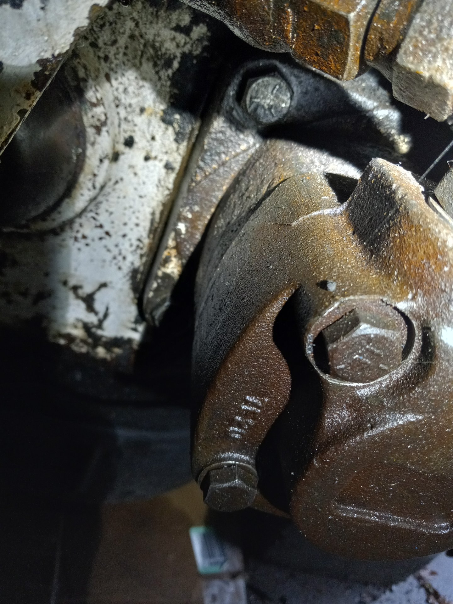

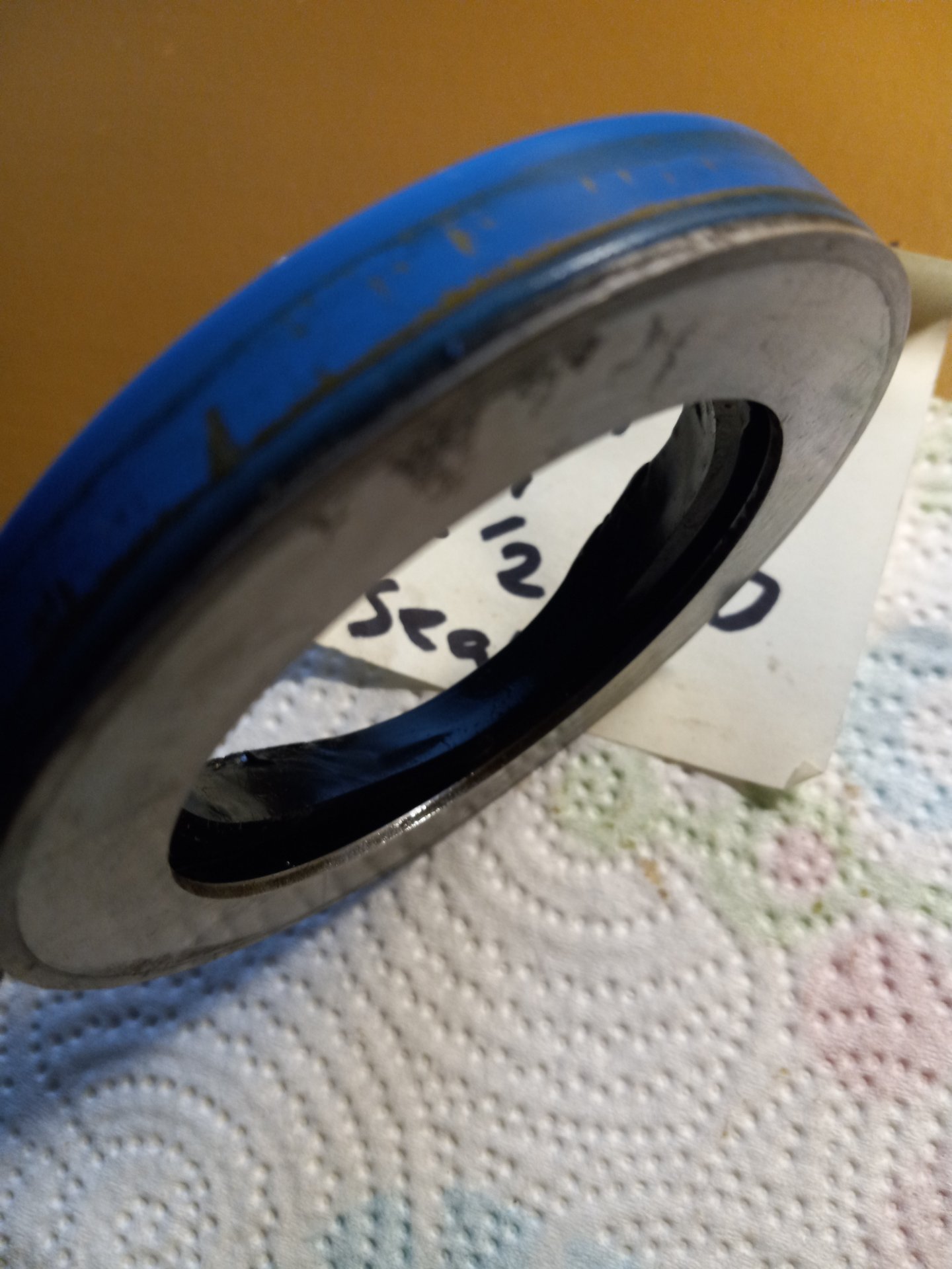

Thanks.When you say "screw hole in the chain case" where is this screw hole? The only holes in the chain case should be the inspection port in front and the access panels on top of the chain case.
If the oil is coming out of the top access panels then you most likely have bad motor carrier seals.

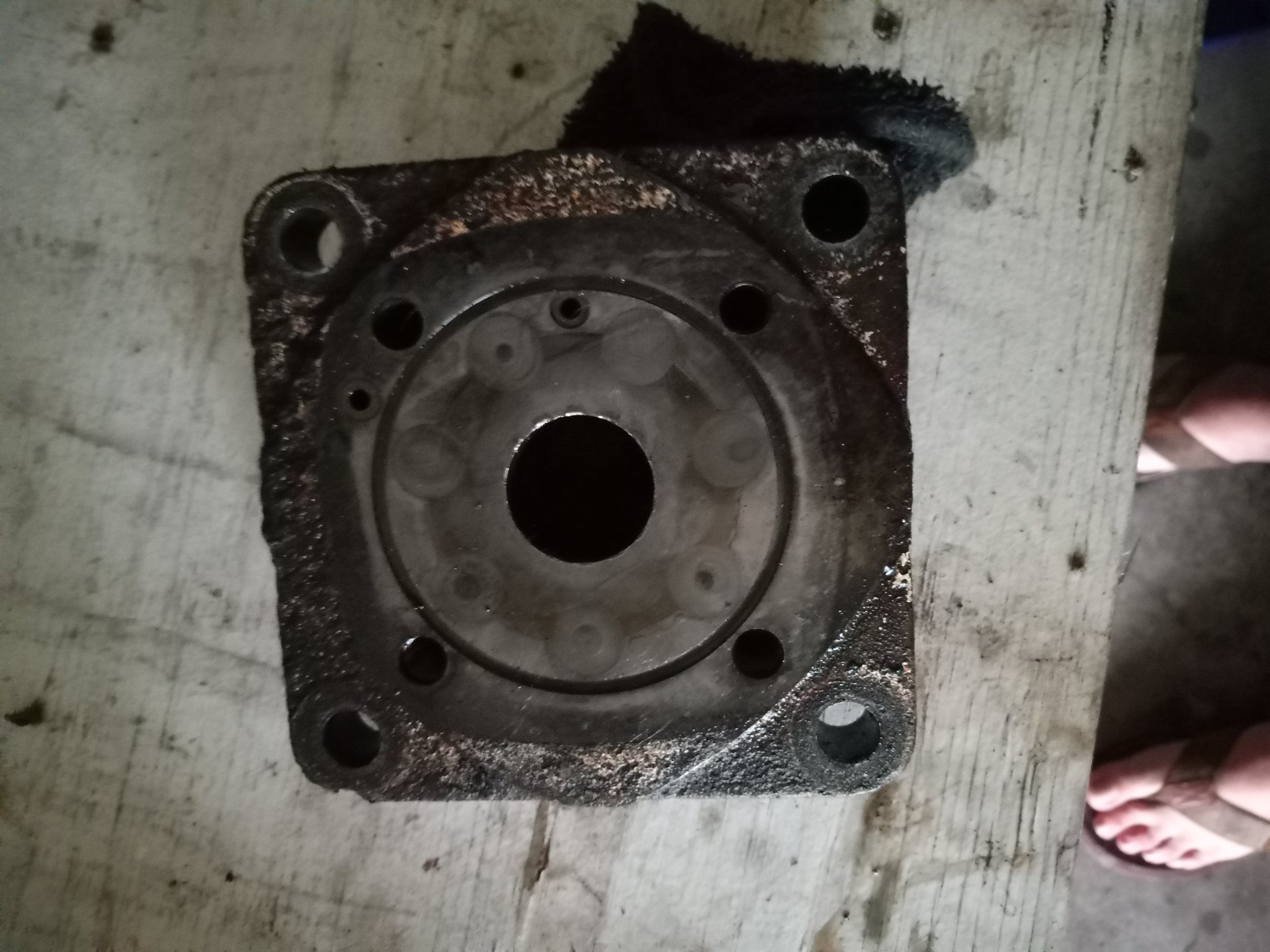

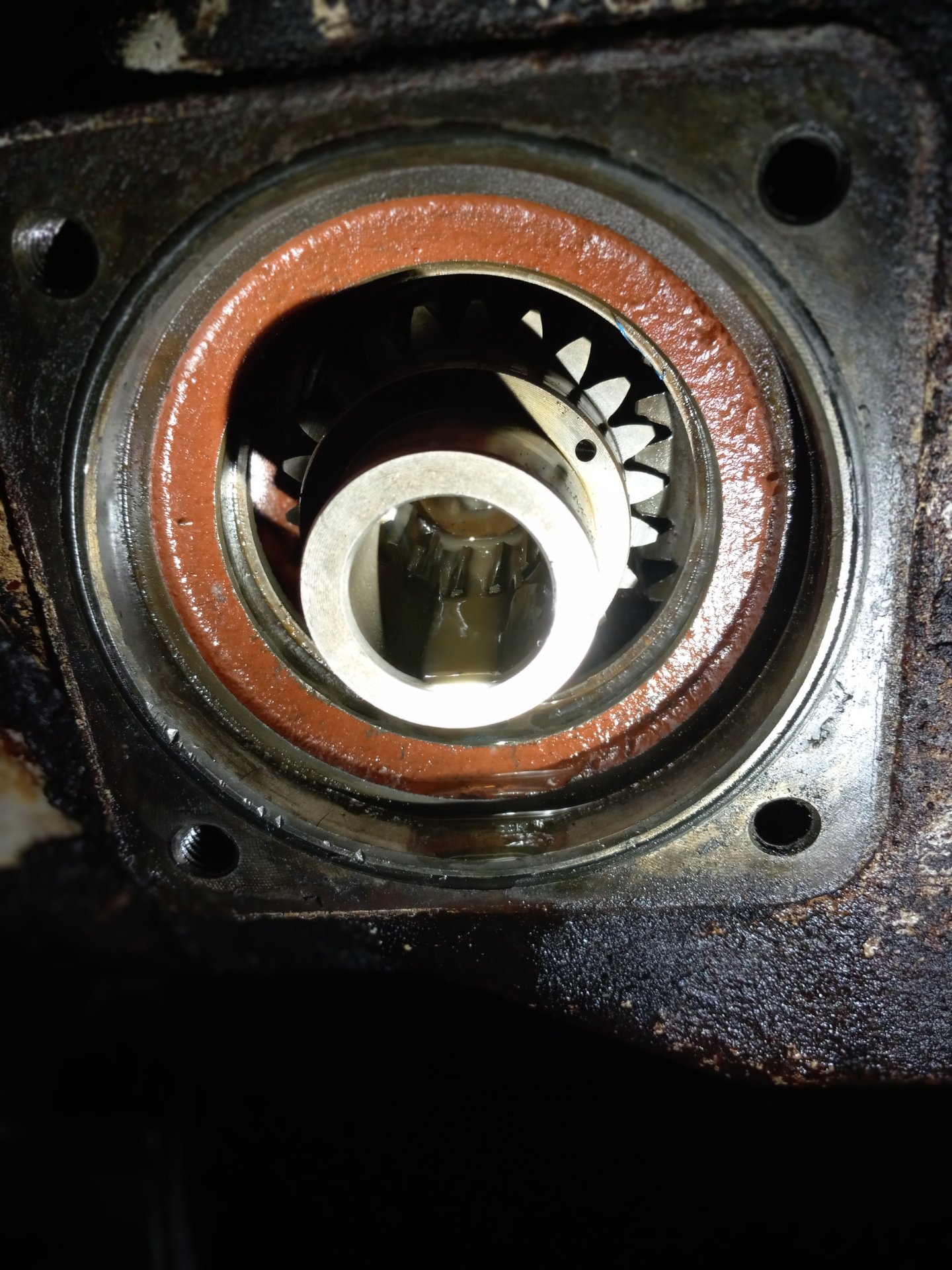

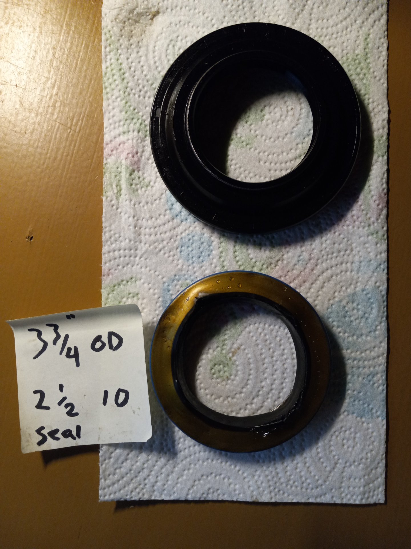

It is the access plate. I will pull the motors and replace the shaft seals. Thanks for the info. I found another thread with the seal
part number (#6705847).
I only had one of the motors off and put o-rings in it that were missing. The previous owner didn't know anything about bobcats and put everything together wrong or without the seals. I should have known that the only piece I didn't pull apart would also be put together wrong since apparently they had the entire bobcat apart.
