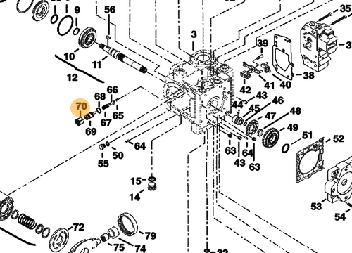

One good way to find the location of all this stuff is to go on partscatalog.bobcat.com, enter your serial number, then look for the part. You'll get an exploded diagram.
The charge relief on a manual control machine is on the backside of the left hydrostat. I took a quick glance at an sjc diagram just now and it looks to be in a similar position. It's a nut, adjuster, spring, and poppet. The manual controls have shims to adjust charge pressure, it looks like sjc has it all in the adjuster part. The spring could be broken/damaged, have something lodged in it, or the poppet could be damaged.
