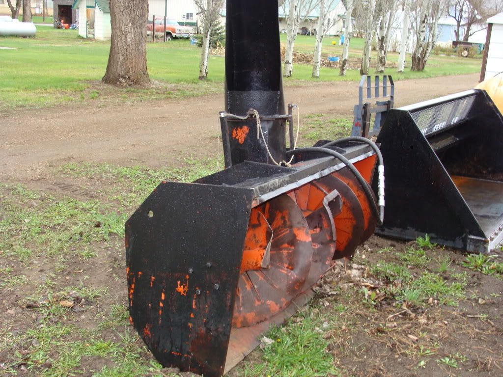

Almost the final update. I was waiting to get a good video of it in action but I was only given one more opportunity and I didn't have the camcorder with.
It works pretty darn good. It doesn't throw it 50ft but I never wanted it to so that works well. It throws heavy wet snow about 15 ft past the edge of the blower which is perfect for my use (Driveways)
I didn't even mess around with the turning mechanism. I just use the rope and pulley system that was there. One less motor and set of hydros to worry about.
I painted it but a day of working with it showed me it will need to be blasted and repainted this summer
Blower front 2 Blower Back 2
