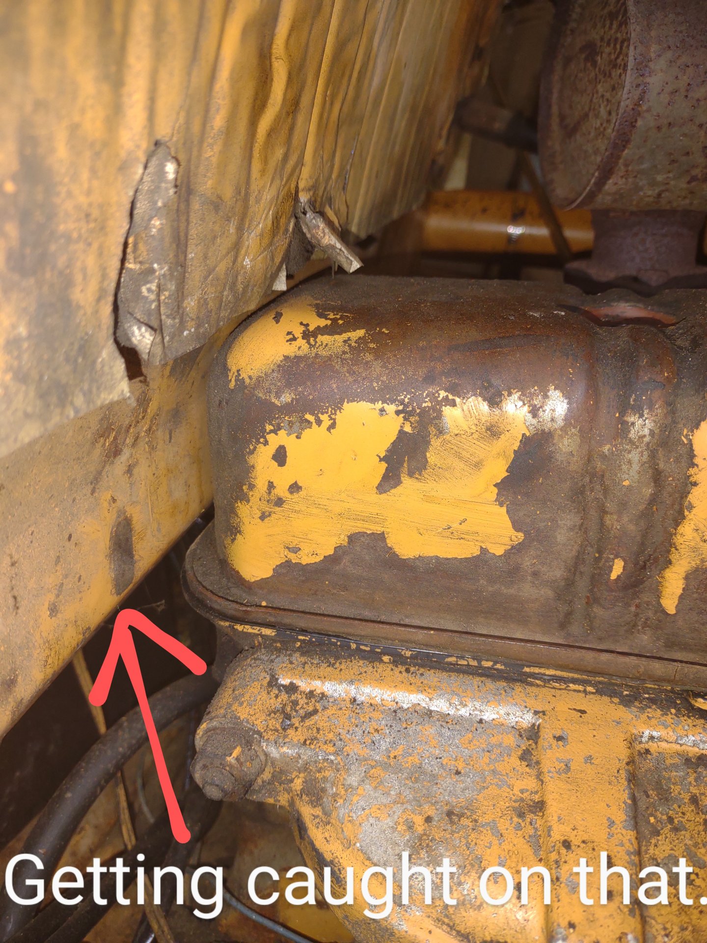

So I have a quick question I'm trying to get my valve cover off and originally I couldn't get it over the studs when I would tip it at an angle the studs stuck up too far or so I thought so I took the studs out using the jam nut method but I still can't clear the sloped piece of metal that is behind the seat, there is no way to get this valve cover off how did you get yours out? I've been trying to figure out what bolts I have to take out to get that piece loose so that I can gain maybe a quarter of an inch or something but I am struggling to get this out so if you have any advice I'd like to know since you have an 1835b with the diesel as well so it should be the same, thanks!

Finally figured it out, ended up taking off the cage on one side to make things easier to access then I removed the seat belt anchor, as well a two other bolts, then removed 3 bolts on the deck behind the drivers seat on the outer edge this is the deck above the air cleaner. From the back of the machine I then used a crowbar with one arm to get a little wiggle room while pulling the valve cover off with the other hand. What a pain! Now I have to find the timing inspection port which I *think* I found but mine doesn't look anything like the one in the service manual.
You talking about the timing mark cover on the injector pump? I'm not aware of any other timing marks under a cover. There are timing marks on the flywheel but they are readily visible without removing covers.
Yes you will need to move the big sheet behind the seat to remove the valve cover of the 188D. Best to remove the sheet altogether to remove injectors. The valve cover of the 148G engine is removable without that drama.
