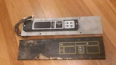

It is the instrument board. A compositor on back of it was hot glued to board and came unglued. It was jiggling around. The post is broke off inside of it. So can't solder it. :/ They telling me I should just get a remanufactured like new. $1645 ouuuuch

here is a few cheaper than your price too , see a lot for different models for way cheaper on ebay (like 140 bucks only, not sure if they can be used but might also be worth looking into
or maybe this might work??

I just bought a new board through my new holland dealer, there is a company in Canada manufacturing them, they quoted me $2165.00, my dealer was running 20% off on parts that week for a special, so it did bring price down a bit, my board had a lot of rust on bottom of circuit board, gauges were reading funky, and the lower button on the left side was seized, could not press it. I figured $1100.00 for a used, hmmmm, what if that fails within a week or so, used electronics is a crap shoot, the new board came with a 2 year warranty, I have a John Deere 8875, which is New Holland LX885. John Deere would not acknowledge the aftermarket supplier exists.

Yep this one is warranted through CHS NewHolland dealer ship. Apple farm Service. I just went with the new remanufactured. That way I know what I got. They didn't want my old one for core. It was just the capacitor that came unglued and jiggled around and prongs busted off. All the gauges fuel exc. and lights worked on it until it couldn't hold on anymore. If I would have pulled panel off I would have of saw came off. I might try to find capacitor and find good solder circuit board guy. I use loader alot for pig compost. It lives in there. Hard nasty life.
