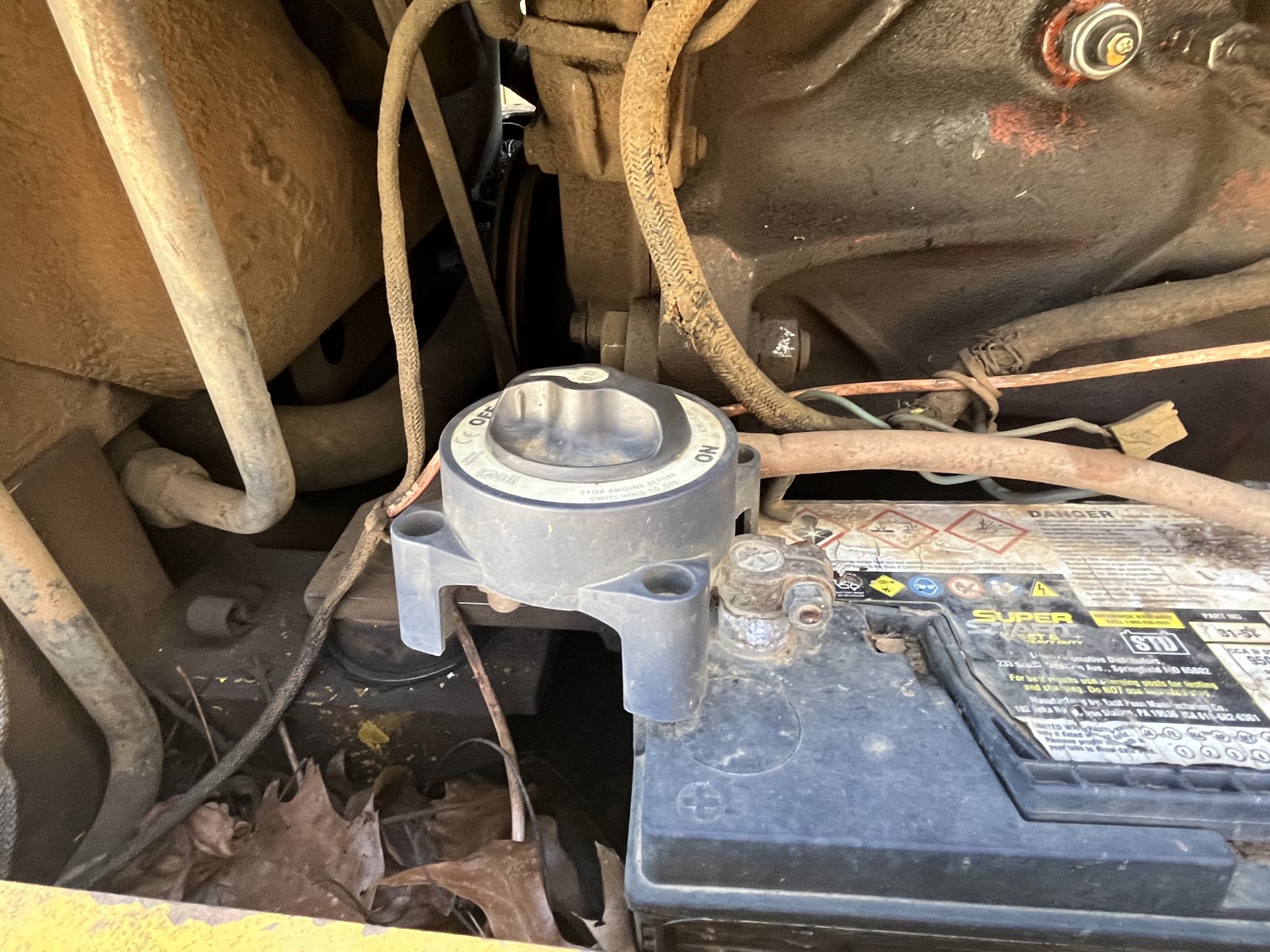

I mounted a switch on the positive terminal of the battery. There are a lot of places the electrical system can get damaged and electrical fire have happened when no one was around. It's a $60 piece of mind and instant work around to your problem.

and I also highly recommend adding a battery disconnect to all machines, it offer a lot of advantages
from stopping any parasitic drain , which almost every machine made has in some degree!
and why most come with them from the factory\
plus they also can be placed in places where anyone trying to steal your machine might not know where it is, making it harder on them
I personally like to add them on the fire wall behind seat sort of(like behind my right elbow if sitting in machine)
so I can reach when sitting, but yet not be too visible for folks not knowing to look for them
