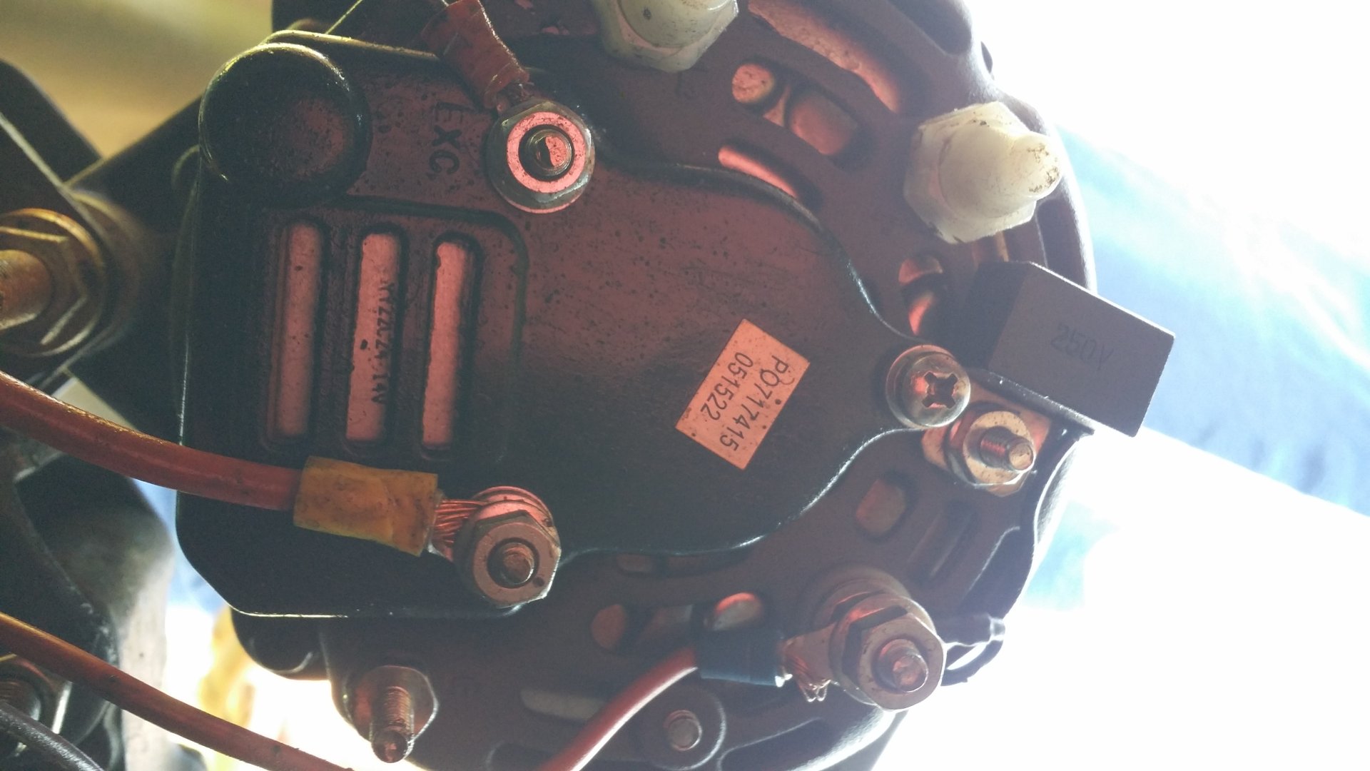

Here is a picture of the back of the Alternator. Two red wires and a green wire. The green wire is the exciter wire. I was told to run that wire to a bulb.
    201.1 KB
Looks like your middle nut there may be loose, the heavy red wire with the yellow collar on the crimp.
The reason I say, is that the stranded wire is kinda under the nut. This will make it go "tight" while you are there, but after some wiggling and vibrating, will come loose.
This can blow out voltage regulators, btw. In the marine industry, this has caused compete boat fires and total losses.
Also double check that your ring terminal(s) isn't grounding out on the alternator case.
