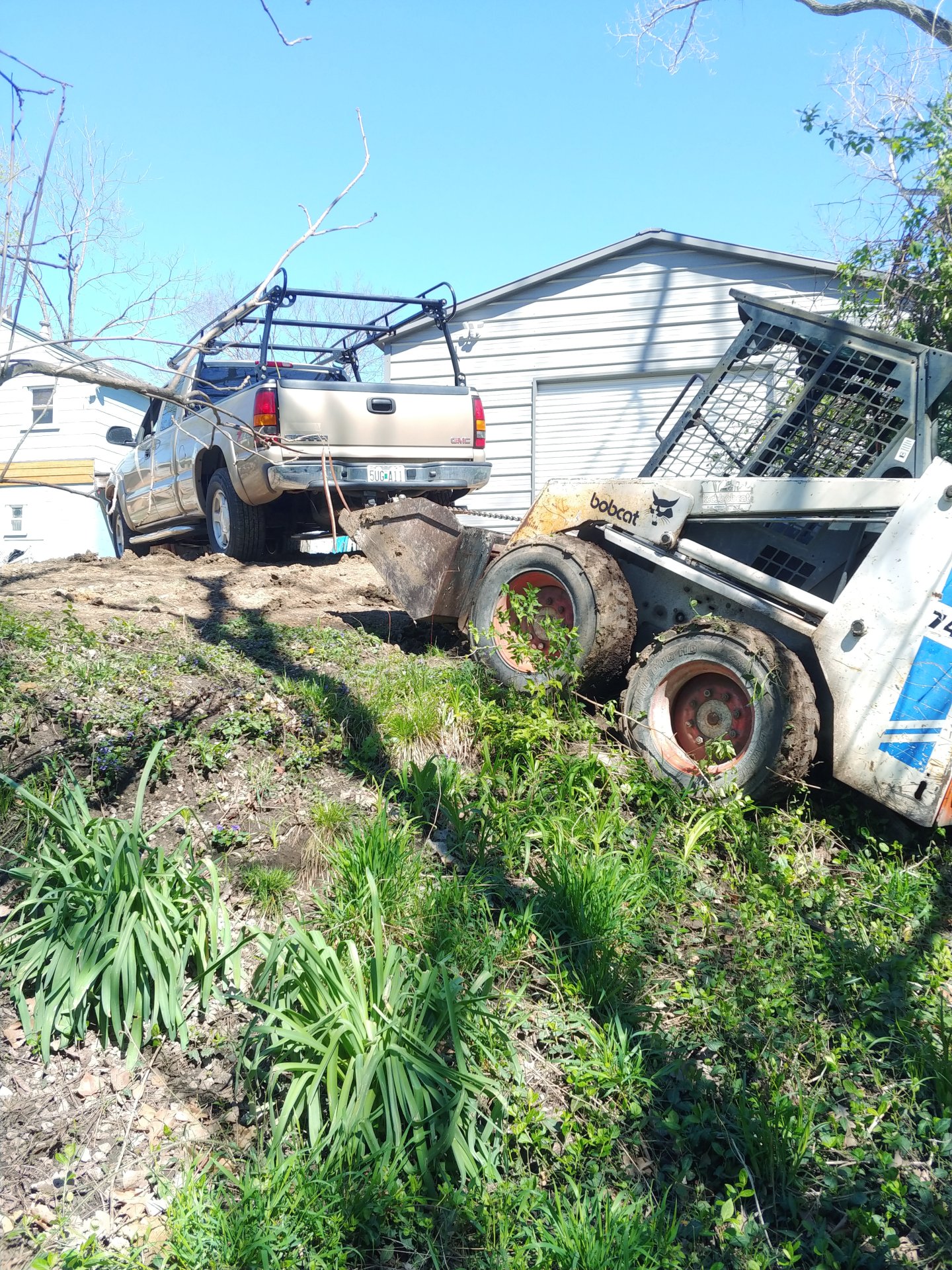

so I got my 743 stuck by getting too close to the edge of the bank I was laying some fill on.
It had rained a couple days ago so the dirt is a little too wet to get the traction required.
I'm going to try to tow it out with my 4x4 1/2 ton but is there anyway to disengage the wheels from the drive---I assume not without uncoupling hyd hoses.
in that case I'll need to get a second person to drive truck while I try to drive bobby up the hill
    899.7 KB
yay trusty GMC saves the day again
You can also use the bucket as a winch to get unstuck as long as you can go forward and have a sturdy anchor. I've been thinking about mounting an electric winch on the back of mine somehow. Beef up the door and mount it in there or something. I loaded it one time with a come along on a tilt trailer (it was dead in the water). Need to figure out a better self recovery method.
winch on back would only work if you were pointing the right way. if truck hadn't worked, the next step was 100 ft of chain to nearest tree and come a long. not even sure that would have worked with the angle to the bank on which I was sitting.
I've always been tempted to put a big winch on the truck tho.
I was lucky to have a buddy who came by to drive the truck while I ran Bobby.
