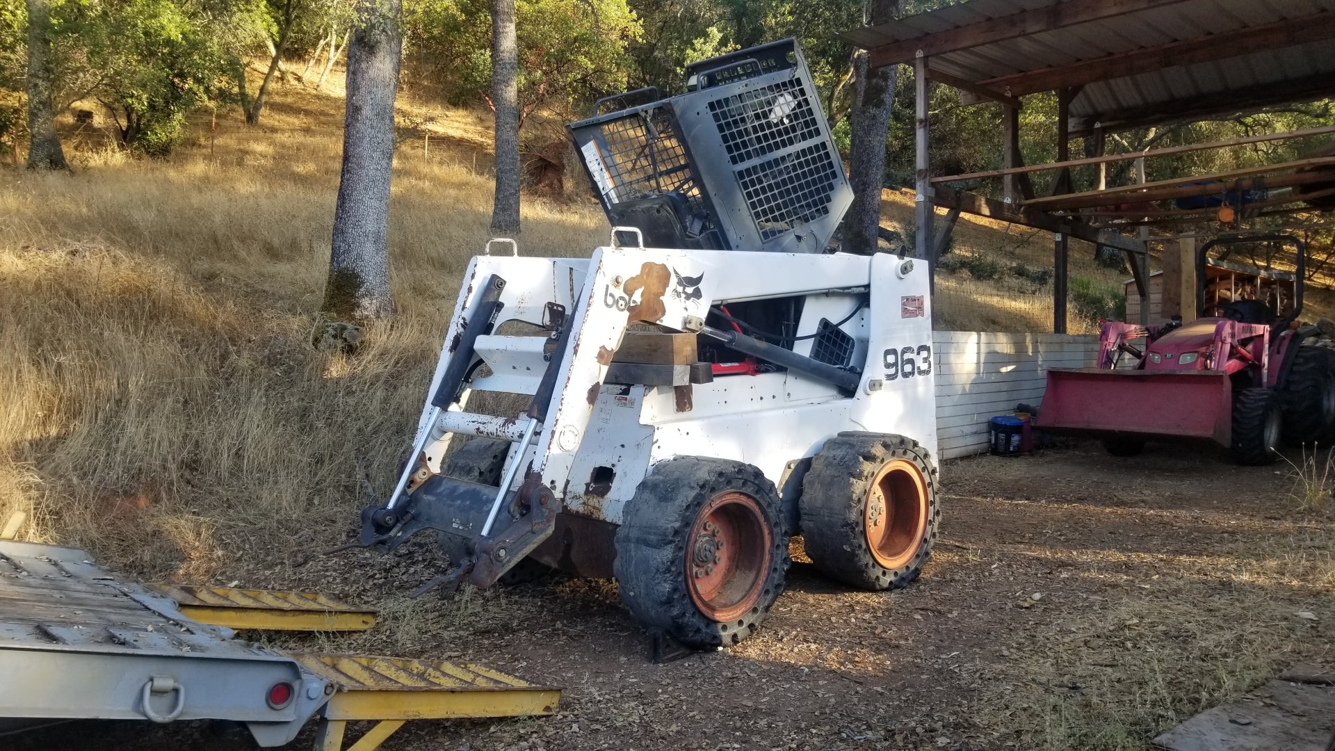

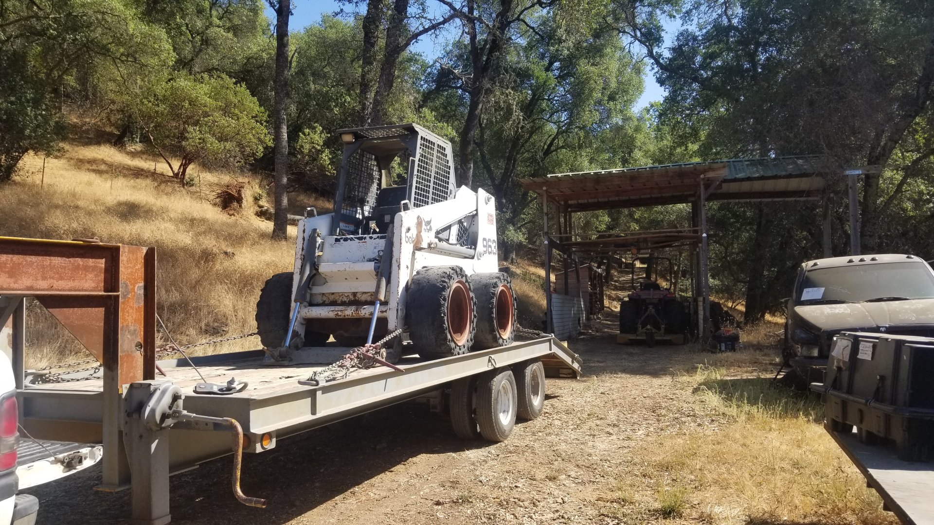

I have a new-to-me inop (engine doesn't run) 963C. It was lifted onto my trailer by a wheeled loader, and I'm trying now to remove it from the trailer so I can work on it. Per the manual I have removed the valves from the drive motor assemblies on either side, and did the manual override for the traction control. I connected a porta-power to the traction control box under the cab, and pumped it up to at least 350psi.
With one side lifted off the ground I can get the wheels in the air to rotate ~1/4 turn by hand with significant resistance, then the pressure seems to bleed down and I cant move the wheels anymore. I repump up the porta-power and I can get about another 1/4 turn. I would have expected the wheels to turn freely with the porta power engaged, and I don't know that I'm going to be able to pull it off the trailer like this.

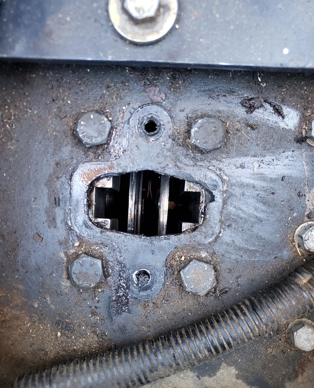

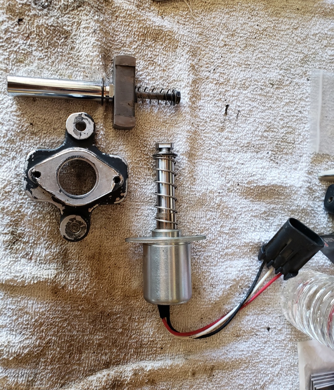

Not sure on 963c. Under your seat directly in the middle. (Lift the cab up safely) is the locking/parking brake solenoid right there? When I bought my 863 it was "locked". I removed it to load & unload it. I then replaced it with a new one. I will attach pics.

With the solenoid removed did your machine roll freely? My FSM has some instructions to bypass the solenoid, which i did, but doing that didnt allow the machine to 'free roll' like i expected.
Yes, the Pin was locked in place "E-Brake" on mine. Once I removed the Pin it rolled. Not easy but it did. If you are over-riding it you should hear the loud "Click" of the PIN .

I removed the valve assemblies, I assumed (wrongly I guess?) That would allow the wheels to spin freely. Going to try and pull it off the trailer with a tractor. Fingers crossed.
Before you go to pulling on it make sure it's ok to just move it with the engine off. I don't know about the 963, but a 743 you have to disengage the parking brake and install bypass valves in the wheel pump part of the hydro pumps or you can destroy the wheel motors and or the pumps. Like I said, that's a 743 I don't know about the 963's. But I would make sure
Tks for the counsel. Im fortunate to have the FSM, and it detailed steps for making it safe to flat tow. I did have to remove a valve from the wheel motors on both sides, manually override the brake solenoid and then pump pressure into the traction control valve.
I was able to get it off the trailer tonight with no drama, tks to the responses I received here!
