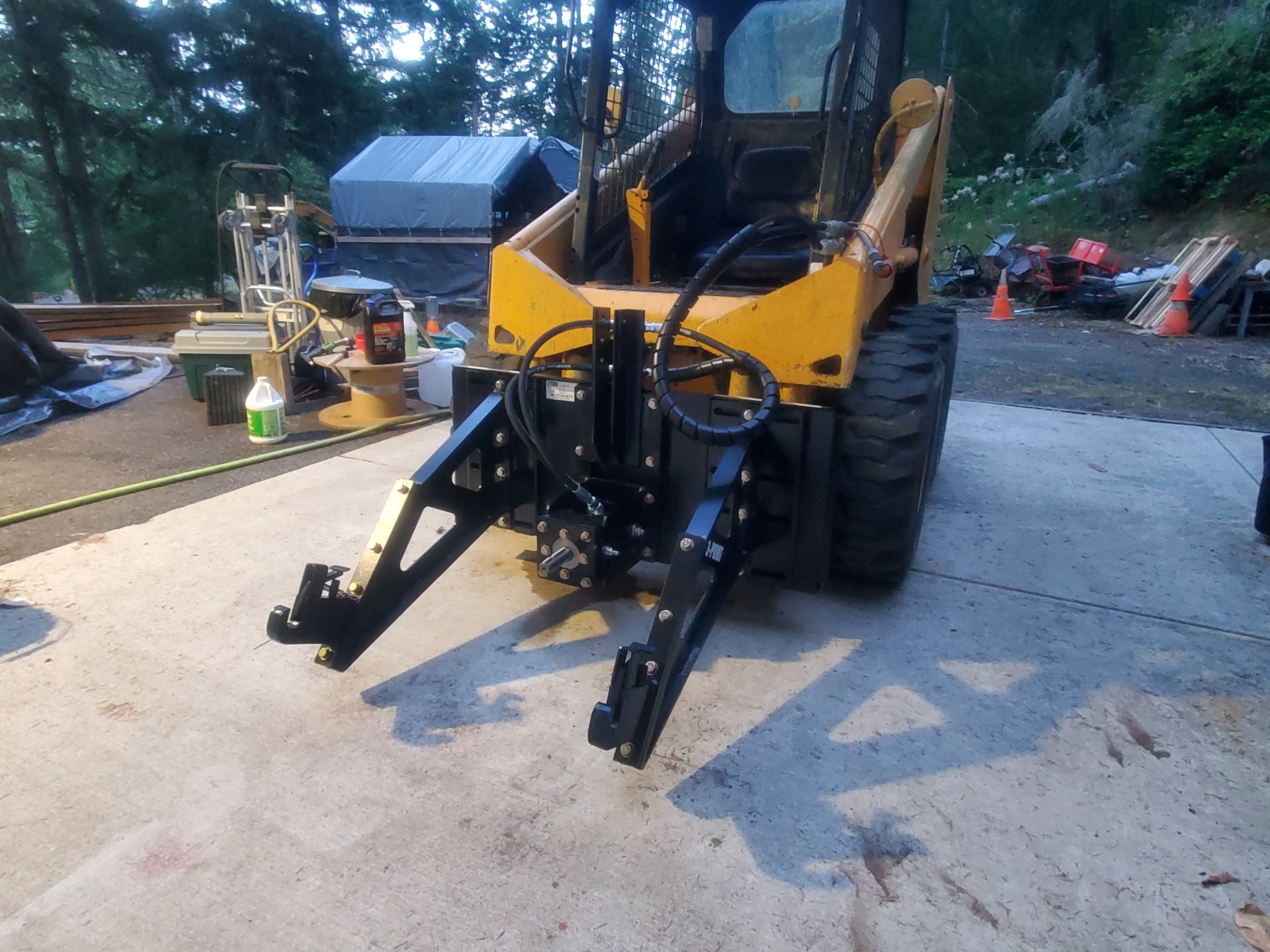

Well lookie what I got! They did all the engineering and fab work for me. Going to use a conventional brush hog.

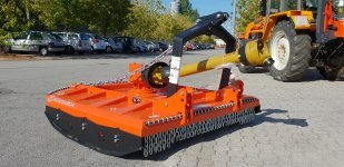

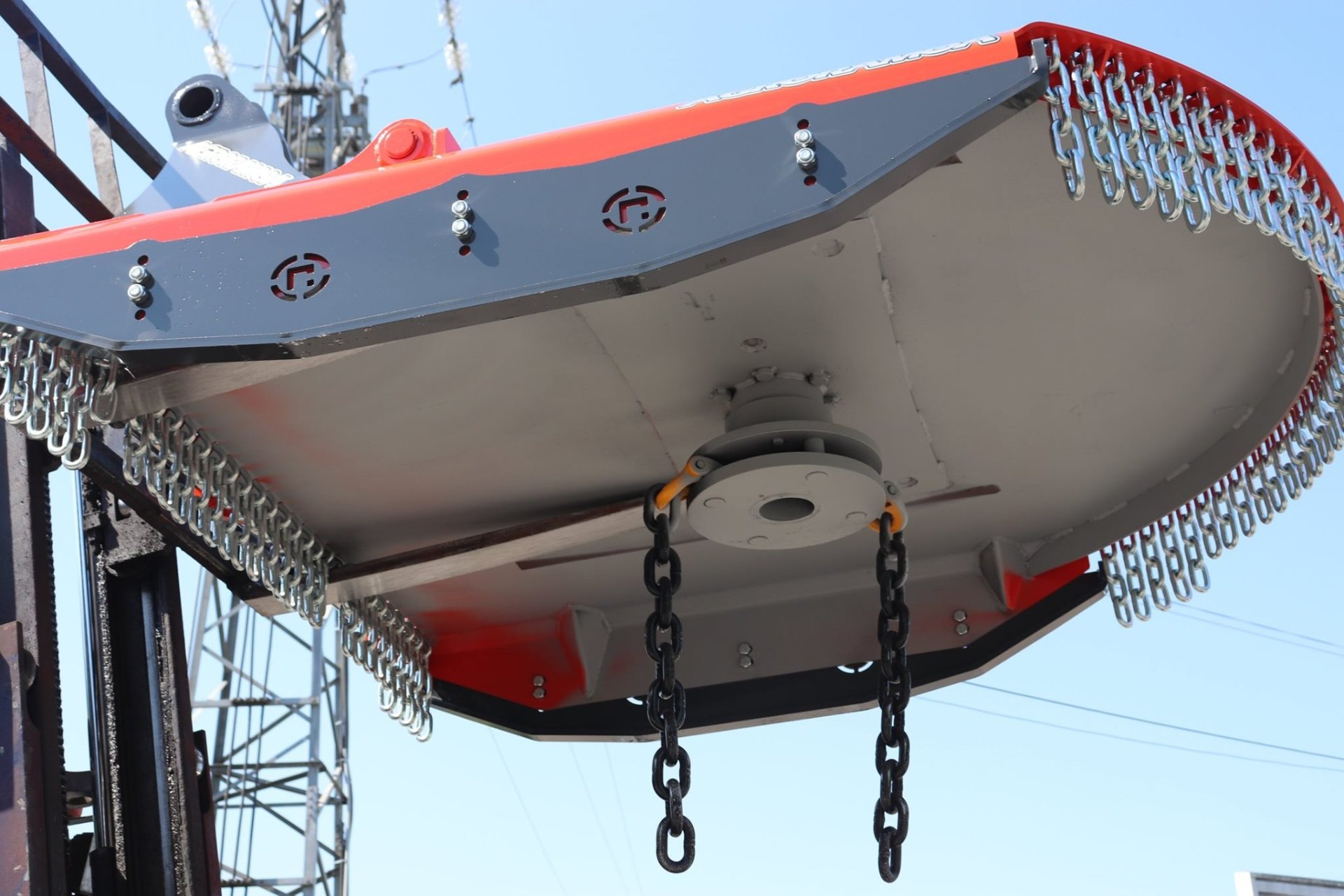

Why the switch to a bush hog? I am tracking a different take on those. Seems in Europe you can get a chain carrier instead of blades. The grade 80 chains are supposed to be better than blades. The 3 pt chain suspension should give a little more float on uneven ground.

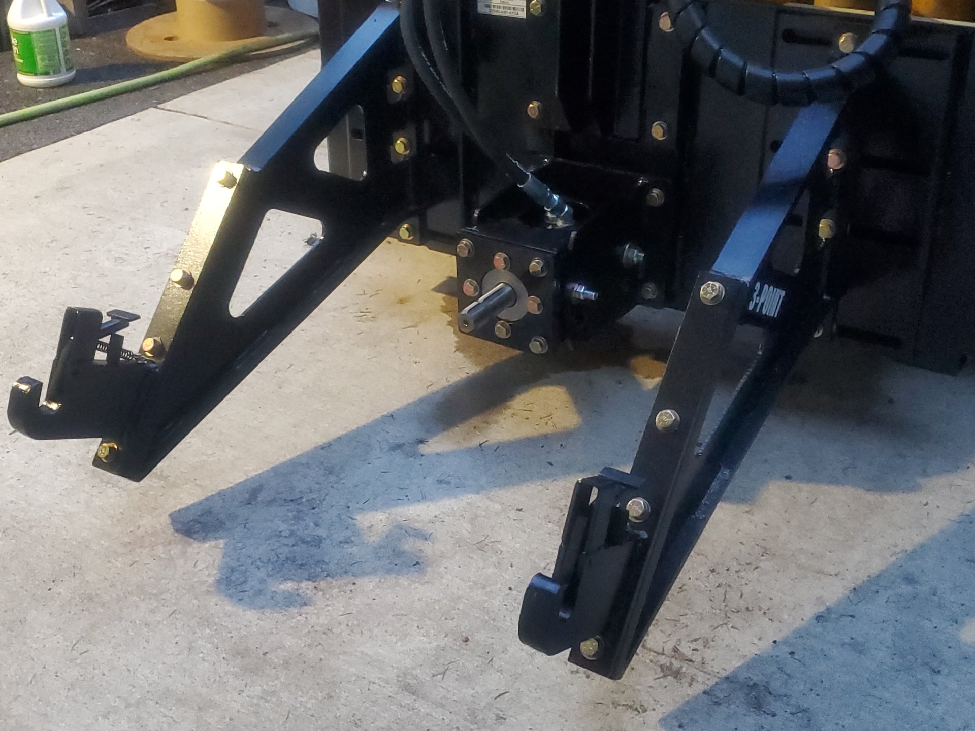

I will tell you to be careful with that three point hitch. Unlike a tractor, the arms are fixed into position which means if you hit something you will bend the plate where the arms bolt up or the arms themselves.
At that point, it becomes real hard to slide the arms for different equipment. I'd tend to recommend that people just buy a cutter that is made to mount to the skid steer plate. The hassle factor is much lower over time.
I'm cutting over the edge of a bank between trees, so the rotary cutter (slasher/bush hog) gives me extra reach.
The Aussies use chains too, but I've yet to see what kind of cut they give. I really should have a flail mower on my excavator but there are no auxiliary circuits on it.

I need the forward reach for over-the-bank cutting. Not going to be traveling and cutting at the same time. Should be ok.

Why this setup vs a ss hydraulic brush cutter? Did you call Newton to ask what'll happen when you hang it over the edge? I need all your personal info so I can help your estate sue the various manufacturers for not placing warning labels on this combination of stuff.
This combination of attachments is hazardous to life and limb
1) A hydraulic rotary cutter is right up against the front of the machine, hence no margin for error when cutting over a bank.
1a) A rotary cutter has at least a 3 foot overreach compared to a flail mower. Again, no traveling and cutting simultaneously.
2) The phone call with Newton was perfect. It was very perfect. He told me that "No matter where you go the front wheels will always be the fulcrum."
Well, since you don't have a door, when you angle that cutter over the bank, you will be shooting debris right at your head and body.
Yep, can't argue with that. That's why I'll fab up a raised 3/4" expanded metal door. Pics soon (I hope). Actually shouldn't be too bad with the chain flap across the back.
Noticed you are running 2 lines to hydraulic motor and no case drain line - so you will need a overrunning clutch on driveshaft as when shutting off hydraulic flow - centrifugal rotation of the cutter will create a problem of oil trapped in motor with no place to go
i asked about that, and no case drain required on this lo-flow gear motor, and there is a relief valve hidden behind the top link mounting. The relief pops and the oil just recircs.
