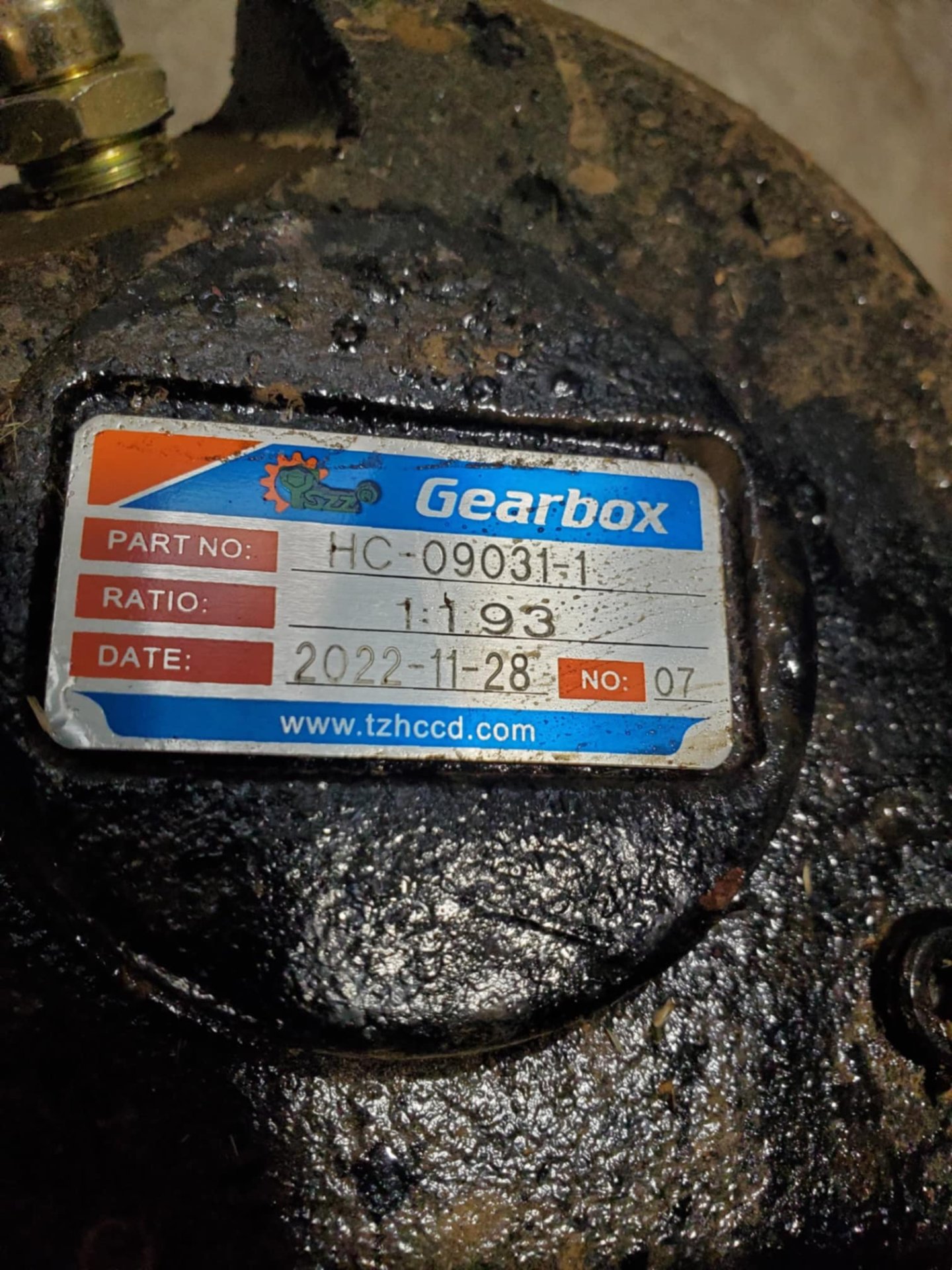

Welp...started tearing down the mower. Just a few metric bolts to loosen and remove and the thing is completely apart. Having removed the parts, turns out the gear box is completely seized. I did find a nice part number on the gear box, though (1st pic)

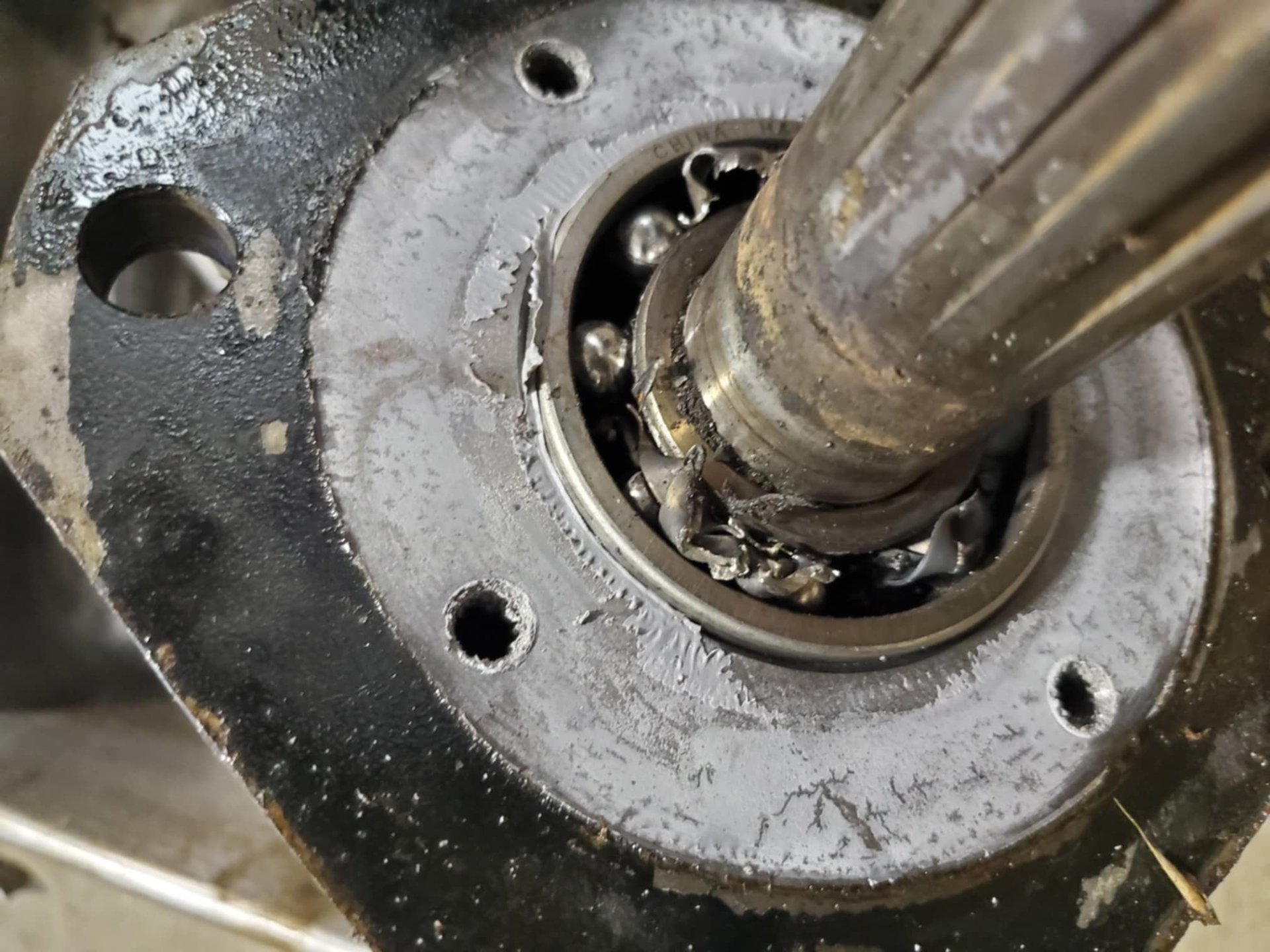

Pulling the dry gear box apart, I found the main shaft bearing to have a torn up cage and not all ball bearings present (2nd pic). That's not good!

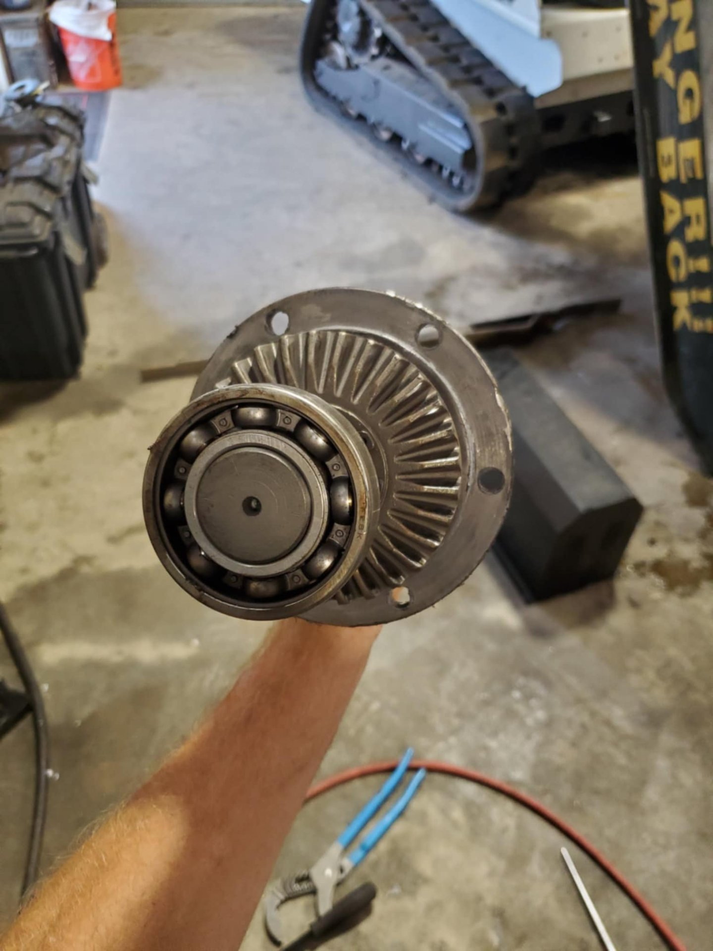

I figured from there the bearing fragments likely took out the beveled gears, but other than some wear from having been filled with zero gear oil, they look complete (3rd pic)
The main shaft is seized on to the bearing but I want to get it completely apart to evaluate it all. Furthermore, I hoped the visable and detailed part number would yield a slamdunk for finding a replacement gearbox but the website listed is not secure and googling just the part number reveals nothing.
I'm open to your ideas for sourcing a gear box. If you know of a north American distributor of these parts, please pass it along to me.
That said, if I can get everything apart and it all looks in decent enough shape, I might just press in a sourced bearing and bolt it all back together.
Either way, if you've bought one of these pieces of junk, CHECK THE GEAR OIL LEVEL!! From the looks of it, there was zero gear oil added to the gearbox before shipping as there was no evidence of ANY gear oil in the box and the only thing that leaked on to my clean shop floor was dust from the bearing. Lesson learned.

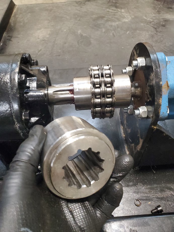

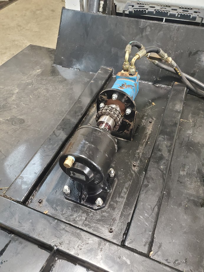

Mine has splined shafts on both ends (mine's in the pics), 12 splines on the blade side, 6 splines on the coupler. And I have a lovejoy coupler on mine. I searched the part number for the whole gearbox without dashes putting dashes in the search (HC 09031 1) and a bunch more options came up.
I ended up going with the one in the link below since it was the closest match I could find at the cheapest price (less than half the cost of the one on Amazon or Ebay).
https://www.agrisupply.com/input-shaft-spline-gearbox-126964/p/126964/
Thanks again for posting!

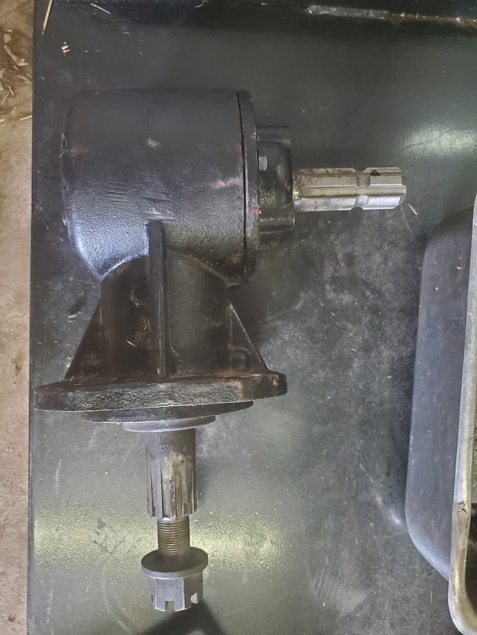

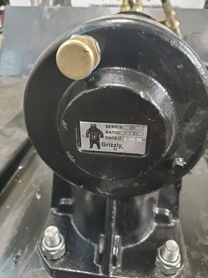

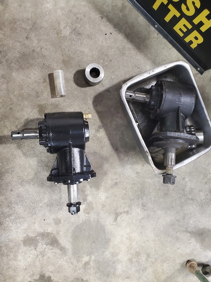

Here's the old gearbox and the new one that looks almost identical
Both say they're 1:1.93 gear ratios but I didn't count the teeth on either.
Included with the new gearbox was a solid coupler but I ended up deciding to use the old, chained one in an effort to isolate the gearbox from the pump a little better. I can always go back and install the solid coupler, I suppose.
Almost ready to work
Almost ready. I chose to add gear oil this time around, though 🥴
Thanks for the help!
