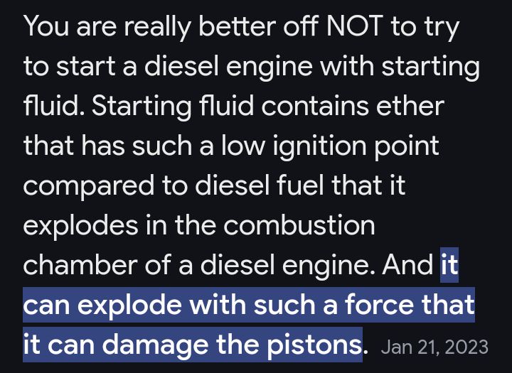

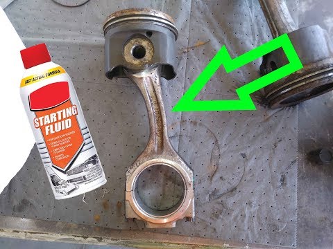

You should never use starting fluid to start your engine, it can bend your push rods break your pistons and cause major damage. I have rebuilt a few engines because of that issue and I have replaced too many engines because of this issue. Just saying
