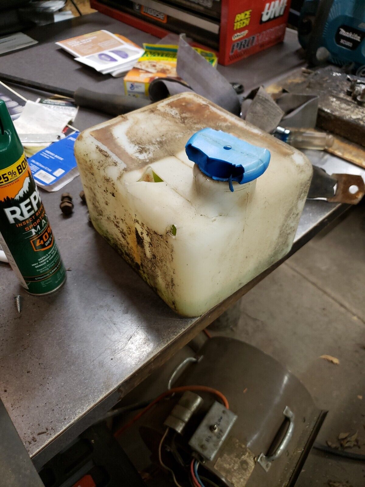

Anyone know of a replacement coolant tank that will fit in the original location on a 632? I just picked up a 632 and the bottle is all cracked up from sun exposure over the last 40+ years. Bobcat doesn't sell them anymore and I can't seem to find one aftermarket. Bobcat P/N is 6555891.

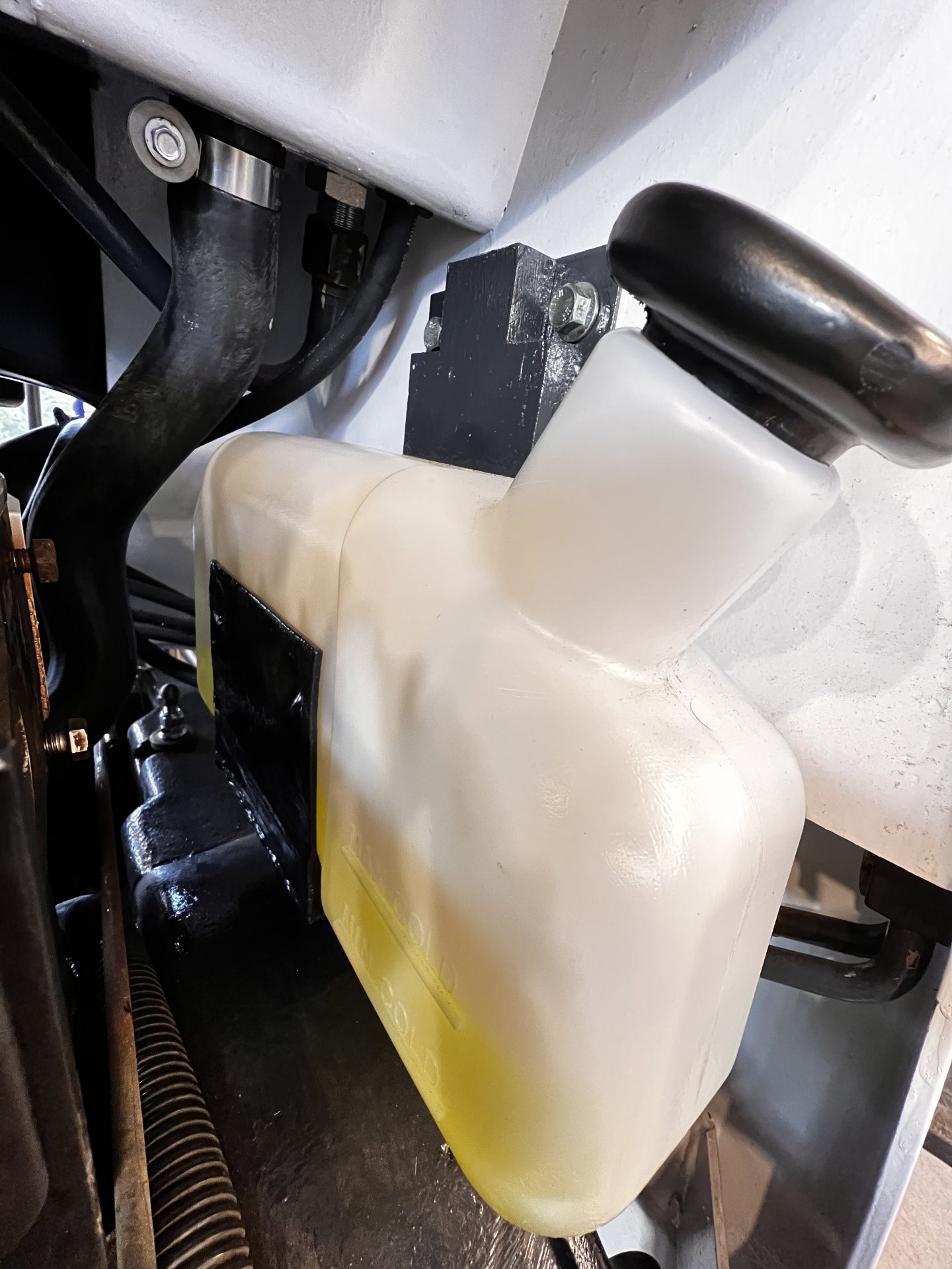

I had the same issue with my 853 - no replacement tanks available. I ended up cutting and re-welding my bracket mount to fit a generic Bobcat tank I found on eBay. I cut it to have the divots fit the new tank and just put a piece of painted wood on the other side to stop any movement.
