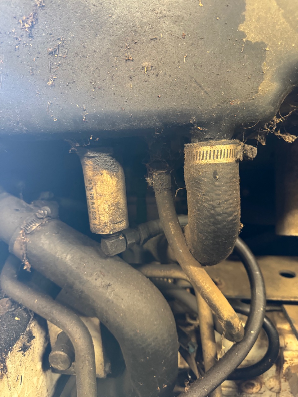

Hey guys new to the forum. Had this project 753 for a week or so now. Got the cylinders all repacked but the hydraulic tank had water in it and the oil is milky. I want to flush the system before I connect the cylinders. Which one of these is the return for the hydraulic fluid? I want to disconnect it and run the machine to try and flush out the contaminated oil.

Some people have used the auxillary connection on the front of the machine to flush the system. They start the machine and power the aux and use an open-ended hydro hose and pump the old fluid into a bucket. When the pump/oil starts to sputter, they quickly shut the machine down. I may be wrong, but at the same time I think I recall them using a return hose to draw the new oil back into the system at the same time. Otherwise, they would just fill the hydro tank with new fluid. Do a search on here you should find the answer.

Will do. Tried pumping out the old stuff in the hydro tank and adding a gallon of new but It turned milky again when I turned the machine on. Guessing the old stuff in the rest of the system piped back in and mixed with the new
The large hose is the suction and return is teed into the suction hose behind the pumps. The small line is the return/bleed-off from the drive motors.
