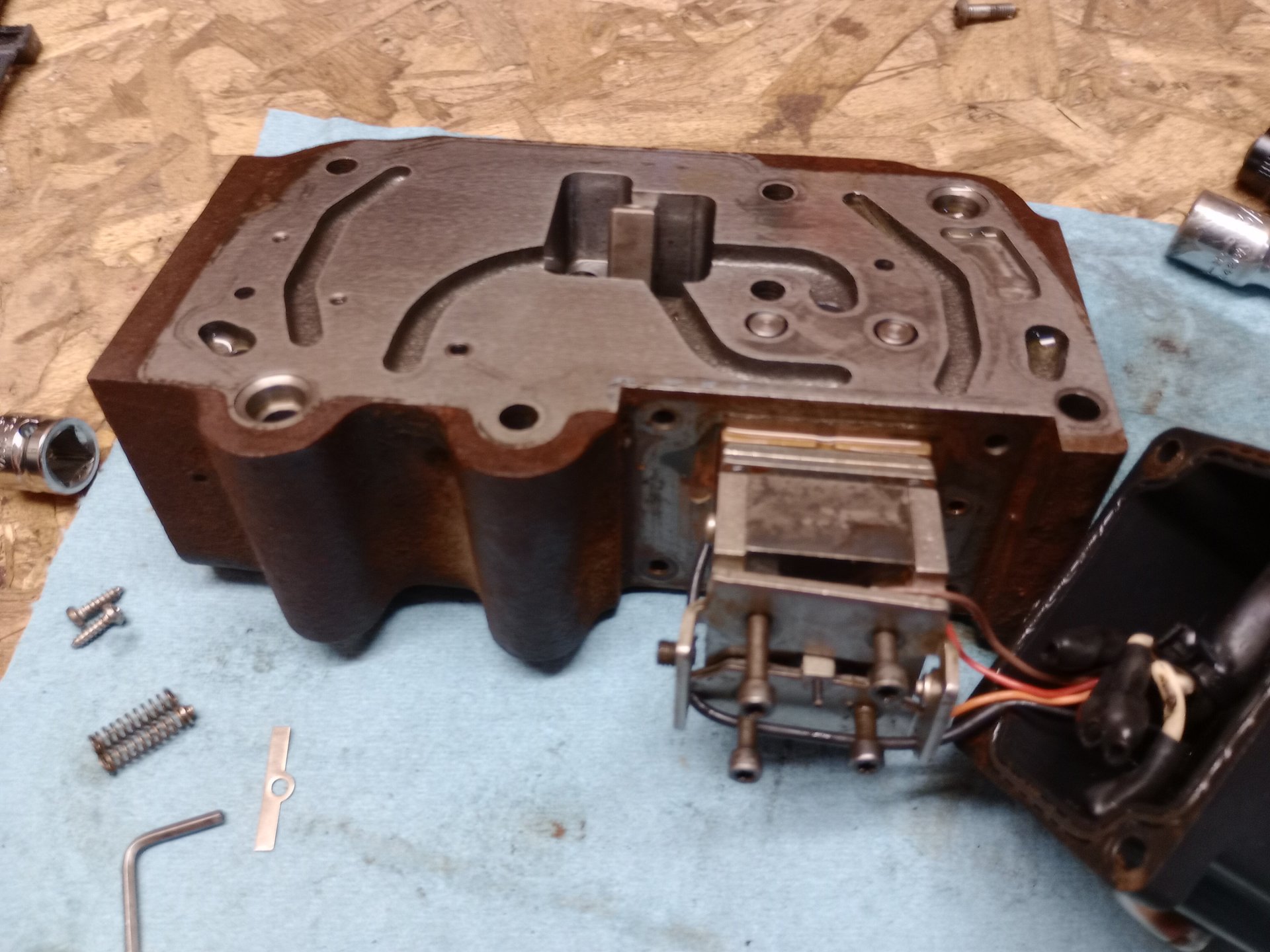

R Richard57 Active member Joined Jun 22, 2023 Messages 35 Jun 8, 2024 #28 I know it's not called a solid but this is the part with open wiring. Can't find information on adjustment

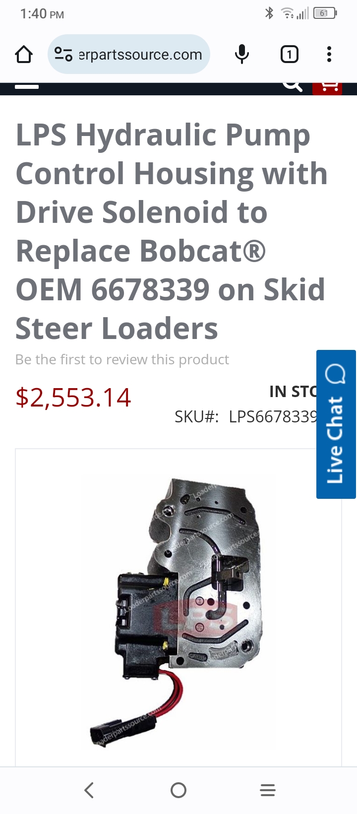

E Equipment_Tech Well-known member Joined Jun 16, 2023 Messages 185 City & State/Province USA Jun 8, 2024 #31 The photo you sent me...... That is off the pump ??
E Equipment_Tech Well-known member Joined Jun 16, 2023 Messages 185 City & State/Province USA Jun 8, 2024 #33 In that case I would find out who makes the pump (id plate - example: Parker) and find a local dealer for the pump Bring that piece into them and let them test / inspect. It will cost a little but not like that amount unless they tell you its cracked or damaged
