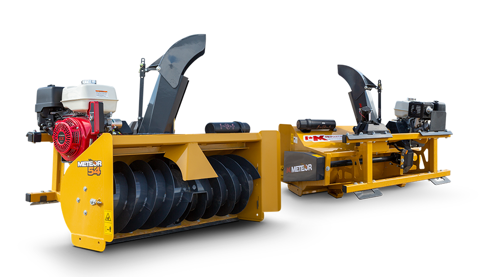

About the only thing that would perform to any satisfaction with a 743 would be a snowblower attachment with its own engine, that way it has all the power it needs. Not sure what's out there to buy in that size range though other than things people would have cooked up themselves…
Edit: a quick google search resulted in this…
Thank you very much to all your replies I am taking things into consideration most likely going to get the self-powered snow blower!
