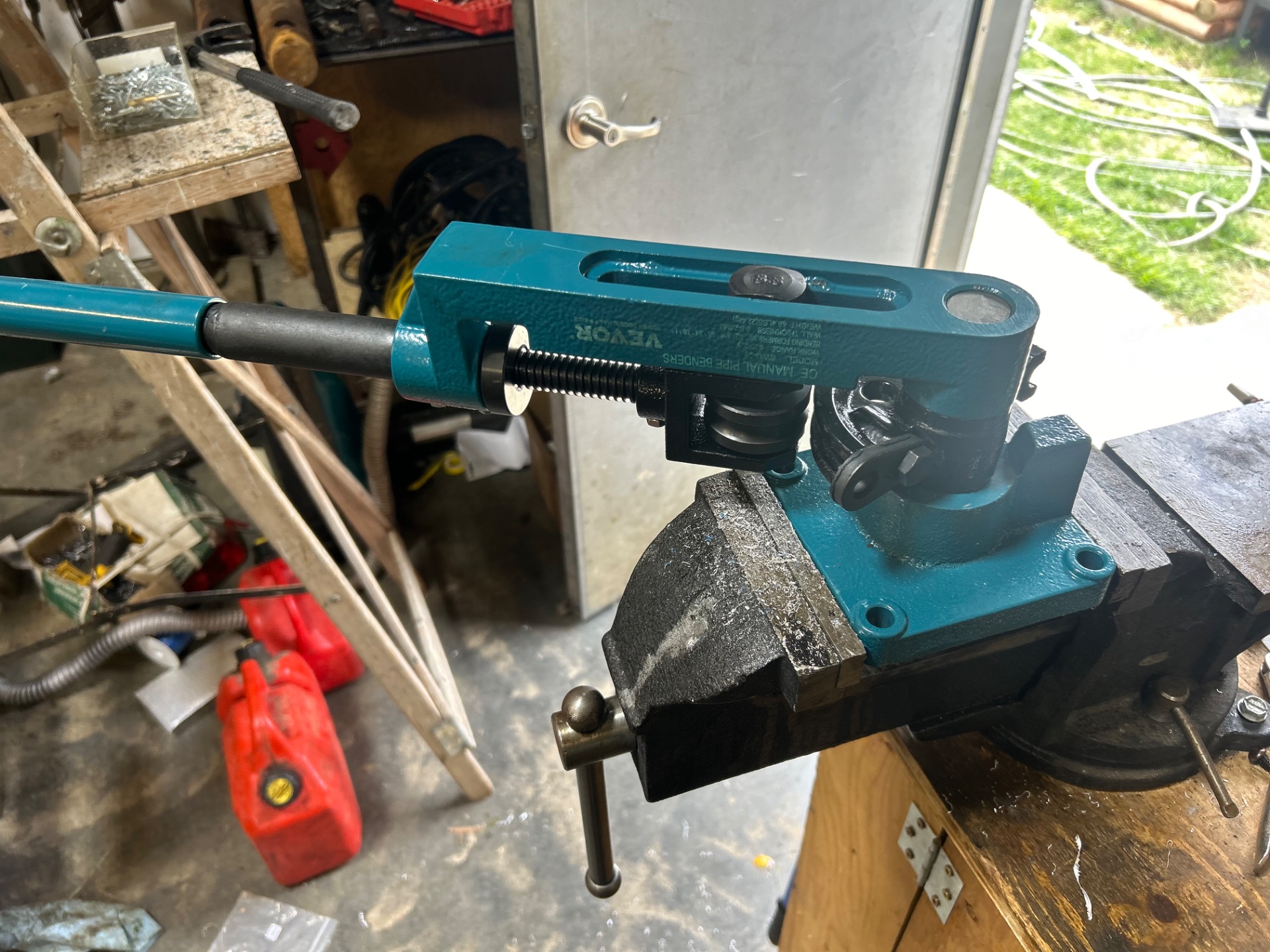

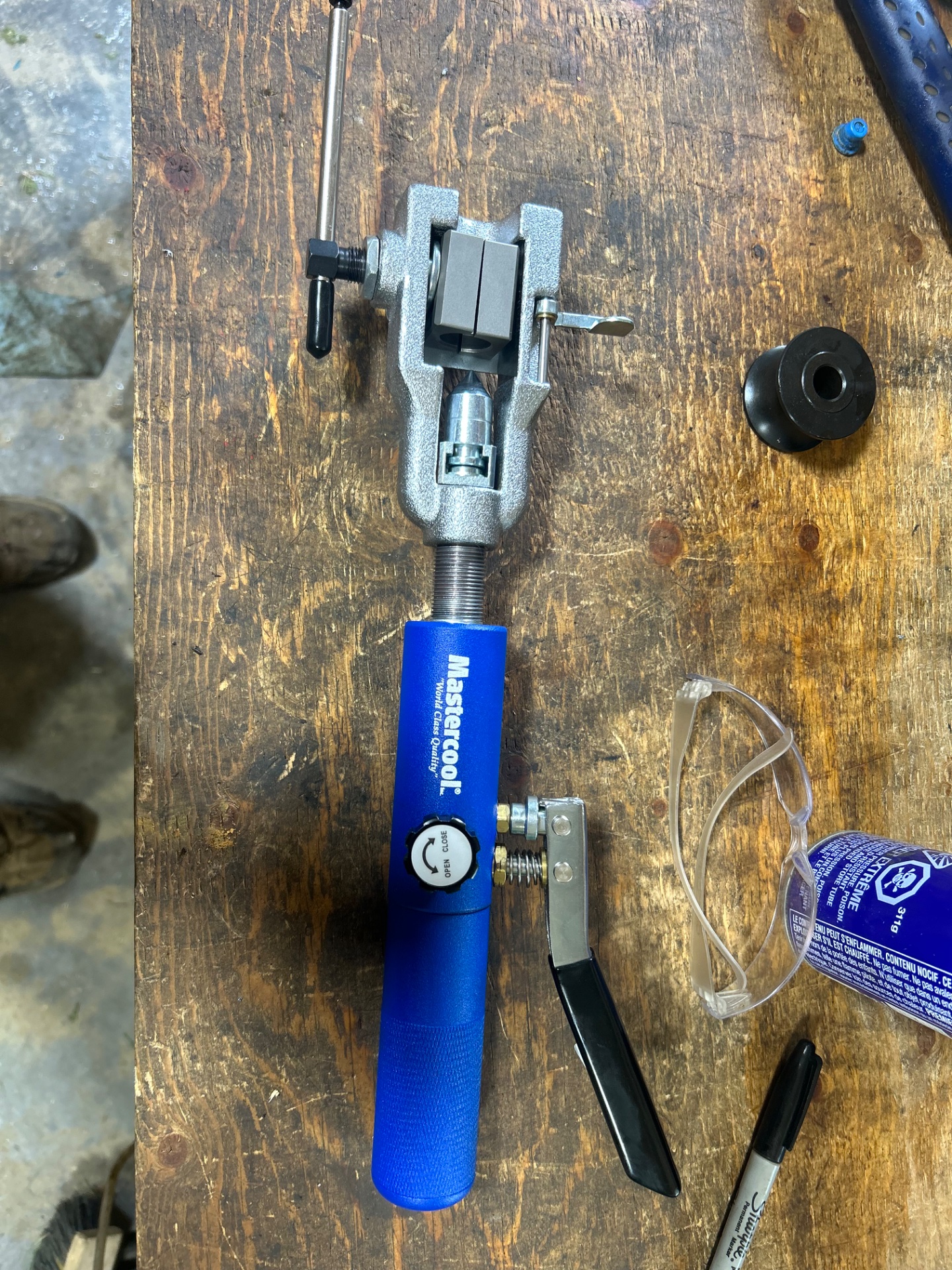

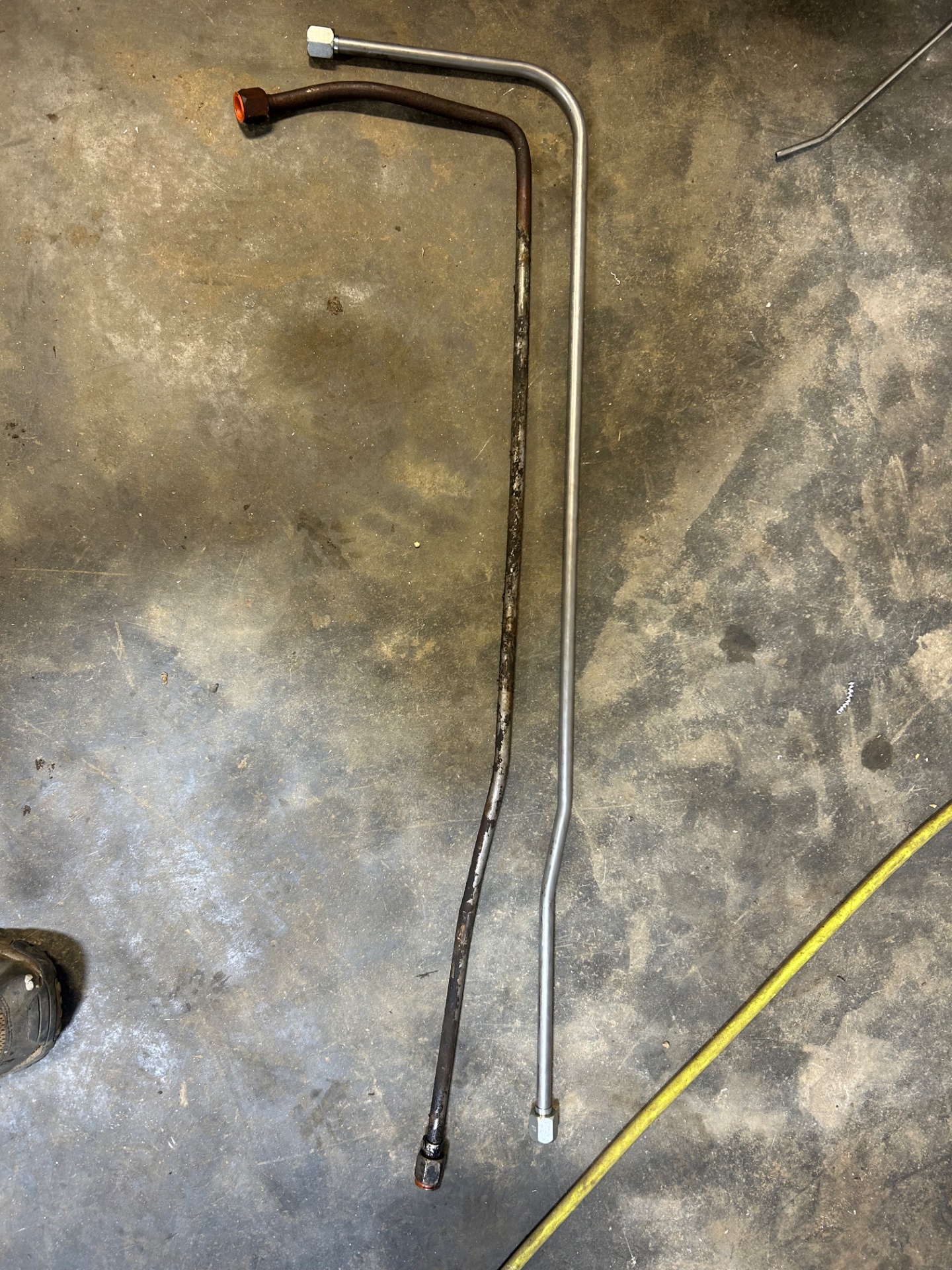

A lot of the hard lines for these machines are no longer available so I just make my own. I just finished rebuilding a 909 backhoe attachment and all but 2 of the hardlines needed replacing. I bought a tubing bender and a flaring tool, some tubing, a handful of ferrules and B-nuts and started working. Made a few duds in the learning process but once I got the hang of it it went really well. The only problem, if you can call it that, is that the bender I bought doesn't bend in as tight a radius as the OEM tubes but so far that hasn't been an issue.
