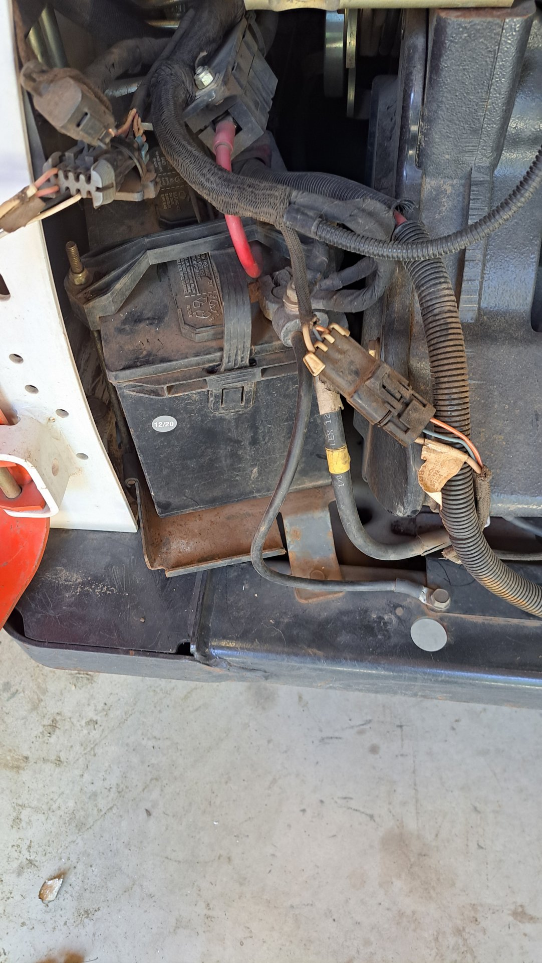

Could you take a picture of the battery.
20250602_104417.jpg The existing battery looks smaller than the tray. The guy I bought it from said he replaced the battery and the !warning light was something to do with replacement battery. It starts the machine fine but looks small judging by the tray. Thanks for your good help.............Jon
View attachment 8959 The existing battery looks smaller than the tray. The guy I bought it from said he replaced the battery and the !warning light was something to do with replacement battery. It starts the machine fine but looks small judging by the tray. Thanks for your good help.............Jon
The physical size of the battery doesn’t really matter. It’s the cold cranking amps (CCA) and the reserve capacity (RC).
First thing I would do is clean and check all of the battery connections and grounding points. Also look for any problems with the battery cables such as swelling under the insulation. You can also take the battery into an auto parts store and have it bench tested.
The physical size of the battery doesn't really matter. It's the cold cranking amps (CCA) and the reserve capacity (RC).

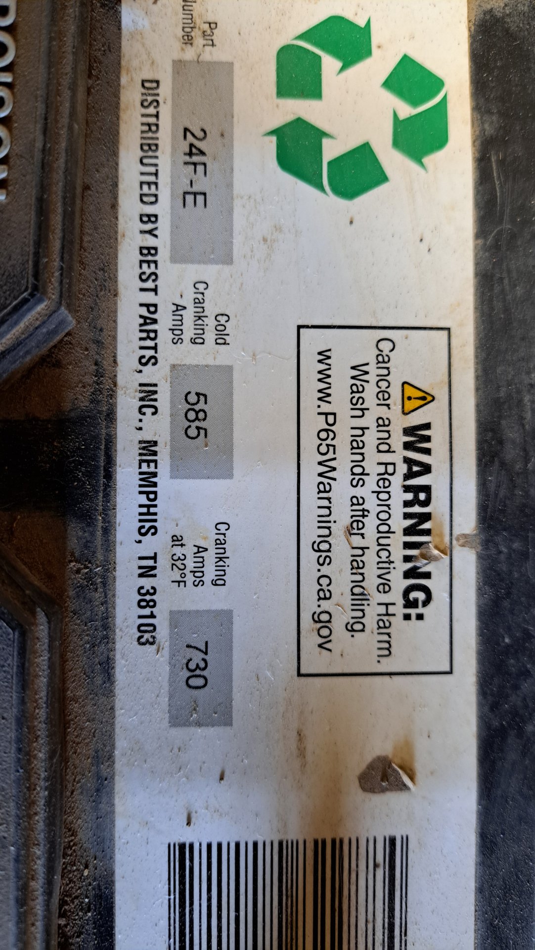

Correct, even a battery which cranks the machine does not mean that the battery is good.
I would at least go for a 850 CCA and up battery, yours look like a 600 CCA battery and these starter pull a lot of juice out of these batteries.
After that, how @brdgbldr said, clean all connections and specially the terminals and the cables.
the battery is short on the cold cranking amps. I got time today to clean up terminal and check the battery info like the previous post suggested. So far so good the machine has not triggered any codes. Time will tell with more seat time on machine. Thanks for all the good advice.
The machine will trigger the same code when you start it usually when you don't let the glow plug complete and try starting it when it is on. That makes sense it is pulling for the glow plugs and trying to start at the same time. The battery is a little light on the CCA so the system registers the code. Not a big deal but I will put a bigger battery in it when that one is ready to be replaced. Thanks for the good advice.
It is cold in the northeast and went to start it at 28 degf and the glow plugs ran for 12 seconds and when i tried to start it I got the click click and had to start it with the jump box. Time for new battery - the bobcat parts diagram shows two- one that is WET #7269857 and the DRY #6665427(old)/#7312553. it has a smaller battery that is 5 1/2 years old and time to replace it. From the battery tray it had a "DRY" "If Equipped" style battery. what size is this battery? Size 31 with bonded plates and 1000CCA. Does the DRY mean it is an AGM battery option or was this standard? thanks for the help.
