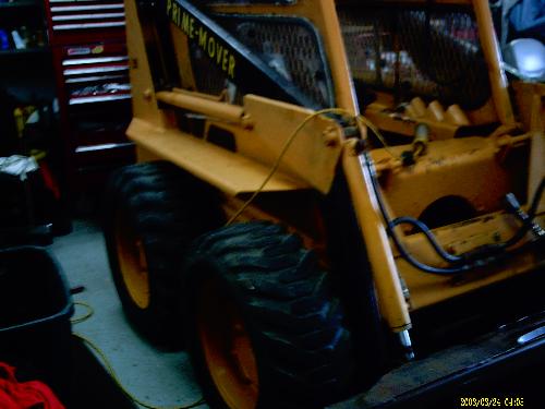

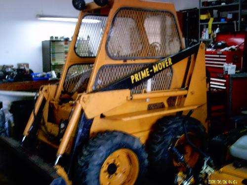

I don't how? I try to drag and drop. Just don't seem to work.Never heard of them, do you happen to have any pictures?
If you can't get it to work, e-mail them to me and I'll post them for you. My e-mail address is in my profile, just ckick my nick and it shuld show up.I don't how? I try to drag and drop. Just don't seem to work.
Thanks, Since I've gott'in it. I found that the company was bought out. I've found a place who still sales parts. The machine is very generic. And what I havn't found I can fabricate. It's a pretty simple machine. So thanks for answering. So far so good. Thanks ,TomI have seen the odd one around on the net, but know little of them. Not sure if they are out of business, bought up by?? or what
