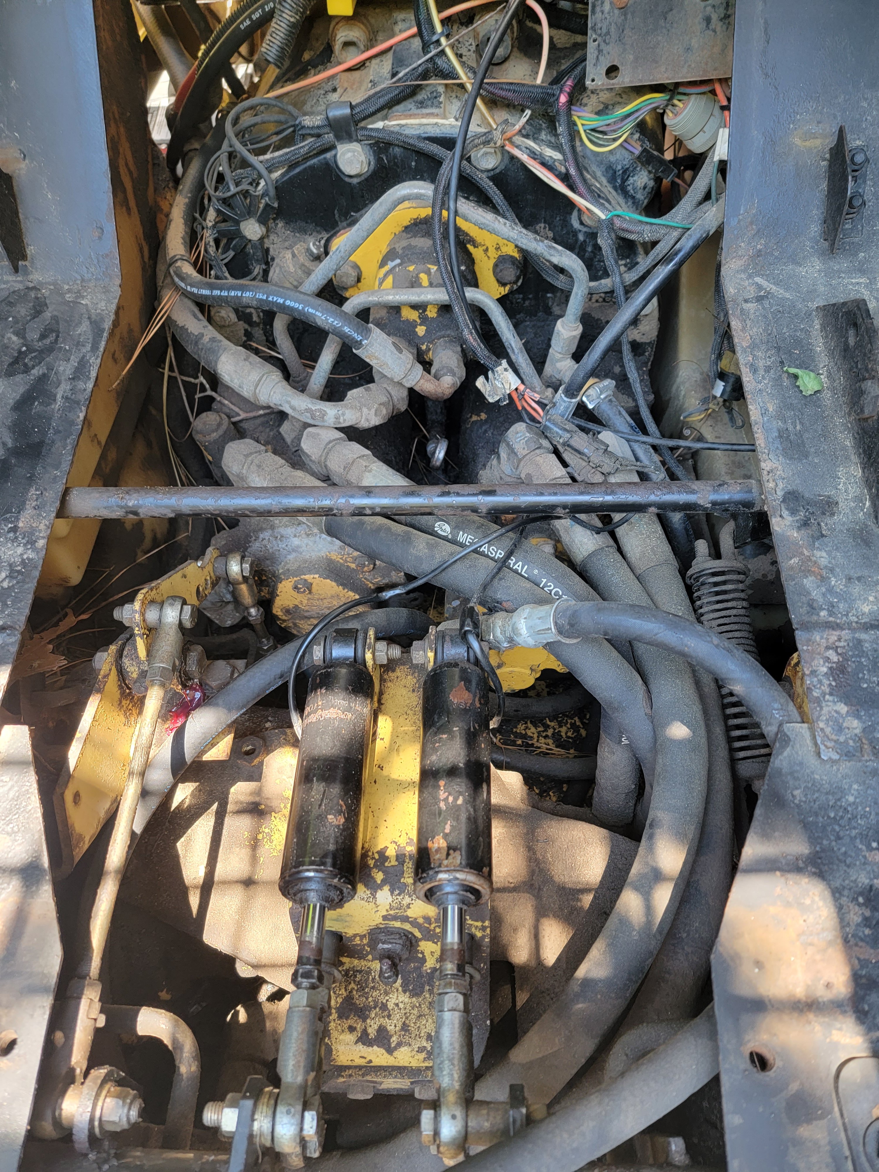

Hey guys. I'm new to the forum and new to this machine. It is a 1999 new holland lx865 with 2600 hours. I bought it yesterday and I'm starting to thank maybe i got the shaft. I got it home yesterday and ran it for about 2 hours and noticed a bad leak coming from under the machine. It's Definitely hydrolic fluid. I dropped belly pan amd inspected underneath with then engine running but everything is covered under there and I can't pin point leak location. Any help is much appreciated.. I have videos but don't know how to post

See all those rubber hoses on top of your hyrostats. Check each one onthe bottom side for leaks where they rub any metal. If you have another that goes from the top of thehydro back into the engine compartment check that one rall good. I had to rplace that line on mine as it ws rubbingand wore a hole thru it
the one hose is rubbing thru its protective coating in two spots and then the one its rubbing is also wearing thru
on the left hand side drive level, is a known wear spot too, but you cannot see from this picture,
but when you push the left side drive handle forward to go forward, it rubs the hose and in time will also wear thru there, it was a poor design of running the hoses on this model!
but I don;t think your hoses where there rubbing are where your leak is at, there would be a lot more oil all over the area
like I said, best advice is clean well, remove all skid plates, wash and dry, and run and little and find the leaking
and fix
them hoses will need to be addressed in the near future as well, , so if your leak is in a spot that need the cab flipped, might as well change them while at it , as that isn;t a fun job to do on this machine!
also, if when you do replace them two hoses, have them make the one an inch or so longer , its what I did and it now allows for them hoses to not rub like they did before!

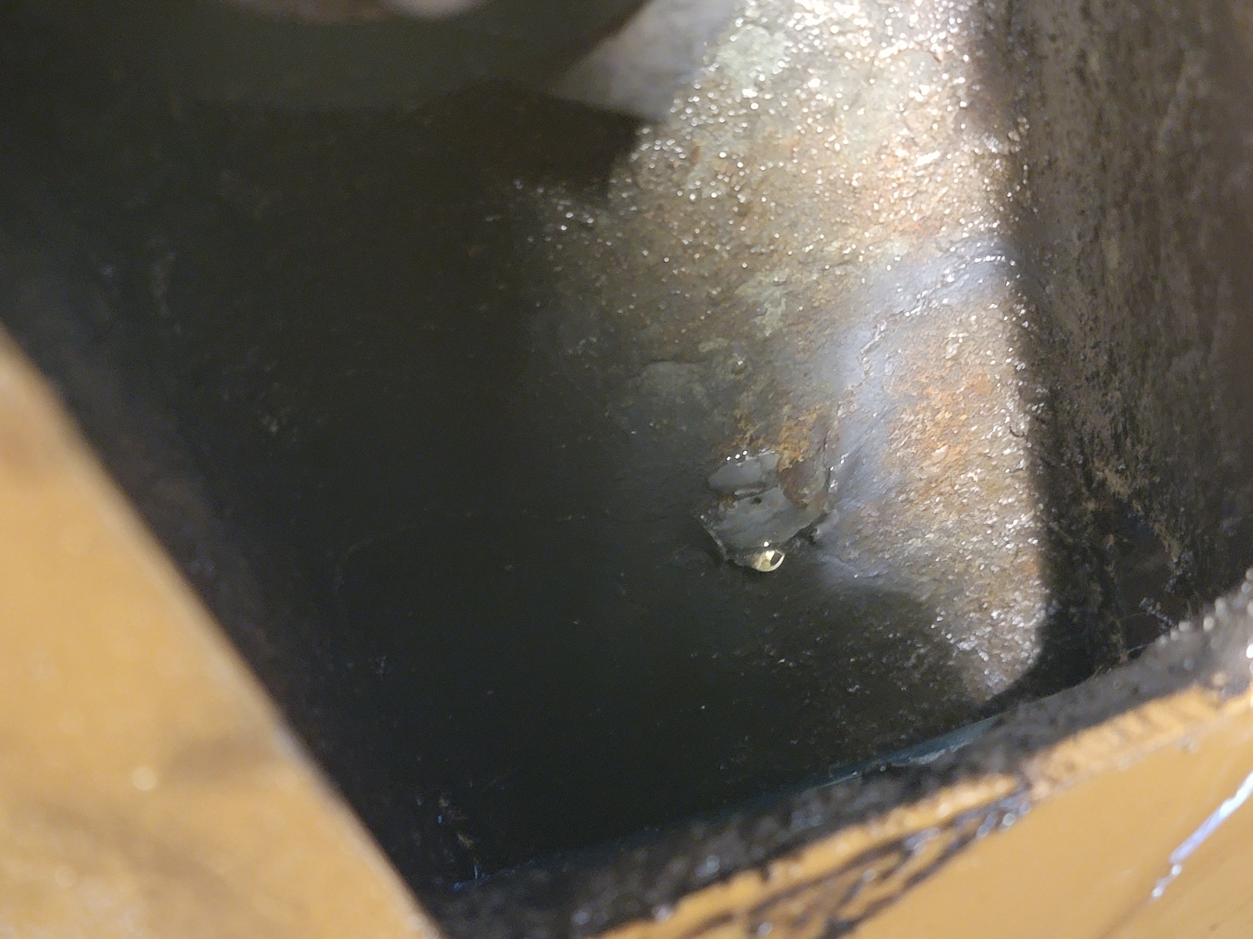

So I dug in some more today pulling the 2 return lines as the are the ones that rub into the metal on the frame. I'm going to have new ones made since they are off. But it seems that it's leaking still even tho I haven't ran it in 2 weeks. The hydrolic Reservoir was almost empty and I put 2 gallons in it before I parked it.
like I said, it could be the hose on the bottom of the tank, that's what started leaking on mine, the hose got old and just age caused it to start leaking

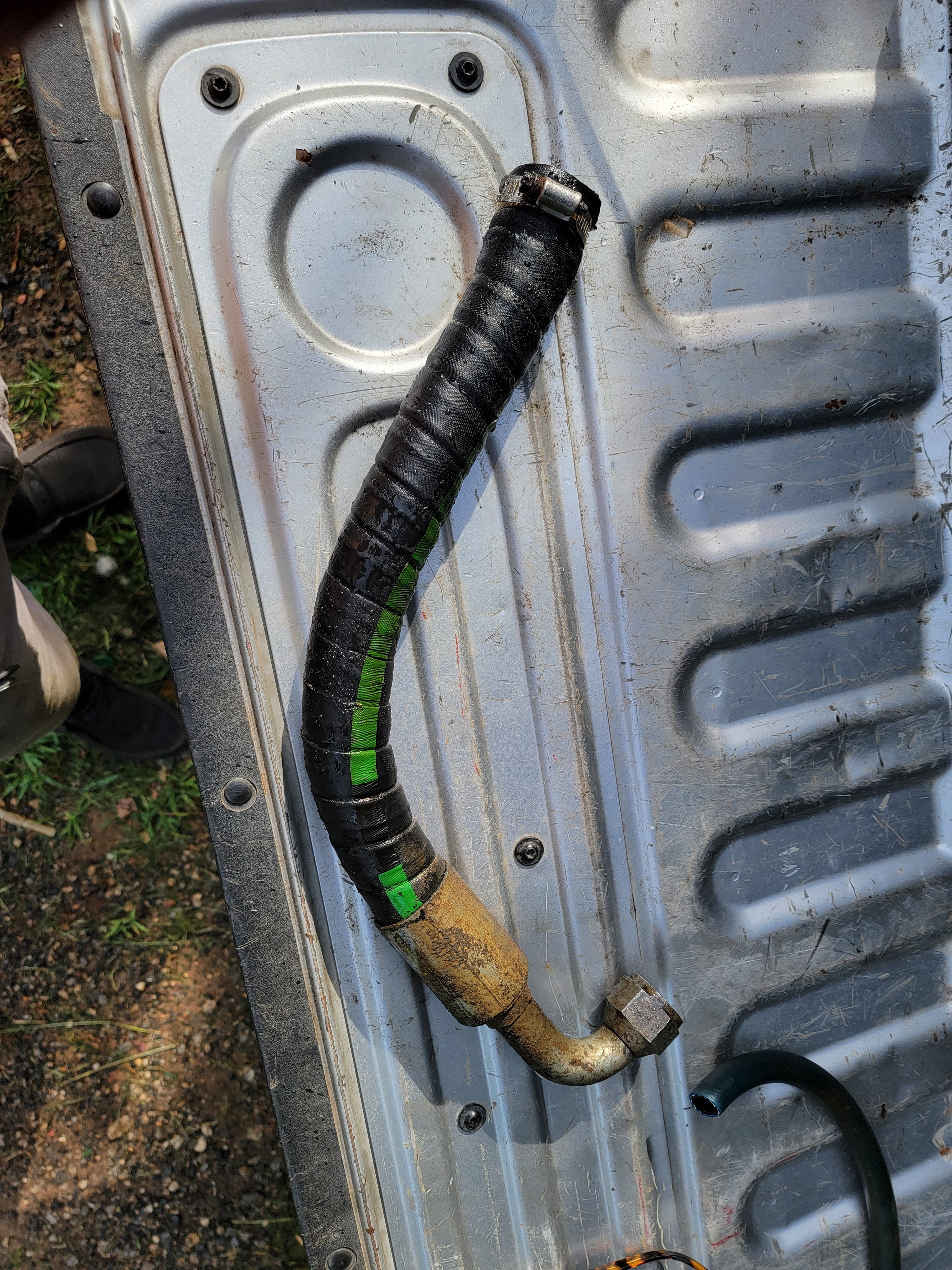

Ok guys.! I finally got it off! Someone suggested I can get the hose from the hydro tank to the pump at the hardware store but this is a pressed fitting. I'm a little confused
Ok guys.! I finally got it off! Someone suggested I can get the hose from the hydro tank to the pump at the hardware store but this is a pressed fitting. I'm a little confused That top fitting will come out of the hose. Iyt is held in place by that clamp. Take it to a hyd shop and they should be able to make one. Just hold on to your rear after you hear the price. You might walk out a little funny and have a much lighter wallet. If that is the inley hose to your pump tell them as that is a suction line i should have wire in it like ahyd line does
